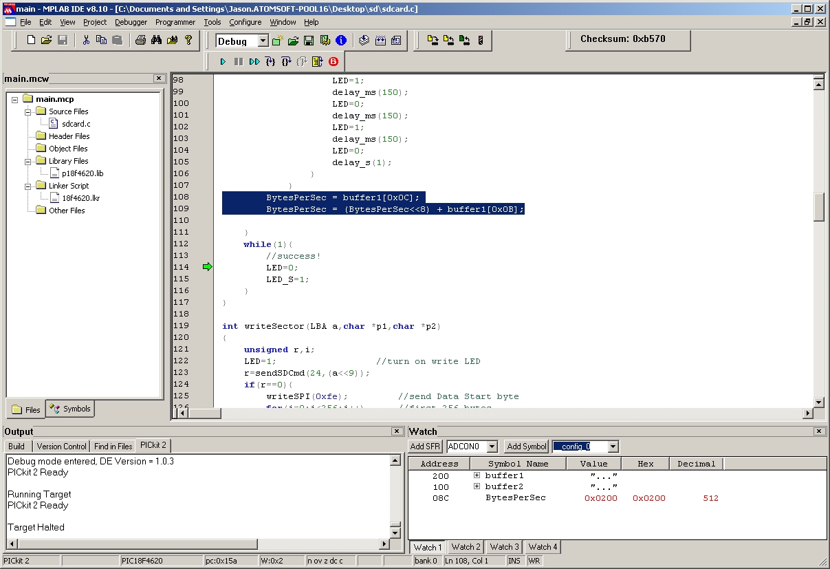

Here is a snapshot of me getting the Bytes per sector using:
int BytesPerSec;
 //and in filling it i do :
        BytesPerSec = buffer1[0x0C];
        BytesPerSec = (BytesPerSec<<8) + buffer1[0x0B];
I used "int" because its a word (2 byte) I decided to use variable to store the info because if i do another read i loose that info.
But im stilling having issues with memory. How come i have to use:
#pragma udata BytesPerSec
int BytesPerSec;
This is starting to bug me.

Dude! I got to make a 512 Byte Variable. Its a matter of altering the linker and that pragma. Open up the hlpC18up.chm (the user guide)
GOTO "Examples"
GOTO "Application: Creating Large Data Objects and the USART"
You will learn it there. It was so simple lol I call i simple because if i can do it anyone can lol
