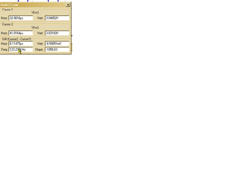

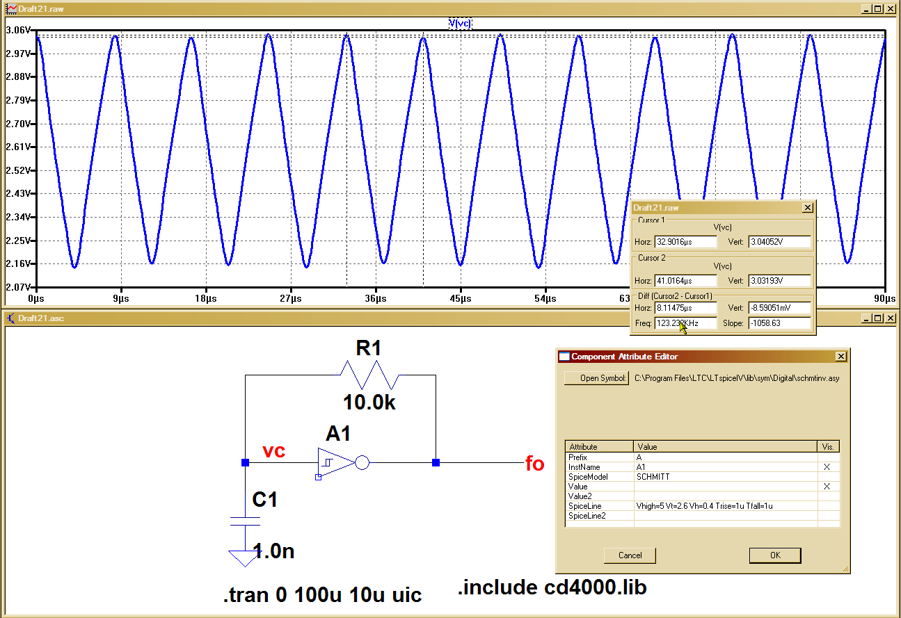

Interestingly is the difference between the observed frequency from the LTS plot of ~141kHz and the ~76kHz from your formula, which is more accurate than the 83kHz derived from the 1/[1.2*RC].
To get a 141kHz from your formula I had to set the vL=1.9v vH=3.5v and Vss=4.8v
[of course there other combinations that give the 141kHz]
Its appears that LTS is using different vL, vH and Vss from its plotted values of Vc.????
Strange.
Hi there Eric and Irjaj,
Eric:
Thanks for looking at this. I checked the formula but i didnt do like 100 problems with it yet :)
Anyway, from your previous post i can see that the model you are using has characteristics such that vL=2.1 and vH=2.9. This of course means we need to plug those two values into the formula to get it to work correctly. I took the time to derive the formula using vL and vH so that people that wanted to use this kind of oscillator could investigate the oscillator properties with variations in either vL or vH or both, either randomly or systematically.
If we do plug in those two values and use Vcc=4.8 instead of 5.0, with a 10k resistor and 1nf capacitor we come out with a calculation of 148330Hz, which is pretty close to the observed frequency using LT Spice according to your simulation. We could investigate and tweek the formula a bit i guess.
I would suggest that anyone trying to use this oscillator to simply ignore the formula 1/(1.2*R*C). I think that formula is a spinoff of an oscillator with thresholds of 1/3 Vcc and 2/3 Vcc, which comes out to a neat 1/(1.386*R*C) (and as a side note this can be derived from the formula i gave previously). In other words, we have no guarantee that we'll see 1/3 and 2/3 Vcc thresholds so we cant rely on that simpler formula. As we can see by comparison the simple formula fails completely in many cases.

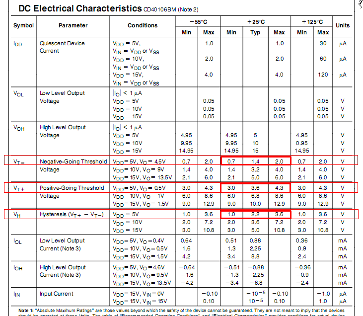

hi Al,
Checking thru d/s for the CD40106 it can be seen that the spread in the vH, vH and hysteresis is large.
I have found in the past that trying to use a fixed value resistor, expecting to find the calculated frequency is not going to happen.:)
A fixed and variable resistor is required to get close to the desired frequency.

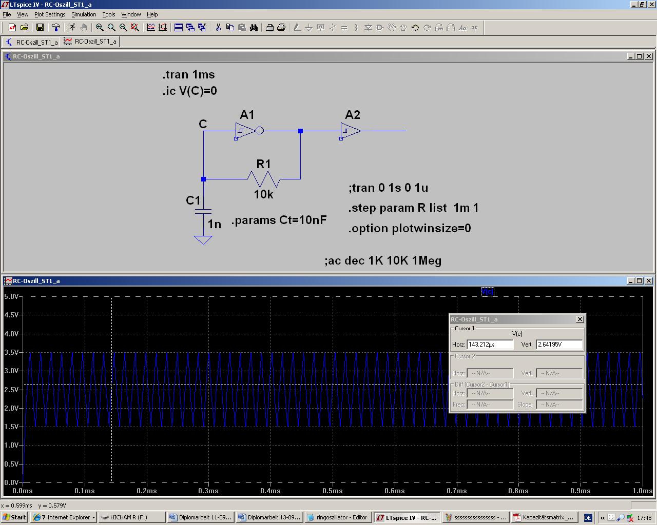

I Set the LTS model as shown in this image.
BTW the vH = is the sum of the two entered values and vL is the difference.
Frequency is lower than expected, but within the parameters spread.

can you plaese tell me how you get the lower threshold to 1.2 -.4 = .8V, and the upper threshold to 1.2 + .4 = 1.6V
Look at the LTSpice Help for the Digital components. Vt sets a threshold value and Vh sets a hysteresis value. The Schmitt upper threshold = Vt+Vh and the lower threshold = Vt-Vh.

Hi Eric,
Yes, the threshold point spread is pretty large and that is what i have been trying to get across. By posting the formula, i had hoped that people would use it to calculate their frequency spread based on the data sheet spread. That is, we can look at the data sheet and do a few calculations and then know that if we buy a one piece order of that chip we might get a frequency F1, but if we buy a two piece order we might get frequency F1 from one chip and frequency F2 from another chip. We cant nail it down perfectly, but doing this kind of calculation will show us how much variation we might expect from these chips in this kind of circuit.

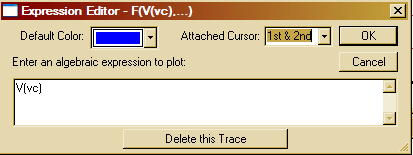

hi eric,
can you please tell me, what can i do to get this??
It is just to show the frequency of the plot when using the LTS Schmitt model with those threshold values.
Have you tried recalculate the frequency using Al's formula.???
i can t see the frequenz in LTspice like you??
You have to select '2 cursors' #1 and #2,,,, move #1 cursor to the peak of the wave and the #2 cursor to the next peak.
