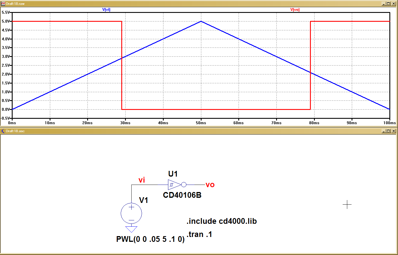

The CD4000.lib which is a download from the User Group has the CD40106 Schmitt inverter
Its set for the CD trigger thresholds and cannot be modified.

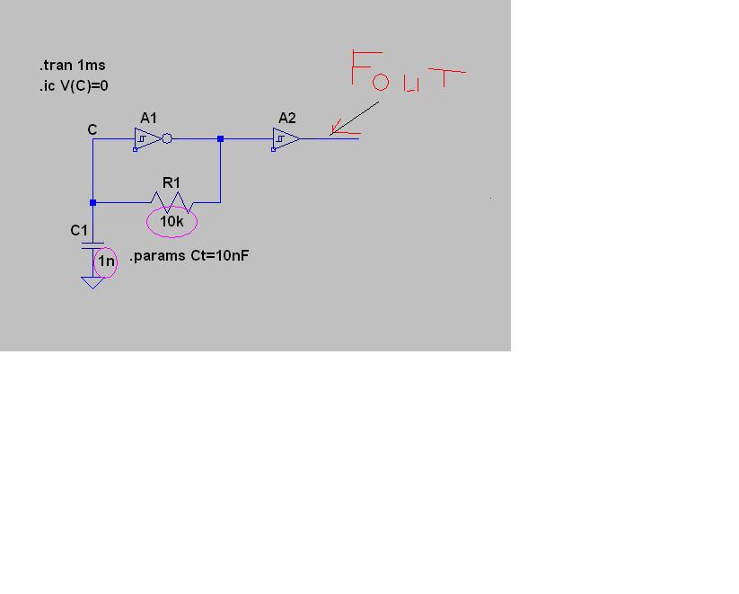

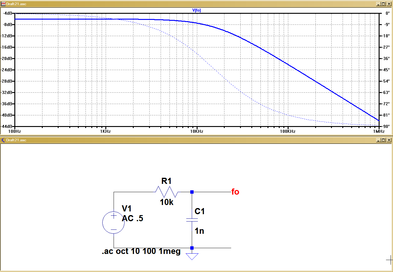

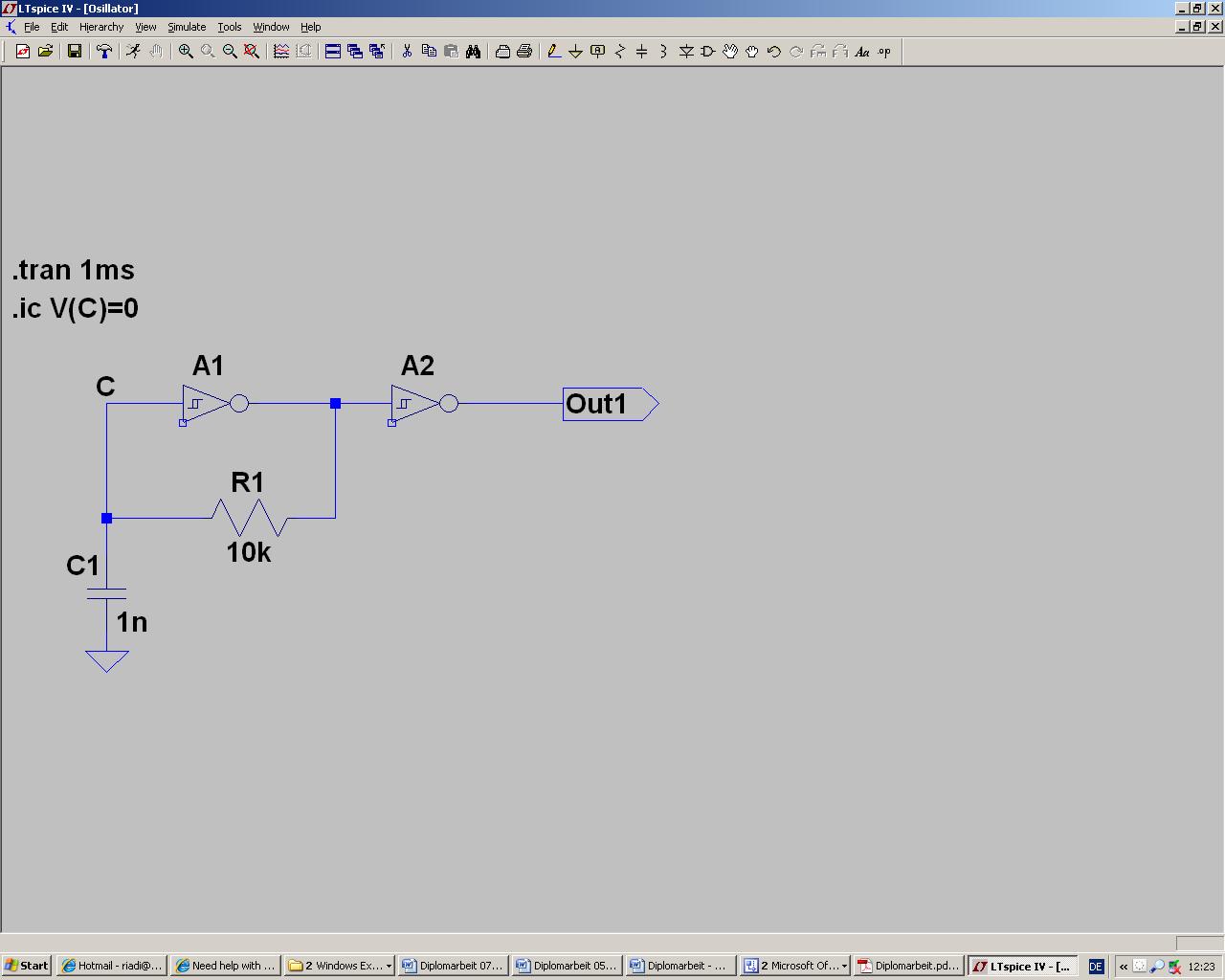

how can I be expected frequency when I opposed from a capacity of 1n and resistance 10kohm
Do you mean what is the corner frequency or the frequency of a Schmitt oscillator.?
The CMOS version of the Schmitt Trigger was not intended to be used as a precise frequency generator. It's main purpose is to clean up slow moving edges so slower changing signals can be used to clock other circuits more sensitive to edge rise and fall times.
If you look at a data sheet you'll see the lower and upper thresholds are all over the place, and that makes it a bad choice for a frequency generator that needs a stable repeatable (chip to chip) frequency. Hobby stuff might be ok but for precision stuff go with something else.

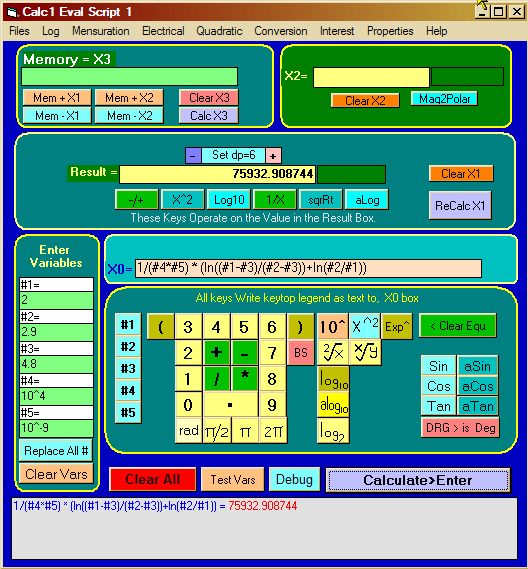

Here's a better formula for the frequency F:
tp=RC*(ln((vL-Vcc)/(vH-Vcc))+ln(vH/vL))
F=1/tp
vL is low threshod,
vH is high threshold.
Make Vcc slightly lower than power source voltage like 4.8 for a 5v power supply.

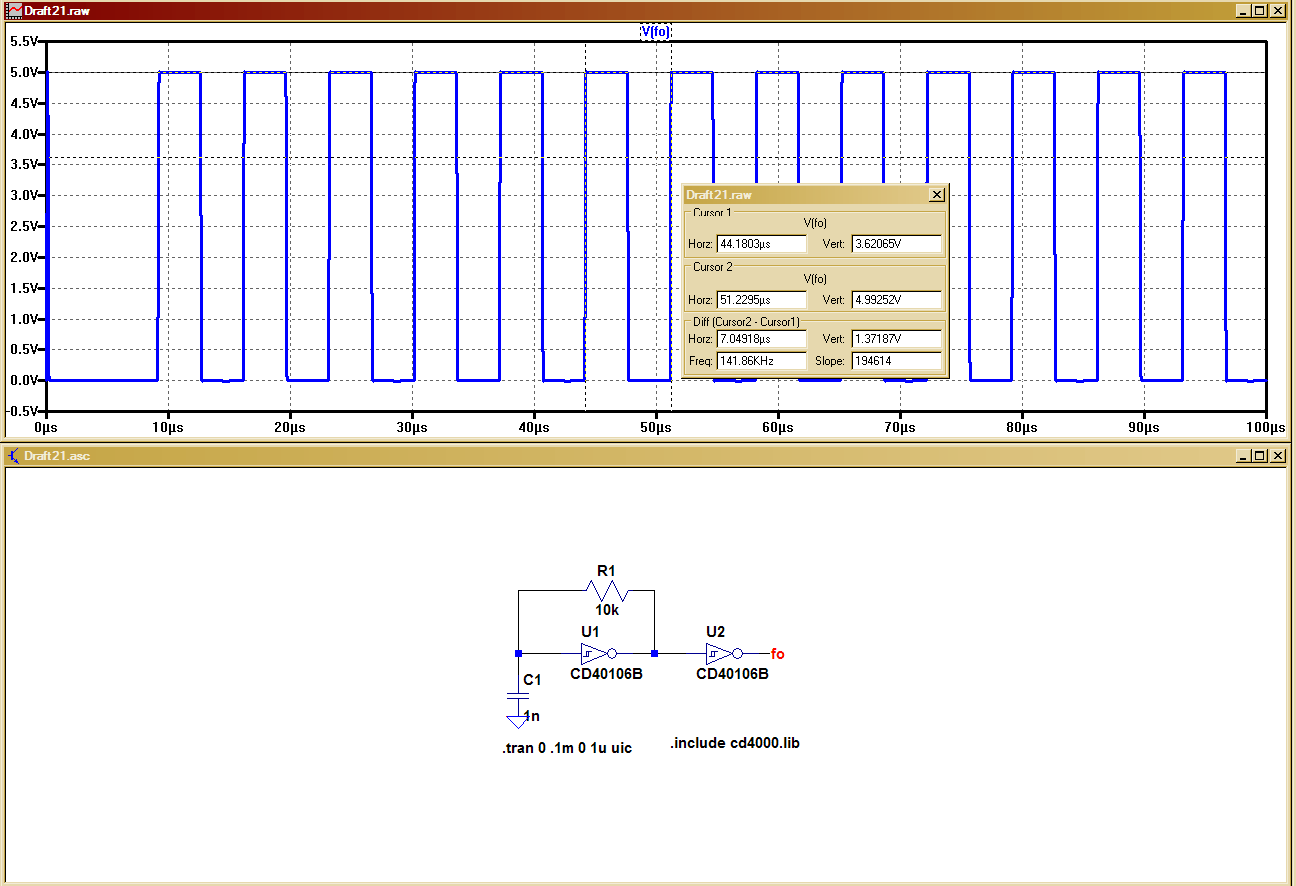

hi Al,
Interestingly is the difference between the observed frequency from the LTS plot of ~141kHz and the ~76kHz from your formula, which is more accurate than the 83kHz derived from the 1/[1.2*RC].
To get a 141kHz from your formula I had to set the vL=1.9v vH=3.5v and Vss=4.8v
[of course there other combinations that give the 141kHz]
Its appears that LTS is using different vL, vH and Vss from its plotted values of Vc.????
Strange.
