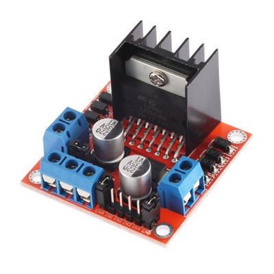

I am thinking of using a pot-controlled 555 astable running at 120Hz +- 20Hz, into a CMOS flip-flop to divide the frequency by two to get two symmetric 180deg-out-phase square waves at near 60Hz, driving the IN1,IN2 inputs of a L298 H-bridge driver like this:
driving a 120Vac to 12Vac@2A wall-wart transformer turned around to make it a step-up transformer. I have all the parts to knock this together.

Mike, do you need to convert the square wave to a sine wave, or something similar? I wonder of the sharp rise and fall time may saturate the reverse connected wall wart.
The wall wart will saturate if you drive it with a frequency lower than it was meant, still might work with a current limit resistor is series with it, the first pulse will move the motor.
The crystal controlled oscillator driving a small 120 to 12-0-12 transformer in reverse seems the best idea. You should keep the area under the voltage/time graph to be no more than it would be on a 120 V 60 Hz system, to avoid saturating the transformer or the synchronous motor.

I have bread-boarded the circuit I proposed back in post #1 and it is running fine. I'm running the frequency from about 50Hz to 70Hz, and the wall-wart tranny is not complaining. The output waveform is a squarewave at about 200Vpp. The circuit draws 0.6A at 12.6V, so a 8Ah SLA will run it all night.
