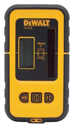

I have a small chain trencher, the kind that you would use to put in a sprinkler system. I would like to use it to put in drainage systems which require an accurate slope for the bottom of the trench. I can input a slope into a rotary level laser and I would like the depth to match. I am thinking of using a raspberry pi 4 for control, but I don't know what sensor I should use. I would like to use the same units in the readily available detectors like dewalt, johnson or leica.

If you mean a laser sensor then you could use an array of Ldr's.

The array of LDR's sounds perfect. Can you recommend a manufacturer, part or even an appropriate search term. I keep finding chips that are really expensive when a search on google.
