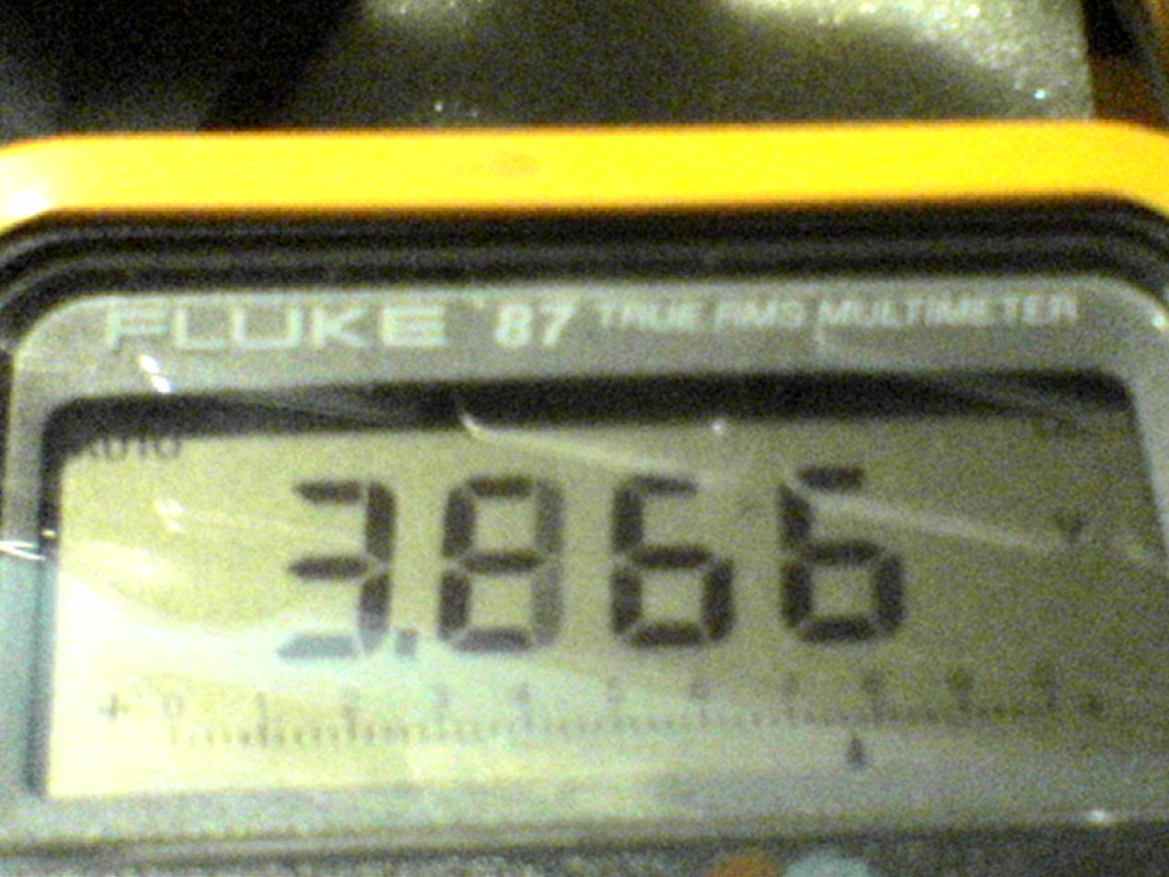

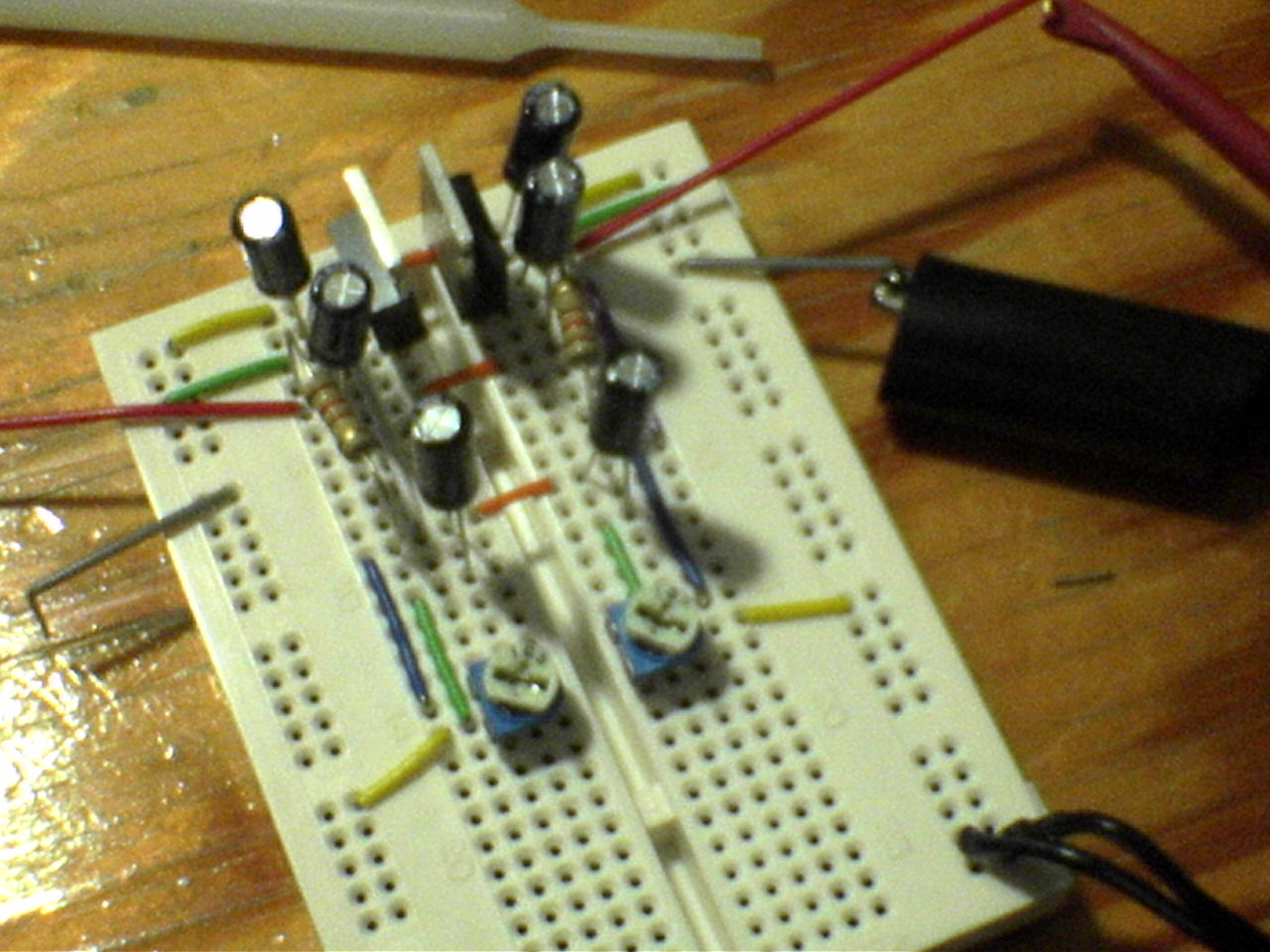

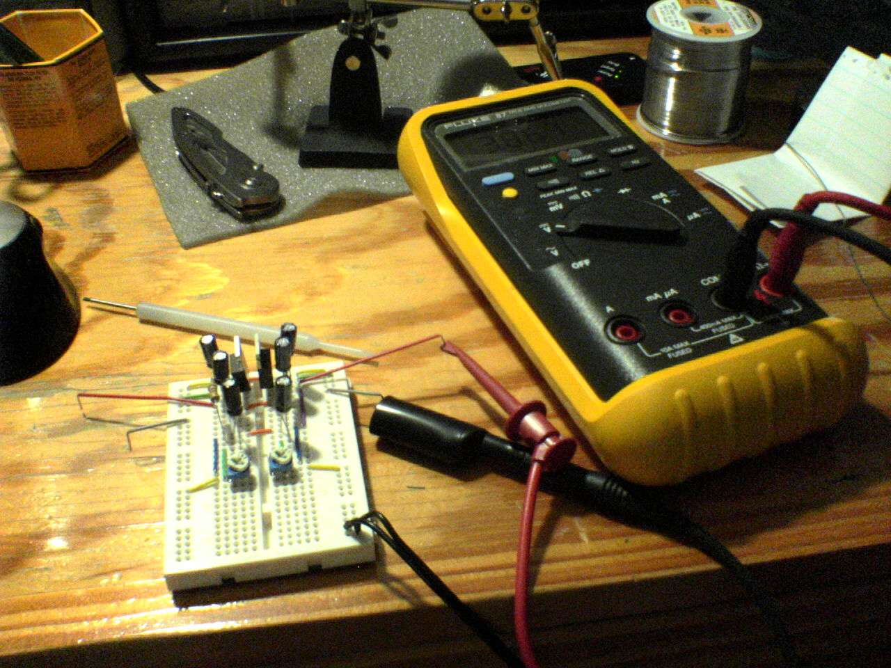

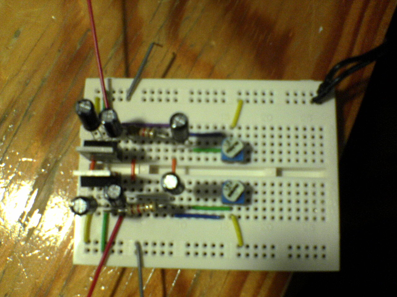

Well I did it... here is my dual power supply (positive and negative voltage source)
And you can see my handy dandy Fluke DMM :D
Edit: my circuit looks like the X-Wing from star-wars lol

Good going. I think you posted this in the wrong thread though. ;)

Even though it's a true RMS meter, make sure you keep within it's frequency range. A switch mode supply could easily distort the RMS reading out of specs if the switching frequency isn't within the meters range. This is especially true of square waves as a decent amount of the voltage/current the device is carrying could be outside the frequency range the meter is sensitive to. A square wave with a rise time of 1us has a frequency maximum of 1mhz even if the square waves frequency is only 1khz.
lol not really sure what you said here. Can I damage my DMM if I go outside it's frequency range? I don't think I can but just want to make sure since what you posted is way beyond my level of understanding at this point :)

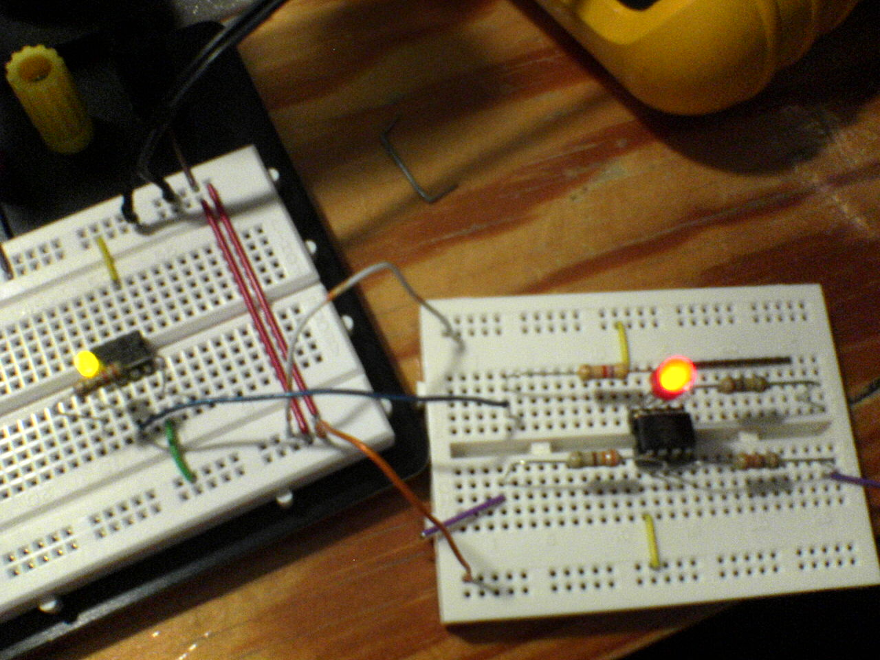

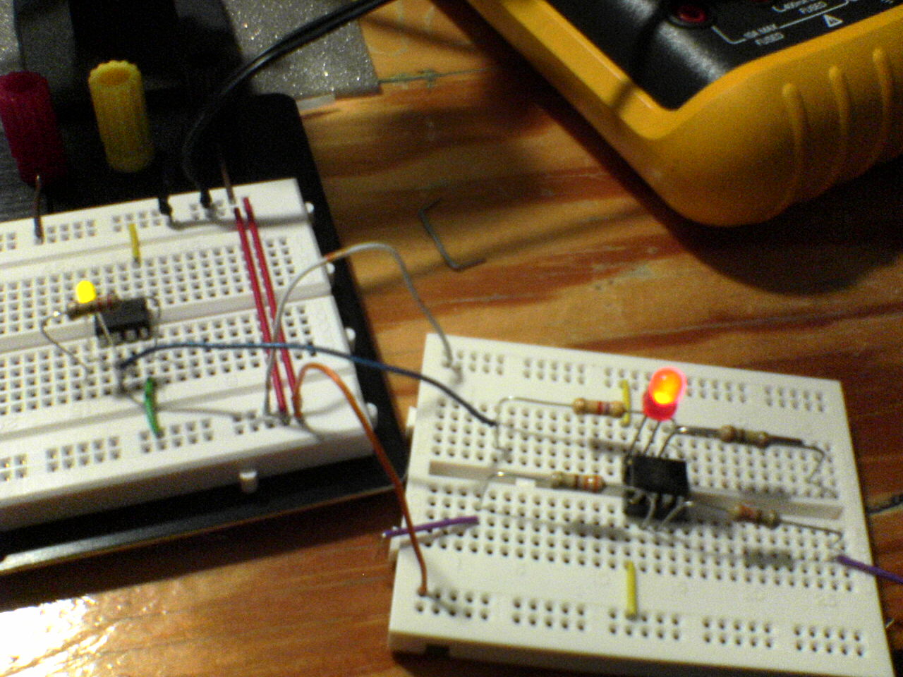

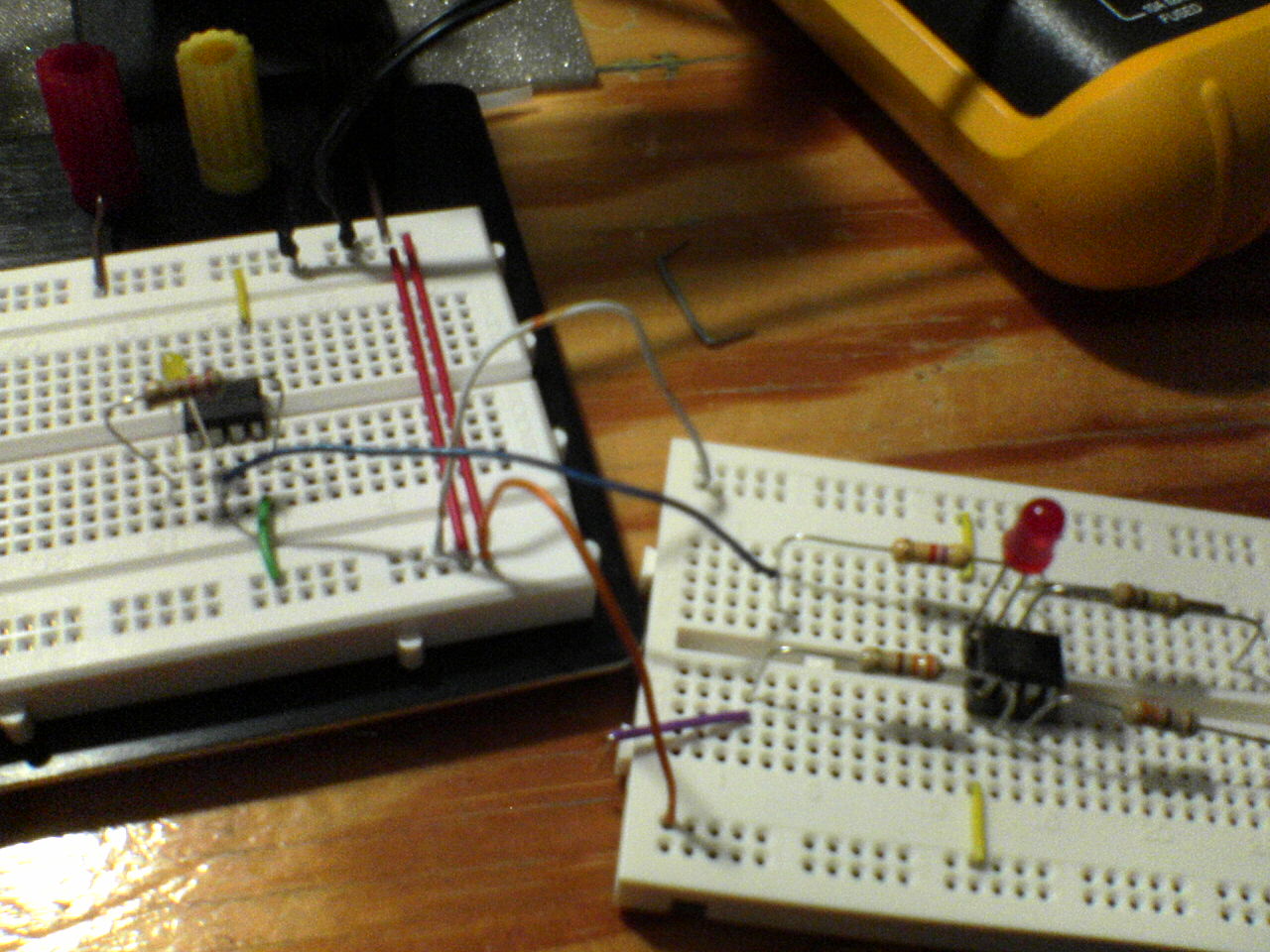

And here is my logic probe (the small breadboard on the right with the red LED).
On the left is the PIC12F509 that I programmed to blink the yellow LED and on the right is Morgan's Logic Probe. As you can see, the logic probe's red LED flashes at the same rate as the yellow.
Now that I know it works... it is time to commit it to a permanent board :)

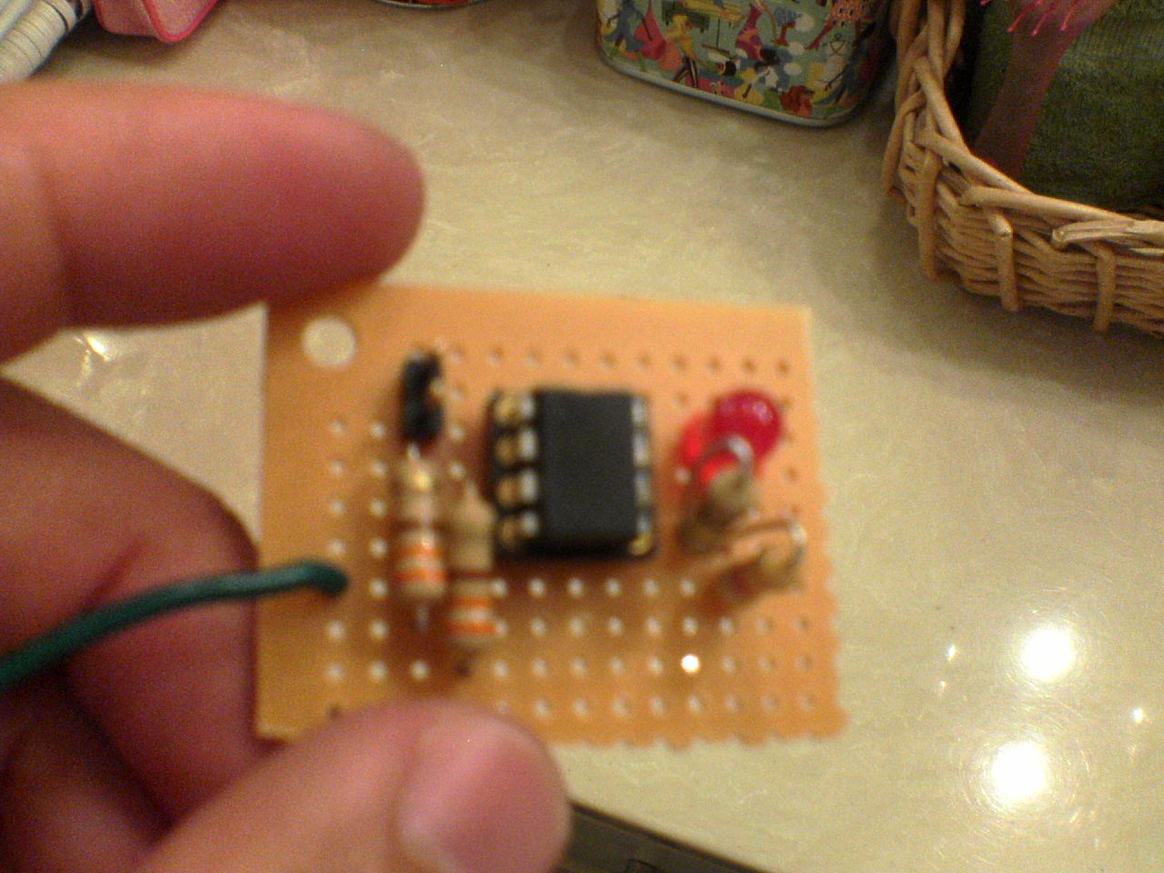

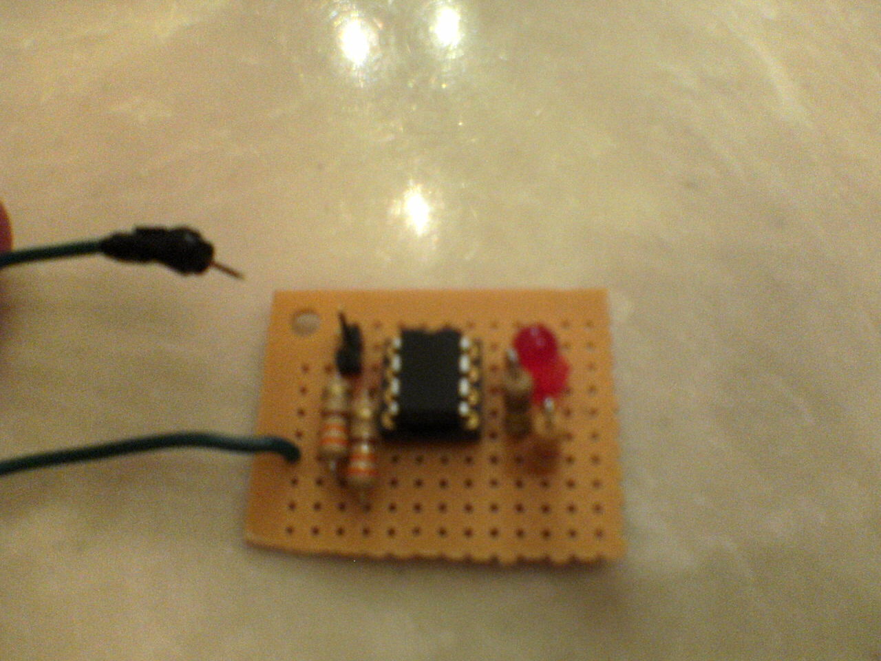

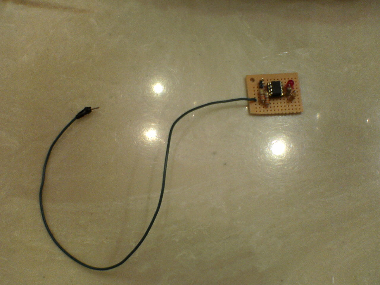

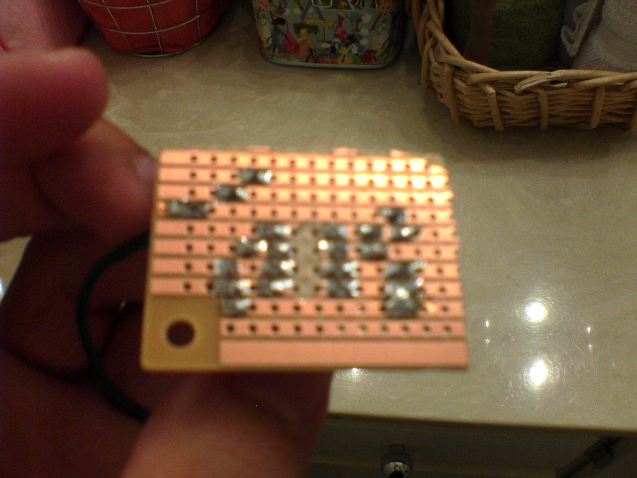

:: Drum Roll ::
TA-DA! My first permanent circuit! This is the Morgan Logic probe and I soldered it onto a stripboard. It has a green wire with a pin header (male) as the probe. The board has two male pin headers for ground and 5V. You can see in one of the pics the soldering work and the cut copper traces. :)
