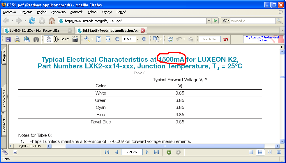

A heatsinked luxeon can pass up to 1500mA.You would need hell lot of 10mm to achive that kind of power.And yes you wouldnt need a heatsink becuse the surcae area of the plastic cases and the coper wires would be so big to act as a heatsink.
But the Luxeons dosent realy need a all that huge heatsink.meaby if you run them on some old CPU heatsinks whithout the fan.
I agree that is a lot of power. Those LED's disipate 1W or so. Don't believe every thing told by the manufacturer. 1.5A at 2.8V+ .....come on. Works if u have a very good cooling sistem and a duty cicle of what...5%?

They are optimistic.
At 105C the leds wont last for long:D
The luxeon are simply great things (don't get me wrong) but have their limits.
Well the K2 can.They produce 100 Lumens of light.

Good point Blueteeth. I was just pointing that 1 luxeon can give as much light as 5-6 10mm (10mm!!!!!!!:mad: ) LEDs. I can buy those at @.20$ or less/piece at higher qt (25+ or so). Also I can PWM drive those at 50-55mA and 50% Duty Cicle whithout any problem ..any!!!!!. A luxeon K2 can be driven at 1,5A for a v short period with good heat sinking (the 5mm LED flash is a good example). U can cont use the luxeon at 300-350mA tops with a bit too much heat.
The link given by Blueteeth is a perf example about puting togheder lots of leds. Those 5-6 10mm LEDs will be cheaper, more reliable, less hot!! and whithout any heatsinking will ocupy same space.
Of course Philips wil point out peak values (duuhhh) like any company...is a psichological impact (1,5A for a LED!!...Damn ..is cooooool:eek: ). The 1.5A isn't a lie ..technicaly speaking:D .

No 1500mA is continues curent.Luxeons dont realy like high curent pulsing but pusling wont help when you need to light a room.Also you will only be pulsing it lower then the max continues curent becuse you are not pulsing it in PWM for the purpuse ot gte more curent trough but for the purpuse to lower the power output.
