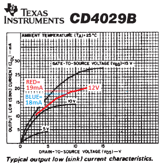

The datasheet for the4029 shows only approx 2mA at a 12V supply.
I do not know where you found such low output current.
Texas Instruments shows graphs for the output current of all of their Cmos logic ICs. With a 12V supply, one output can drive a red LED with typically 19mA and can drive a blue one with 18mA. The minimum output current is half these currents.
The current-limiting resistor values can be low enough so that the LEDs are bright but the IC does not get too hot.
EDIT: I see that if the LED has a forward voltage of 11.5V (but it doesn't) then the current into it is very low.
