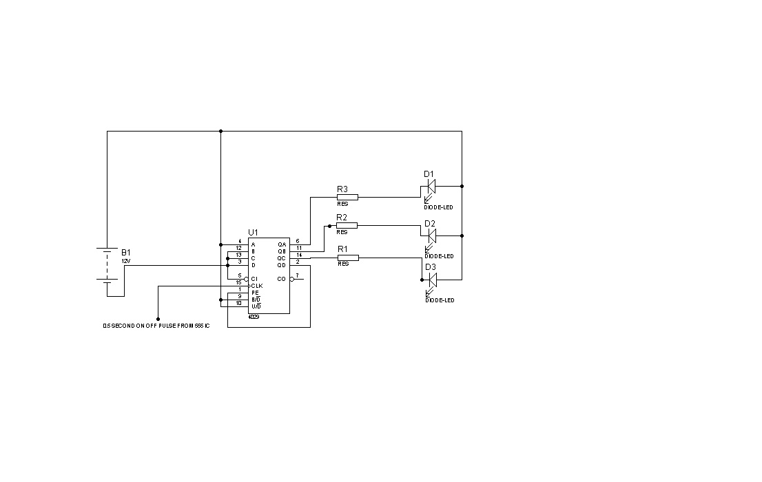

I Have attached a diagram of an RGB controller I am trying to build.
When I apply power the green and Blue LED in the tri colour LED seem to glow but nothing happens.
I am cncerned about my transistor switching on the LED from the CD4029 orginally the circuit required a common Cathode LED but I could not find any so adjusted the circuit as I thought correct.
I have found the 4029 gets warm not HOT and nothing happens.
are the transistors switch the LED's correct ?
How can I build a simple circuit to switch a single led, from the 4029 this would enable me to check if the IC is faulty.
Many thanks

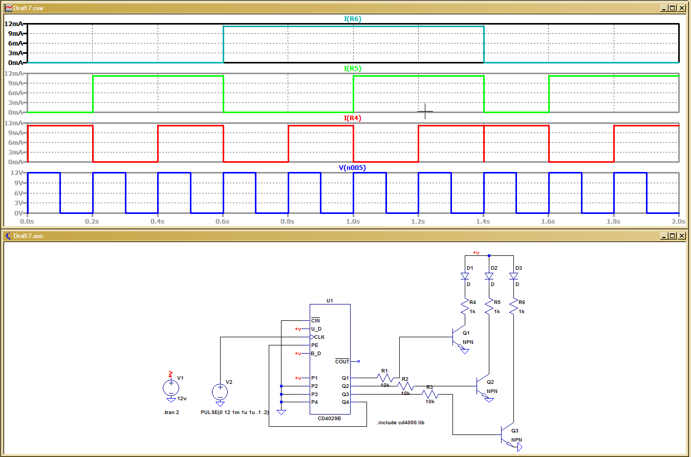

Pin #5 is an Input, as are 12,13, 3 , so they are open circuit 'floating' ,, connect them to 0V.
EDIT:
Added a simulation for you. Shortened the 1sec rate for SIM ONLY.

Thanks for the advice! before I try this, is it possible for me to drive the LED directly from the output of the 4029 just for testing purposes.
Once I have it working then I can add the Transistors to the output, this will enable me to drive several LED's at once. The Purpose of the Capacitor on the base is to produce a fading effect so I can get diffarent colours from the Tri Colour LED.

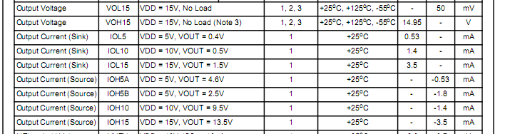

What are the details of the LED's. ie: current rating.??
The datasheet for the4029 shows only approx 2mA at a 12V supply.
The capacitors will only delay the transistor switching on. Once the capacitor reaches 0.7V the transistor will turn on. I assume this is why Eric left them off his diagram.
Just wire the 10 k resistors straight to the cathodes of the LED. This will provide a usable indication although it will be inverted from what the transistors will show.

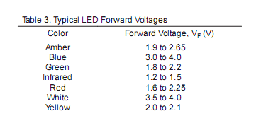

Blue LEDs tend to have a forward voltage of around 3V and so need a smaller resistor. If you post a link to the data sheet then someone will work out how to calculate the value.
Thank you. I dont have a data sheet bought from our local supplier and can guarantee its the cheapest one from china Like everything in Zimbabwe
Use a 470 ohm resistor from +12V to the Blue LED Anode and the Cathode to 0V, to TEST the Blue LED.
