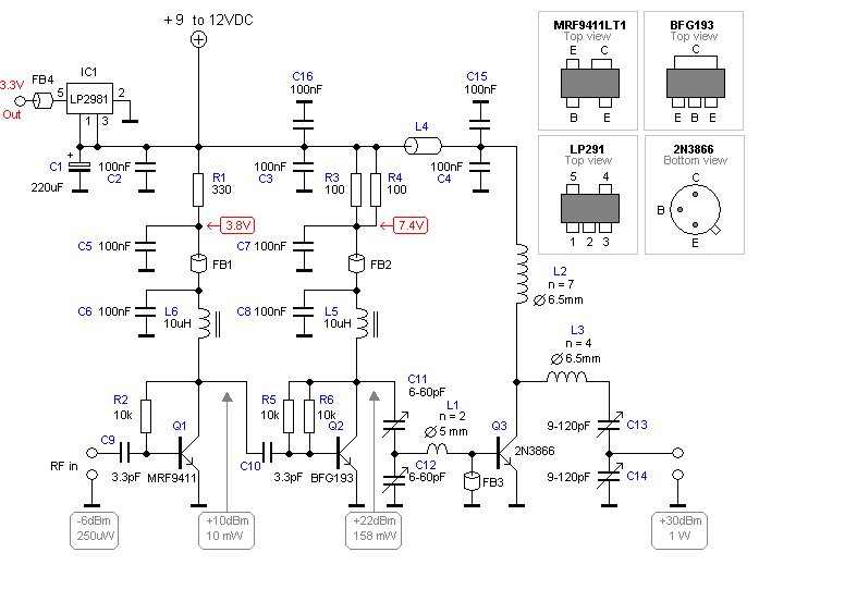

Hi Whiz,
Your circuit is missing a very important supply bypass capacitor.
1) (repeat of ag) Battery should be bypassed.
2) R1 is good for HFE at minimum, but what is the bias point for HFE at maximum? With no max HFE specified for BF199, I would use a bypassed emitter resistor and a fixed base bias point, but that's just me. Do you intend class A or B?
3) With a little calculation, you should be able to determine a fixed value for C3. What do you expect will be your nominal setting for C4?
4) There is no base bias on U2. It won't ever conduct.
5) R3 should be bypassed unless you really want it to soak up your RF and lower your output Q.
6) What are the values and characteristics of L2 and L3?
7) I would like to see the typical reactance (R, +j, -j) that you expect, at the operating frequency, in the output pi filter so I don't have to re-do your math. You did do the math,, correct?
Where is the original RF amplifier project that Whiz copied wrong?
It has the capacitive voltage divider and has the 2N3866 biased in class-C without any bias voltage.
You don't need a bias voltage on the 2N3866, but you do need a return path for the base current, especially in class C. The base itself only conducts one way.
the one in post 2 looks like this...... the transistor is running class C, but with the filtering shown, the output signal must be rich in harmonics....

Hi Whiz,
i'll add it later when i'm going to update my schematic, thanks!
the BF199 on my circuit works on class A since my design is theoritical and i haven't checked the hFE of the transistor i believe this is a good way to go.
i don't know what i should expect for that i still haven't understood the concept behind it...i only know it forms a capacitive voltage devider and you can regulate the impedance so you don't drain the previous stage..
are you willing to help me understand it? and also do the maths for a fixed value?!
my coil filters out the signal right? i didn't noticed that too... since i had in mind to make the impedance match circuit between stages.
i thought only preamplifing stages need that much decoupling so i'm
only using a choke...
it's
2 1/2 Turns
Impedance: 50 MHz • 800ohm
Impedance: 100 MHz • 550ohm
check the photo...
haha! now you got me... :D it's not that well calculated since i had a bit of a problem with the link barcbarker gave in past pages... it says 500MHz and i don't know how to remove that value so i can calculate mine.
