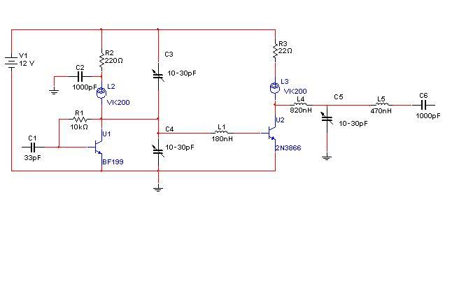

update...
so here's my design... kchriste's link helped alot!
That's a but harsh Nigel, go easy on the nube!
C4 and C3 are effectively in parallel with each other giving you 20pF to 60pF; are you aware of that?
Have you tried simulating it?
using the caps and the coil i'm trying to fix the impedance between stages..
i haven't simulated it never managed to do a decent simulation on multisim...usually i do the circuit and then connect the instrument and i don't get any reading...
also on LTspice many components are missing.. so i couldn't simulate it...
what's wrong with my circuit?
