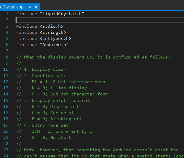

i would like to reuse library for 1602 display in non-arduino project.

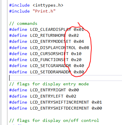

My first question is what are those hex values written after defining function in library file .h?
So far i need only to change lines which are using command from Arduino.h library am i right?
Its better to use already writed library but this is just for learning purpose.
#define Places an identifier instead of the binary command... ie.. Send 0x1 to the display and it clears the display and sets the cursor to home.
Then instead of remembering the code in binary.
LCD_COMMAND(0x01);
you can use English ( or whatever you like )
LCD_COMMAND(LCD_CLEARDISPLAY); make it more readable..

Thanks i forgot that. Now i remember.
