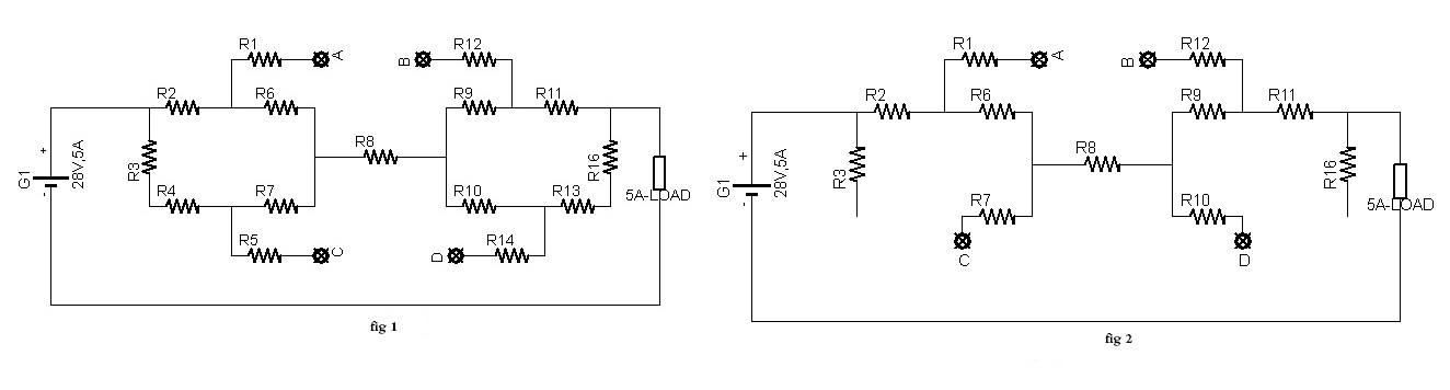

Consider the below circuit with 28V supply and 5A load.
What voltage would I expect when I connect a multimeter between A & B ?
V(AB1)= V(R6)+V(R8)+V(R9)
What voltage would I expect when I connect a multimeter between C & D ?
V(CD1)= V(R7)+V(R8)+V(R10)
Consider the second circuit.
V(AB2)= V(R6)+V(R8)+V(R9)
V(CD2)= V(R8)
Am I right ? And V(AB2)>V(AB1)

Yes. Assuming that the impedance of the voltmeter is high compared with the values of the resistors.
And V(AB2)>V(AB1)
Yes, if the load current is the same 5 amp.

As VQs question is written, you do not need to know the resistance values.
The question as written is vague and confusing, it would be much better if the thread title was simply:
Voltage measurement
And the words
What would I expect when I connect a multimeter between A & B ?
What voltage would I measure between A and B?
Only when you read the expression:
does it become clear what the real question is.
