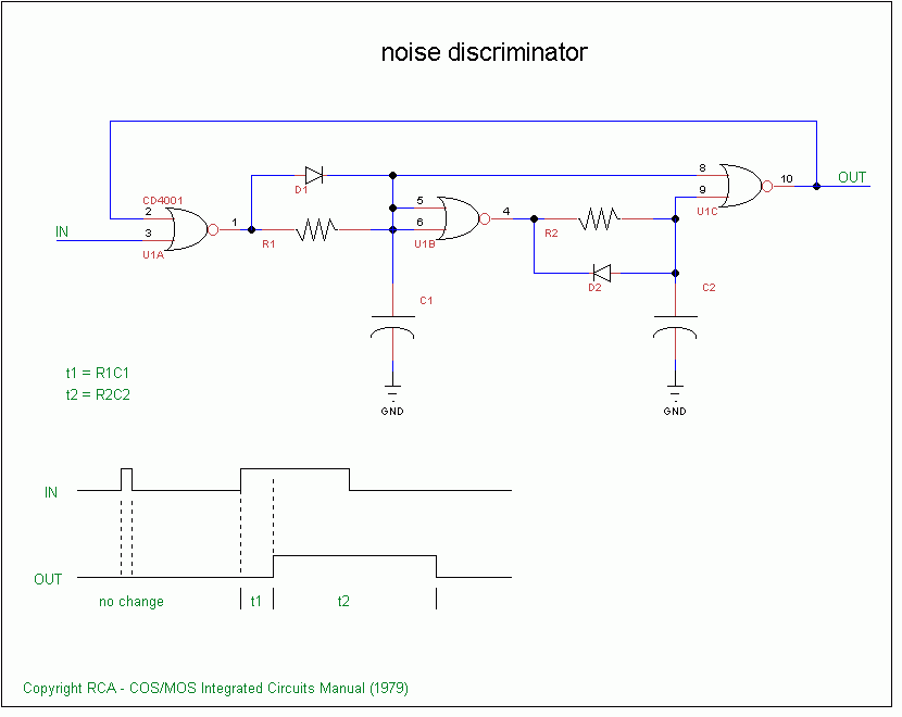

All good suggestions from kinjalgp. Is the reset line only used during power-up, or are there additional external trigger sources?
Unexpected pulses on the reset line, even those having very short durations, can reset the micro in the erratic way you mention. You should first try to determine whether the spikes are actually coming off the reset line or are being generated by power supply dips. Look at the positive supply with a scope, if you see the same type of short spikes that appear on the reset line, you have some larger power supply de-coupling issues to deal with.
If you determine the problem is on the reset line, either use #4 above, or try using a noise discriminator circuit (if there are additional external reset sources). The following circuit is from an old RCA CMOS manual. Input pulses having a duration greater than t1 produce an output pulse of duration t2, shorter input pulses are ignored. t1 = R1C1 and t2 = R2C2. The diodes speed up the recovery time of the circuit. Hope this helps. - CAL

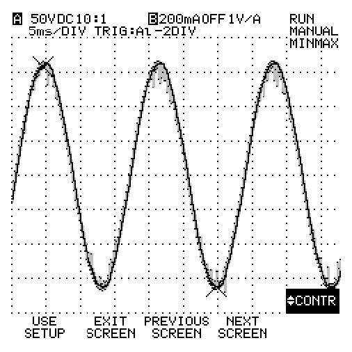

Scope of circuit

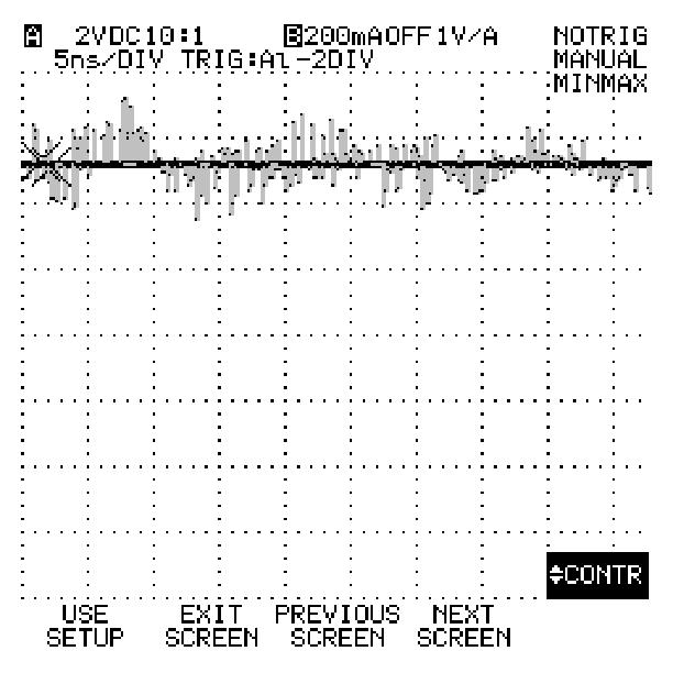

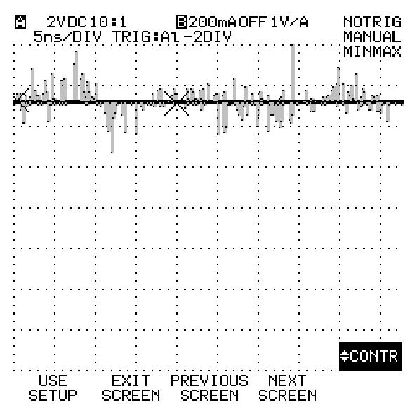

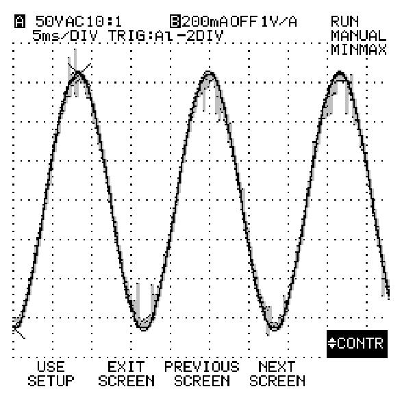

I used an O-scope to record the Min-Max of the Vcc, MCLR(active low), and the AC @the input voltage. I turned on the switch on-off for 5 minutes. Here is what I got:
The MCLR line seems very noisy. Check that PCB track of MCLR line is not too long. It is advisable to use reset controller in such case.
Even Vcc is fluctuating noticeably. Use of good regulator along with RF choke is recommended.

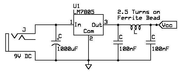

Can you give more details about in-line filter that you have used?
I would suggest you to have power supply like this. It solved same problem which I faced with one of my uC project. Let the line filter be there before the transformer and rectifier. It will have an added advantage.

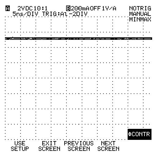

Here is the filter I used.
http://www.corcom.com/catalog/filters/H/Default.htm
It is an AC power filter. I have used filters/chockes in industrial machine tool applications where huge servo motors would apply power back to the power supply. This filter was readily avalible to me in house. After using the filter I recorded the readings below.
The Vcc and MCLR seems preety clear than before.
Can you show us your power supply schematic? It is adviasble to use large capacitor 1000uF after rectifier to maintain power to the circuit in case of large surges. See above given schematic for reference.

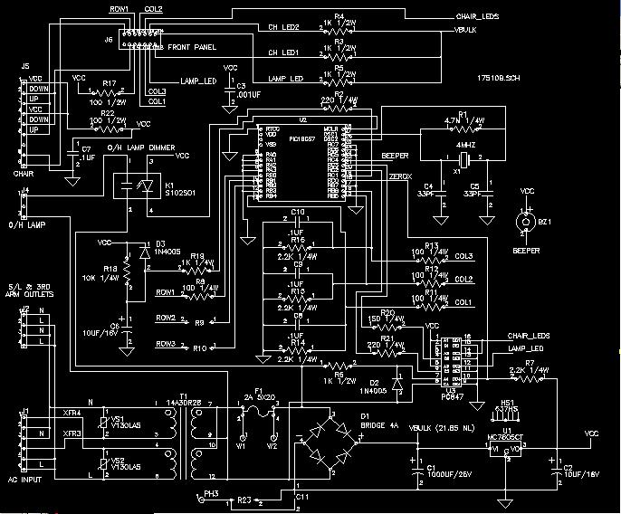

Here is the circuit. The light's power supply is powered by J2 pins 3 and 4.
T

I have a few suggestions
1) Change the decoupling capacitor near PIC from 0.001uF to 0.1uF
2) Datasheet of 7805 suggest use of 0.1uF between its output and ground terminals which is not shouwn in the schematic. Let the 10uF cap be there. Connect 0.1uF in parallel with it.
