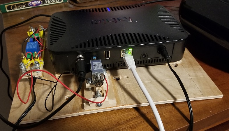

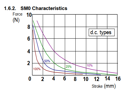

There is no gap between the end of the solenoid and the block it pushes on to activate the reset button. I push it up until everything is touching and then lock it down. I was afraid I was going to have to come up with a way to relieve excess force but not a problem with this solenoid. It can't even trip the button period. :(

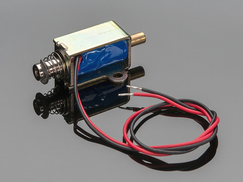

In the photo it looks like the solenoid is all the way back, with a long spring visible.
It should still be pushed nearly all the way in when it is not powered, so you are only using the final part of the overall stroke; that will be vastly stronger than the start of the movement.
This shows the relative strength of some type of solenoid, vs how close to being fully in it is; the proportions are similar with any solenoid, though the stroke and force scaling will vary:
Think of it like picking up a piece of metal with a magnet - too far away, nothing happens; as you get closer, it will get to the point the pull is just enough to lift it - but once it touches or if very close to the magnet, it takes a lot more force to pull it away.
No different with the solenoid, it needs to be pushed in as far as you can when it is idle, as long as it still has enough movement to press the button.

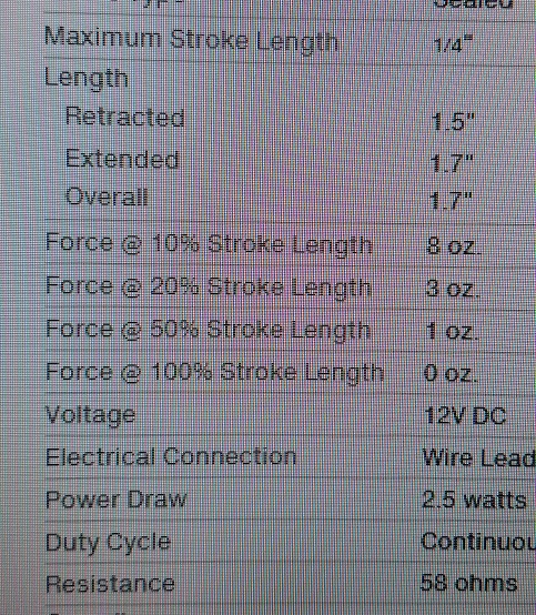

You are correct. I got that absolutely, totally backwards. I thought highest force was with the shaft retracted into the housing.
Took a screen shot of my solenoid specs. and I still don't get to 9 ounces.
I actually tried just to be sure and, of course, I was right about that. :(
Maybe I can rig up a pivot with a 2:1 mechanical advantage but not sure I have enough stroke to make that work. Reset button depression seems to be on the order of 0.05".
May still have to buy another solenoid, one that has some excess capability. But it won't be the monster I was envisioning before you set me straight.
I was expecting a learning experience but not this steep of a curve. And not falling off the curve so many times...
This solenoid should do the trick. I can just replace my wimpy one with this 5 newton (18 ounces) one?
I am pretty sure it will work only reason i ask is they mention the diode in the wiring diagram, but they also mention a micro chip. I think that's just to hook it up to one of their controllers?
This one is actually better than the one I have and paid much more for in just about every way.
Yes, you can just drop it in place of the other solenoid with your current circuit.

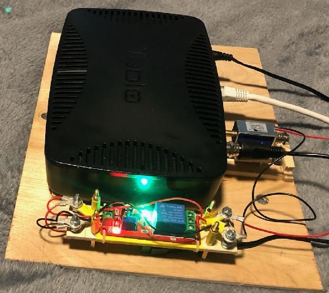

It works!
Just need to make a couple of covers and it's done.
Thanks for all your help!

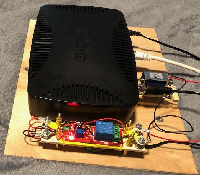

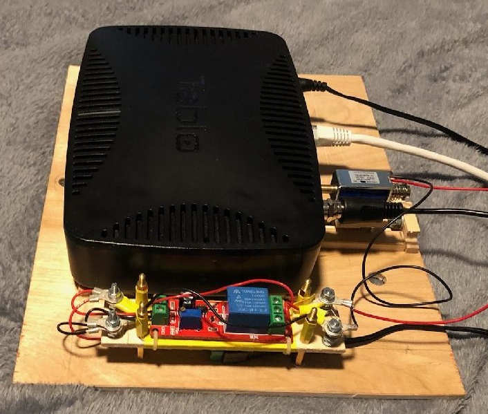

The device being reset by this apparatus is a Tablo DVR.
But the problem is with the modem. If I could upgrade the model, set a static IP address, and do port forwarding I wouldn't need this reset device.
But the people who actually live in the house, most of the time, don't want to mess with it, even though it would be better in every conceivable way.
I had a lot of fun doing this...
