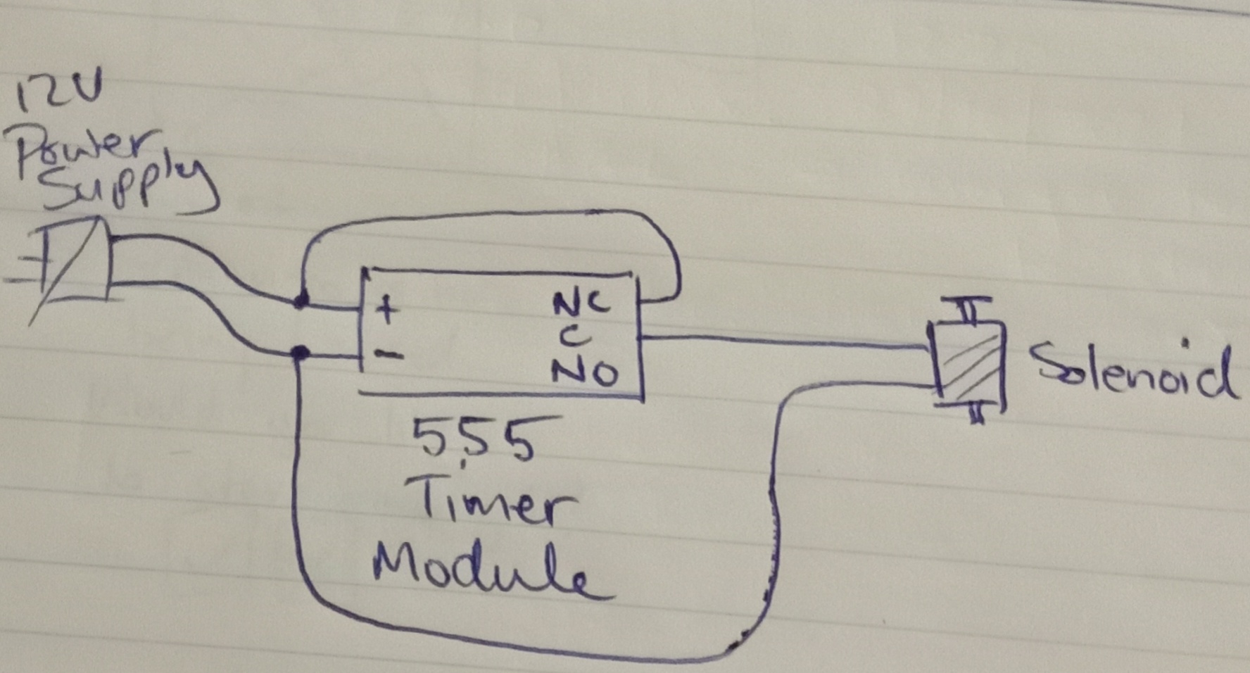

I am trying to set up a device that will automatically push the reset button on a separate streaming device every 48-72 hours. I tried just cycling the power on the device but that doesn't work. Pushing the reset button has been 100% reliable.
So, what I have come up with is
1. Use a simple light wall timer commonly available at Home Depot, Lowes or online for $10-$15.
2. The timer plugs into a wall plug and is set to turn on power to a 120v AC to 12V DC power supply, also commonly available
3. Then the power supply energizes a 12V solenoid which pushes the reset button.
I don't have the mount for the solenoid and how to attach it the streaming device 100% worked out but I am confident there's a simple solution, have some ideas.
The real problem I have is the minimum power on increment available using the timer is one minute. I only need the solenoid energized for 1-2 seconds. If it pushes the reset button for longer than that (I think it's 30 seconds) it could have undesired effects like resetting the streaming device to factory defaults. Also concerned with overheating the solenoid if it's on for too long.
One potential solution is to use this timer switch http://timers.shop/6V-28V-10-Amp-Timer-POSITIVE-OUTPUT_p_13.html which can be programmed to energize the solenoid for 1-2 seconds.
This is all shown schematically in the attached .pdf. The part numbers for the 12V power supply and solenoid came from a website where I found lots of good stuff. But when I asked for help and recommendations they told me to buzz off. One concern I have is that the 12V power supply is compatible with the solenoid.
So, this is really not a circuit but rather a combination of off the shelf devices I'm trying to cobble together to make a reset device. I would like for all the components to be UL listed. I found some hobbyist solenoids out there that would probably work but they look pretty iffy. Also would prefer not do do any soldering if possible.

You can make the solenoid so that it actuates only on the rising edge of the output of the DC power supply with just a series capacitor. But we need to know the minimum time to be held and the resistance spec of the solenoid.
I'm assuming that the DC power supply is a switchmode supply.

Here's the wiring diagram. Preferably there would be a diode or snubber on the solenoid to stop arcs on the relay contacts.
The time interval is set by rotating the little screw on the blue component

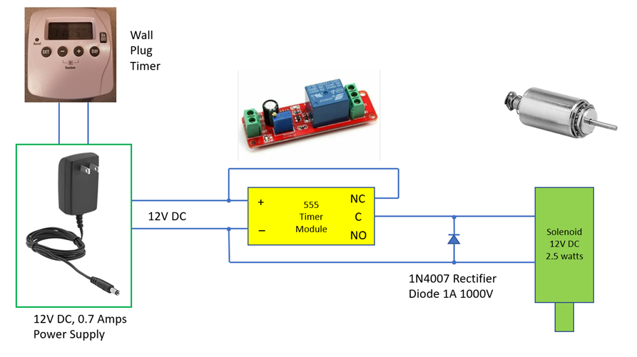

1st off, thanks a ton for all the help!
And, again, please forgive my ignorance.
OMG!??! Diode? Snubber? Sounds like some soldering?
OK, I have done some limited soldering. Just not enough to ever get good at it.
So where in the diagram above would the snubber go? Which diode should I use as a snubber?
Might it also be a good idea to add a fuse to the mix?
Also, again, any reason to think this power supply and solenoid combination
won't work with all of the above?
The supply is fine. The solenoid is ridiculously expensive, but should work fine. Here are alternatives.
Any website into robotics should have an assortment of solenoids.

1. Do I really need the diode (snubber) to stop arcing at the relay contacts? Is that really a serious problem, like as in fire hazard?
2. If I do need the diode which one should I get and where does it go in the circuit diagram above?
3. Any comments on the virtues of adding a fuse? How failsafe is this? If the delay switch fails it just stops working, no melt downs or anything scary like that?
I just don't want to set the house on fire.

OK, got everything together and wired up. Tried a test fire of the solenoid and nothing.
I checked all my connections (using screw posts, nuts and washers) with volt ohm meter and didn't find anything obviously wrong. Feel confident I hooked the wiring up correctly irrespective of the quality of the connections.
The 555 unit lights up in different ways when the power is applied. There are 2 different lights. Sometimes one or the other lights up (briefly), sometimes they both light up, sometime neither lights up.
Finally I disconnected the power supply from the circuit and hooked it up directly to the solenoid. And, nothing. Actually the solenoid did fire two or three times but couldn't make it work more than that.
I checked the continuity across the solenoid and it appears to be good.
So, is it possible my power supply doesn't have the amps it needs?
Is 25 gauge solid wire large enough for this application?
Is it possible it's just a bad solenoid?
And, assuming I figure it out how do you set the timer interval on the 555 unit. I see the litlle turn screw but don't know which way is more or less time, and even if I did don't know how far to turn it. Is it just trial and error?
Any help is appreciated.
Thanks.
It's possible the power supply isn't up to the task. If you can get access to a better supply, you can try the solenoid with that.
In the meantime, disconnect the solenoid, and see if the timer does what you want. The LEDs presumably illuminate to indicate what the relay is doing, so setting the time should be straight forward. It's possible that the solenoid was interfering with the supply, and consequently upsetting the timer.
The solenoid is 12 v dc push which is supposed to draw 2.5 Watts of power.
The power supply converts wall current, 120 v ac, to 12 v dc and says it's rated for 0.7 amps output.
Does this not equate to 8.4 watts from the power supply?
One other bit of info when i check the continuity across the solenoid it gives a return of 56.4 ohms.
So if the above power supply is not adequate, or otherwise incorrect, what rating power supply do I need?
You are correct, and at 56.4 ohms, it won't draw more than 2.5w. you also said that the power supply won't drive the solenoid, so either the supply is broken, or the connector is not making good contact. Or the diode is broken or connected backwards. The solenoid should be fine if it's still reading 56 ohms
Did you see what happens when the solenoid is out of circuit?
Is the diode pointing in the correct direction? Testing the diode with the multimeter might be worthwhile
