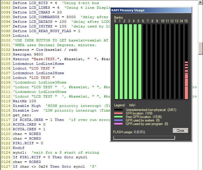

Check using Oshonsoft Options/Ram Memory usage the amount of free RAM and Flash memory.
I have had to shrink some of my 18F4520 programs because of the Compiler complaining of insufficient RAM.
E
Hi Eric,
All simulation NMEA sentences shortened, and the program back to >80 <60 as original.

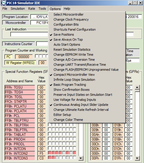

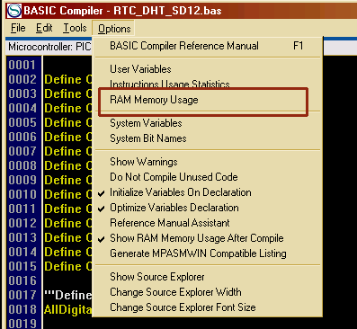

I don't see the ram option, I should probably update again?
E.
Refer images.

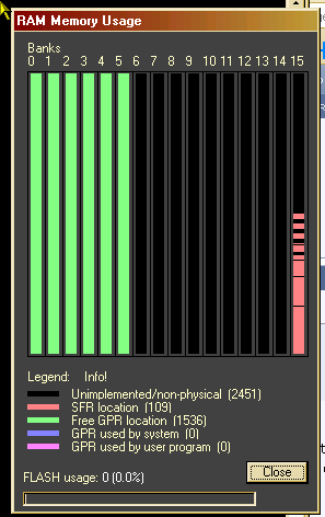

hi C,
You must compile the program before doing the RAM check, else you will show zero usage, as per your image.:woot:

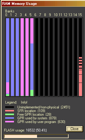

Which line in the program.???
EDIT:
This what I see for 18F4520 project with SD Card.
As you can see I have almost no RAM [GPR] free.

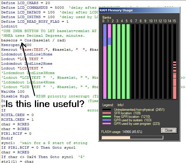

Another try:)
C.
Also: Is the line shown in the program, being used?
That basecos is equivalent to latcos1, so its now redundant.
'extract from your listing
latrad1 = 50.662341 / 57.295779
lonrad1 = 1.591347 / 57.295779
latcos1 = Cos(50.662341).???? degrees !
''Note:
latcos1 = cos(50.662341/57.295779) ' REM Rads !! == 0.884224665 ==latrad1
E
You have lots of free RAM
It's possible that I have found the 'reset problem'! It's possible that I had a line incorrectly positioned in the program. I've now moved it and the program appears to be ok now, so it looks as if the problem isn't to do with a reset problem.

Hi E,
The line I mention above, is the basecos line which is in the program too early, using variables that hadn't arrived yet. Once moved it could do its proper calculation.
