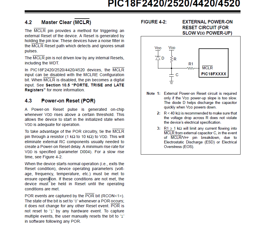

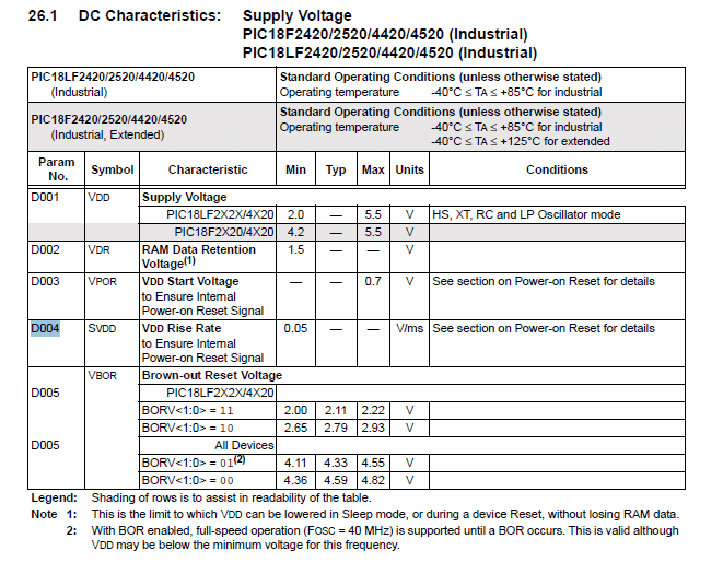

It could be a problem due to a slow rise time of Vdd at power on.?
Try scoping the Vdd to the PIC at power On.
E

Would this also be the case after reset? Reason! After many complete restart tests, I am finding that this happens after reset too.
I am sending simulated NMEA sentences (See bottom of the program) to the PIC using a macro from a computer terminal. Briefly, I press the IND button as first BASE sentences the sentences are fed into the PIC, which puts the first set of NMEA BASE sentences into BASE, then after release, the sentences are at a 100Mtr range, copying a remote GPS sentence. The first part ELEVATION always seems to work, but if things aren't perfect, when it gets to the AZIMUTH sentences it goes haywire. Once correct, I can reset or not and it always works ok.
EDIT: With my ancient oscilloscope, it looks as the voltage goes steady quickly, and with reset, there's no flicker.
C.
