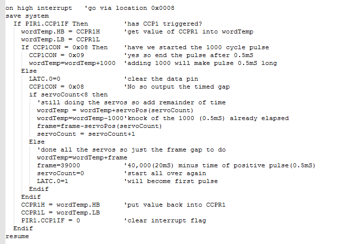

Here's a version that (hopefully) should work on interrupts,

There's no priority set as the default is to vector to the high priority interrupt (0x0008).
Can we just try this as is and see if it works?
Here's a picture of the ISR in Notepad++,
I hope you agree that having the indenting aids in following what the code is doing.
The dotted lines match up the If, Else & EndIf that go together.
The first If isn't actually needed as CCP1 is the only thing that can trigger interrupts but that's about to change.
The second If decides if we're doing the 0.5mS positive pulse or the remainder of the servo time.
The third If decides if we've done all servos and if so outputs the remaining time (in frame) and resets everything.
Also attached is the text file.

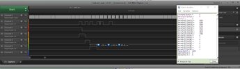

Hi M,
I added [Dim servodir(8) As Byte] and it started working, also the 'live' SERVO is going forwards and backwards.
C
