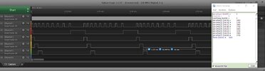

What I'm saying is HOW are these values possible?
They should be increasing by 250 each time but are instead getting 6 smaller.

Can Oshonsoft not do simple maths? i*250+2000 should be simple maths, why is it wrong?
How does 7*250+2000 equal 2214? So, 7*250 = 214!!!! How. And 6*250 equals 220.
As I said previously, I'm fast loosing faith in Oshonsoft. No wonder you can't get things to work.
From that table of values, it's doing the 'i*250' portion as a byte (with a byte result) and then adding that to 2000.
I don't know what the syntax would be to get it to do the math using words... never used it.

Here's a test using the #486 method (with 2000-4000)

Those timing diagrams are all correct. But I am still amassed that a simple for next loop doesn't work correctly.
Well spotted. Can a cast be used or does i need to be a word to force 16 bit calculation?
Or both.
Maybe,
Dim i as word
servoPos(i)=i * (word)250+2000
Here's a version with i defined as a word and all the 0bs changed to %.

Hi M,
Here's the result :)

Except for the idle time of 16mS which is caused by a typo by me,
frame=31000
should be
frame=39000
Sorry,

Strange, it seems in some cases, versions of the Basic "compiler" may produce integer values when multiplying byte "i" by 250. However, in the PIC18 IDE (not compiler version), I get the proper values calculated:
Dim i As Byte
Dim servopos(8) As Word
For i = 0 To 7
    servopos(i) = i * 250 + 2000
Next i
End
Produces the right values:
Is it possible that somehow servopos is being modified elsewhere?
Also, integer overflow could produce values that change by 6, based on multiplying by 250, but a byte can only hold 255 maximum.
Put a "Break" after the Next i statement and verify the values are correct before allowing the rest of the code to run...
