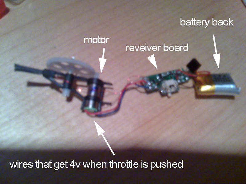

Hey so I have a remote control helicopter that outputs 4v to the motor when I give it full throttle on the remote and goes down to 0 when i let it go. I want to know how to increase the voltage to 9v when i get on the throttle...is it possible to use a transistor? or a relay? Thanks in advance :)

ok just to clarify the helicopter circuit is being used to wirelessly shoot bottle rockets off another helicopter...I don't want to change the power supply...I want to add a 9v battery to the circuit somehow and allow the 4v im getting to trigger the 9v to run ...the motor is not connected at all so it wont be blowing...essentially the problem is i have 4v running on the press of the remote, but 4v is not enough to ignite my rockets so i need 9v..i read that transistors and relays are the way to go...unfortunately i have no idea what i'm doing when it comes to transistors.

so this is the circuit...the two wires that run to the little motor are + and - I want to disconnect them and get them to either get 9v when the remote is pushed or hook up a 9v battery with a transistor that allows the 4v to switch on a separate 9v circuit.
I would just use a 5 volt micro relay. They work just fine on four volts. Or get a 3.3 volt one. the slight over voltage for the small duration it takes to get the ignitors to work wont bother them one bit.

Hmm sounds good can you help me a little more though...5VDC/1A SPDT Micro Relay - RadioShack.com would this one work? if so how would I wire it up with that circuit I've never used a relay before...? If i'm using that I don't need the 9v battery? Does the relay essentially just jump up the voltage without another power source?
EDIT...i read up on relays and i understand how they work now...they are more or less and electro magnetic switch...is it possible to do the same with a transistor?

Yeah luckily the parts im using for the ignitor are from a micro rc copter and they weigh almost nothing...the copter still takes of with the payload...if I wanted to use a transistor how would I wire it up? Please refer to my picture above to understand the circuit.

It uses pulse-width-modulation for its speed control. All the pulses are +4V but their on-time/off time duty-cycle changes with the throttle.
You could filter the pulses with a series resistor and a capacitor to ground and use the filtered signal to feed the base of an NPN transistor that drives the ignitor from +9V.
im not really sure what your talking about regarding pulse with etc...but i used a micro 3.5 relay from radio shack and wired that up to switch on a 9v when the 4v is juiced through the relay and it works perfect...thanks for all the help.
