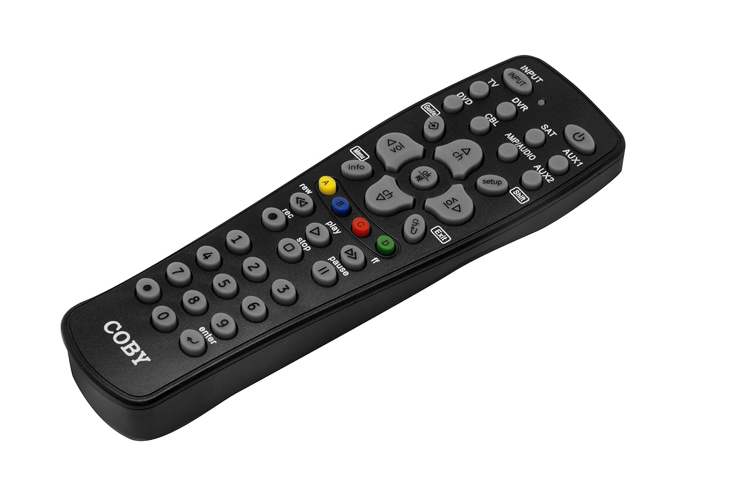

Why not just buy a small universal remote such as one of these?

hmm, one mute button, arthritis, sounds like you want solution more than project, I recommend:
open existing remote,
cut out old mute button,
solder in a new push button more to your liking,
wood glue to hold button and support solder contacts
it may come out looking a bit like Frankenstein, but is a faster solution
Best Buy and others sell universal remotes with large buttons for exactly this application.
ak
The middle OK button is used for MUTE. YOu just look up the model code of TV and follow setup instructions. https://www.amazon.com/gp/product/B..._t=101&pf_rd_p=2150407382&pf_rd_i=12035708011
$8 + shipping. or Walmart
Lots of good ideas and suggestion, thanks, doesn't look like anything I can build from discrete components, may have to cannibalize something store bought, mount the IR LED where it point at the receiver, the button where it's handy and the rest elsewhere.
