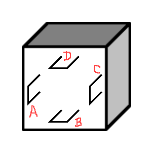

VIEW ATTACHMENT FOR RELAY DIAGRAM
A = From Battery Positive
B = To Accessory(+)
C = To Switching Means (to turn relay on)
D = Chassis Ground (for relay)

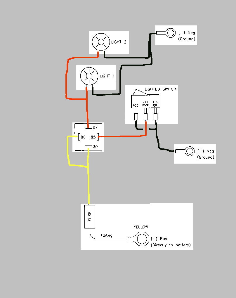

here try this im quite sure it will work the way you want it.
you will have to put a diode 1n4001 on terminal 85 to 86 to kill spikes from the coil releases.
i don't see how will this work, maybe you tought of something else...
if wired per last circuit, relay coil will be always connected to gnd
(one or both sides depending on switch position).
before we try to rearrange circuit can someone check if the light indicator
in the switch is polarized (as indicated with + and -) or not...?
on the switch (GR - is for the internal light only of the switch)
(pwr+ is for the light and the supply for acc when switched on)
(acc is the 12+ to supply the load or relay when switched on from pwr)
that how a switch I have here is setup, if you where to connect the acc on the pwr then yes you would have neg when off and positive when on.
