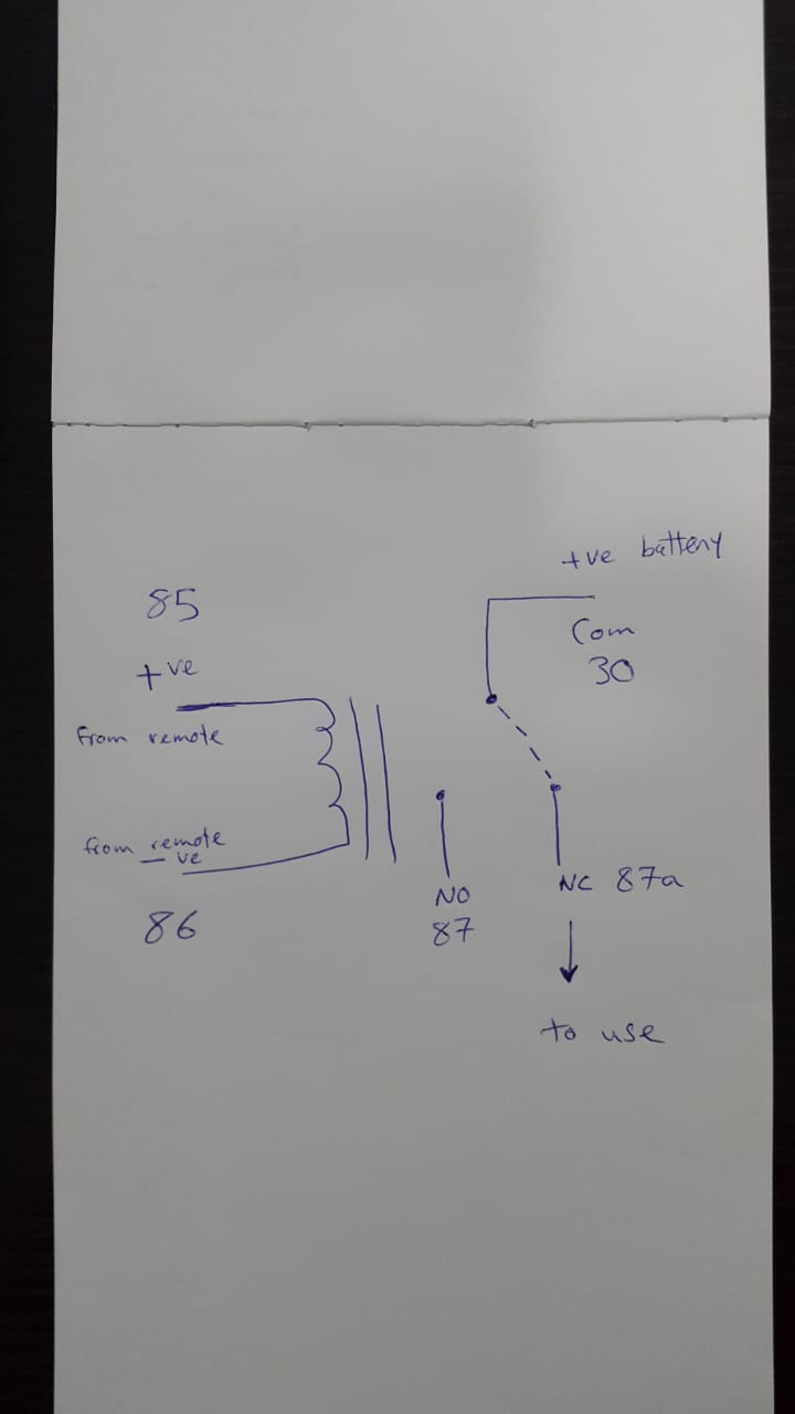

did u do circuit like this ? .. please send me photo
somebody sent me this connection for relay

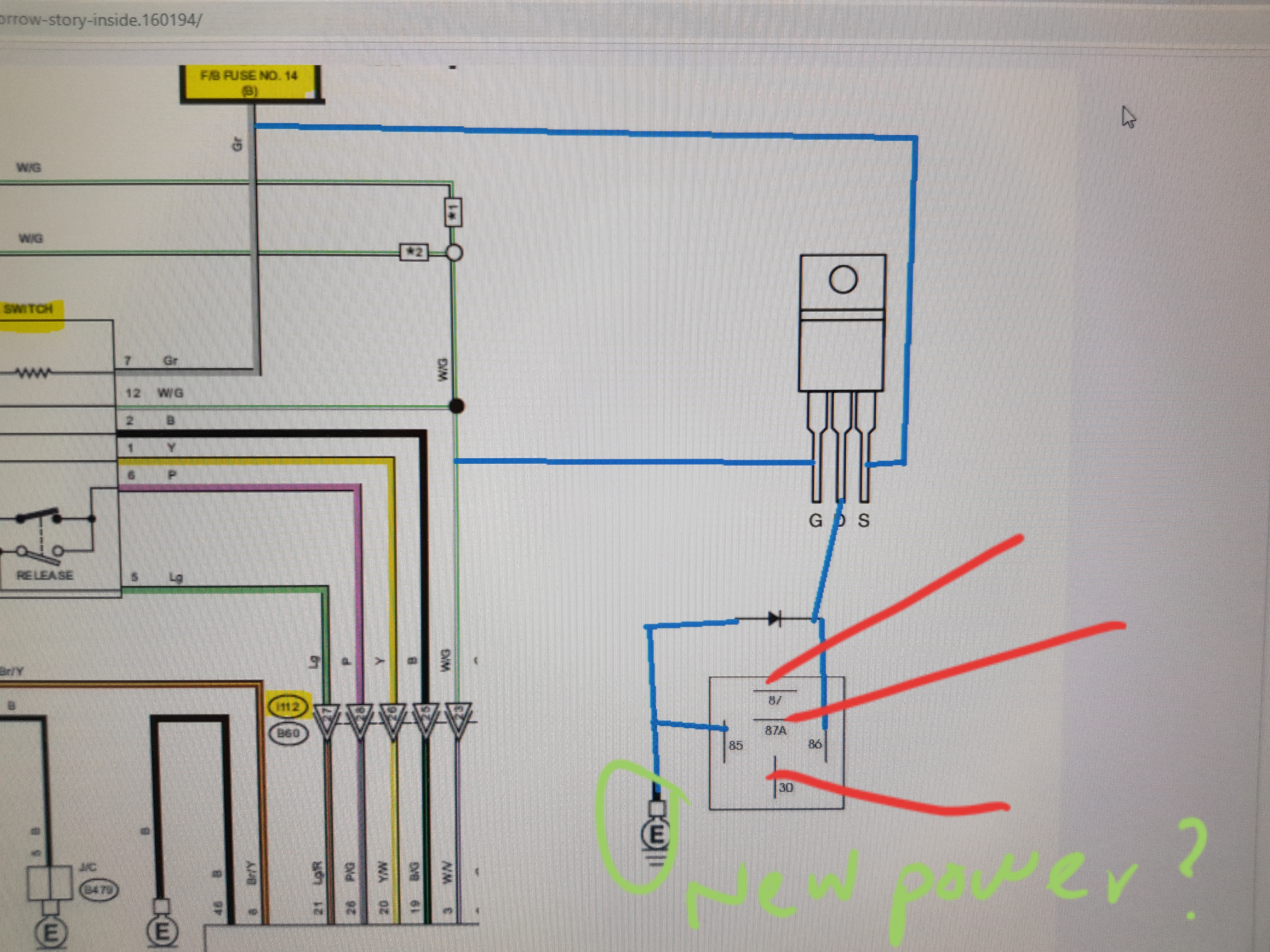

Wow, this is exactly 100% my case, please give me full details with components no and connections and photos if available please
what is the relay number ?
did u use and resistors ? 100 ohm and 100k ohm
connection is the same as in the image above between your MOSFET and relay ?
Everything is in the other post I said. I didn't use any resistors. It's the same as what that other guy drew for me on my diagram thing.
Ok thanks i nearly got all the components
Have only one doubt
In the picture attached now 3 pins marked by red
What will be connected to these pins ?
The pin marked in green, this will be the new 12 volt output ?
and i cannot understand why relay is needed ?
The green is earth/ground.
The red, well one is the voltage for what you want powered and one is the source of that power. The middle one is not used. So you're going in between an existing power line and interrupting it with the relay. Relay is what switches between on and off. MOSFET tells the relay to switch when it's 0v.

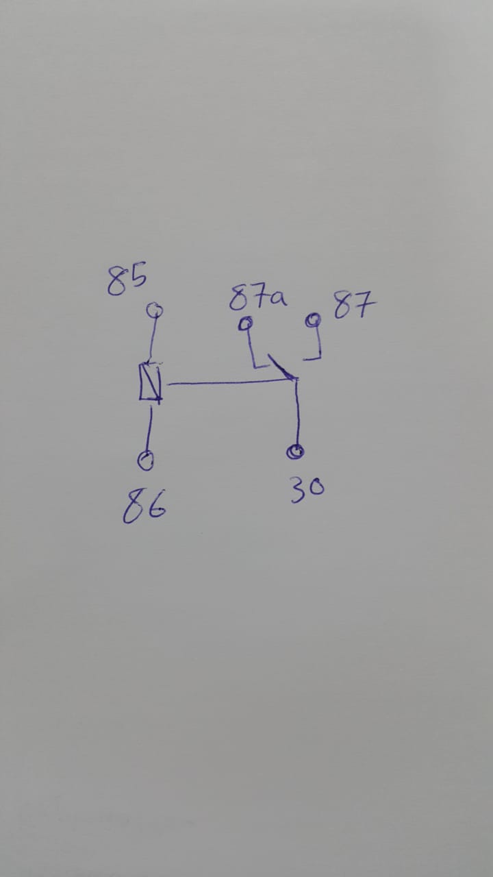

Not too bad once you make it!
so i can use
87 for the device i want it to be powered
87A not used
30 continuous 12 volt supply
86 is connected to MOSFET drain pin
85 is connected to 86 through a diode and then to ground
sorry i have no idea about this at all
correct ?
so i can use
87A not used
correct ?
yeah pretty much!
