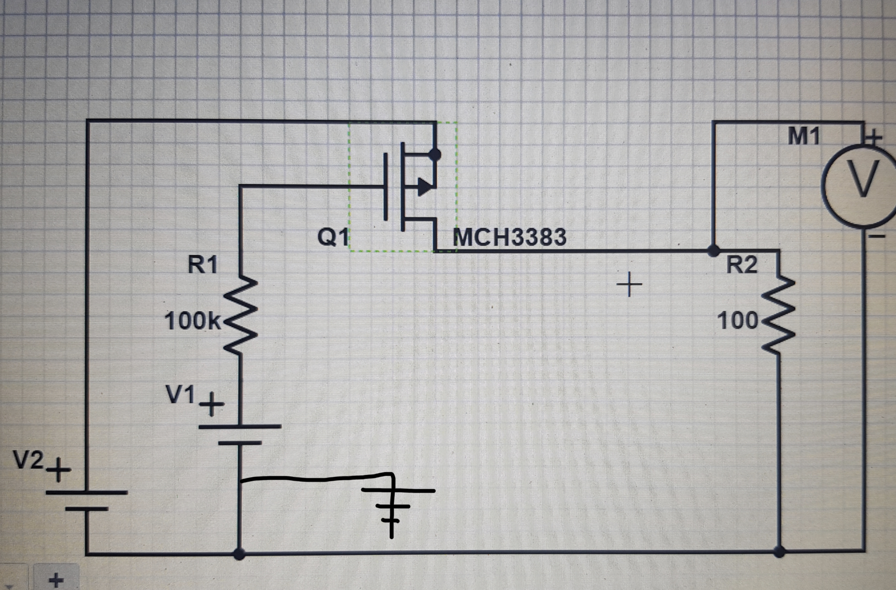

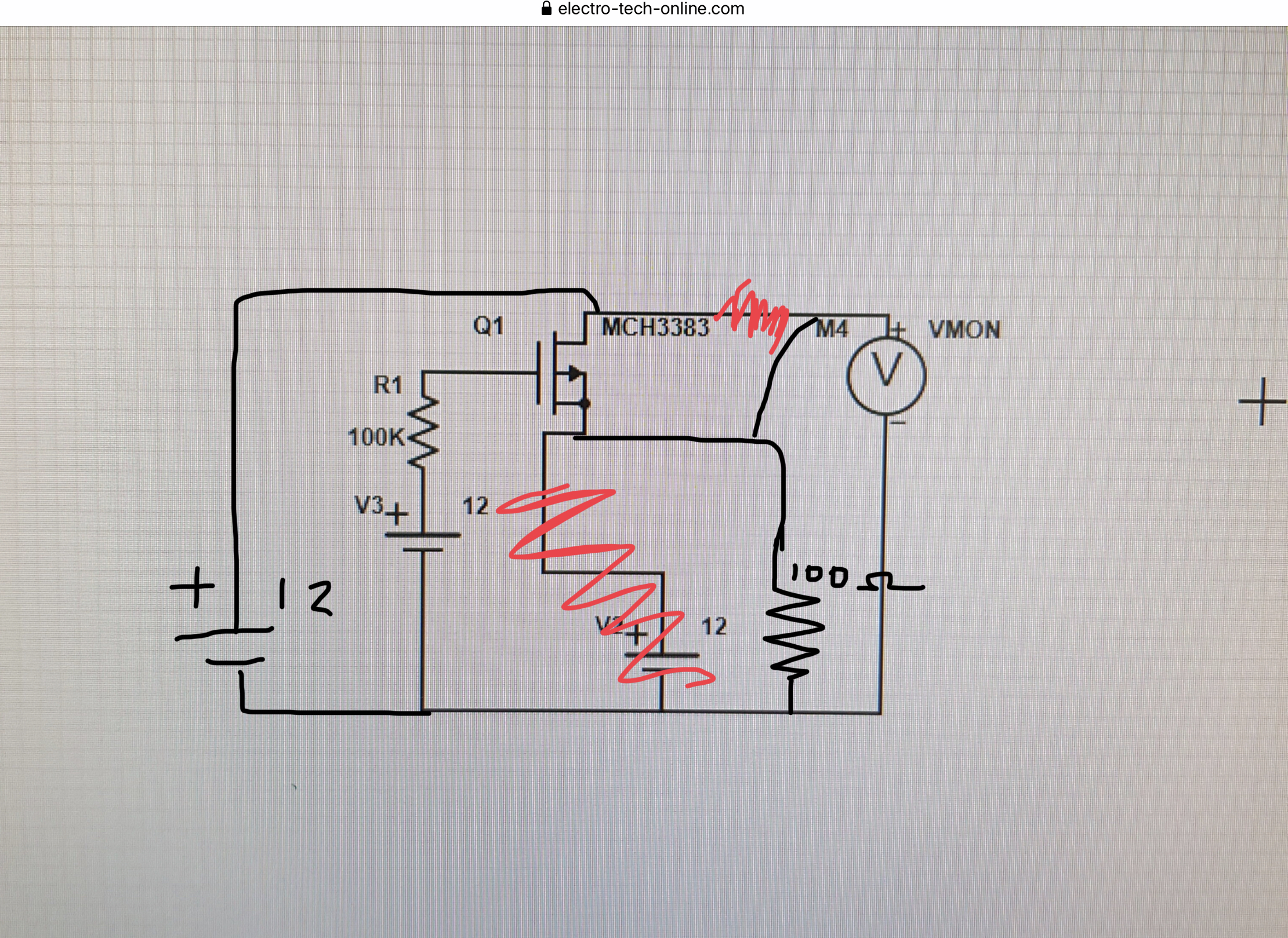

Your circuit has an error. Disconnect area in red, add my drawing that is in black. You need some type of load to complete the circuit in the simulation so add a 10 ohm to 10k ohm resistor to complete the circuit (circle).

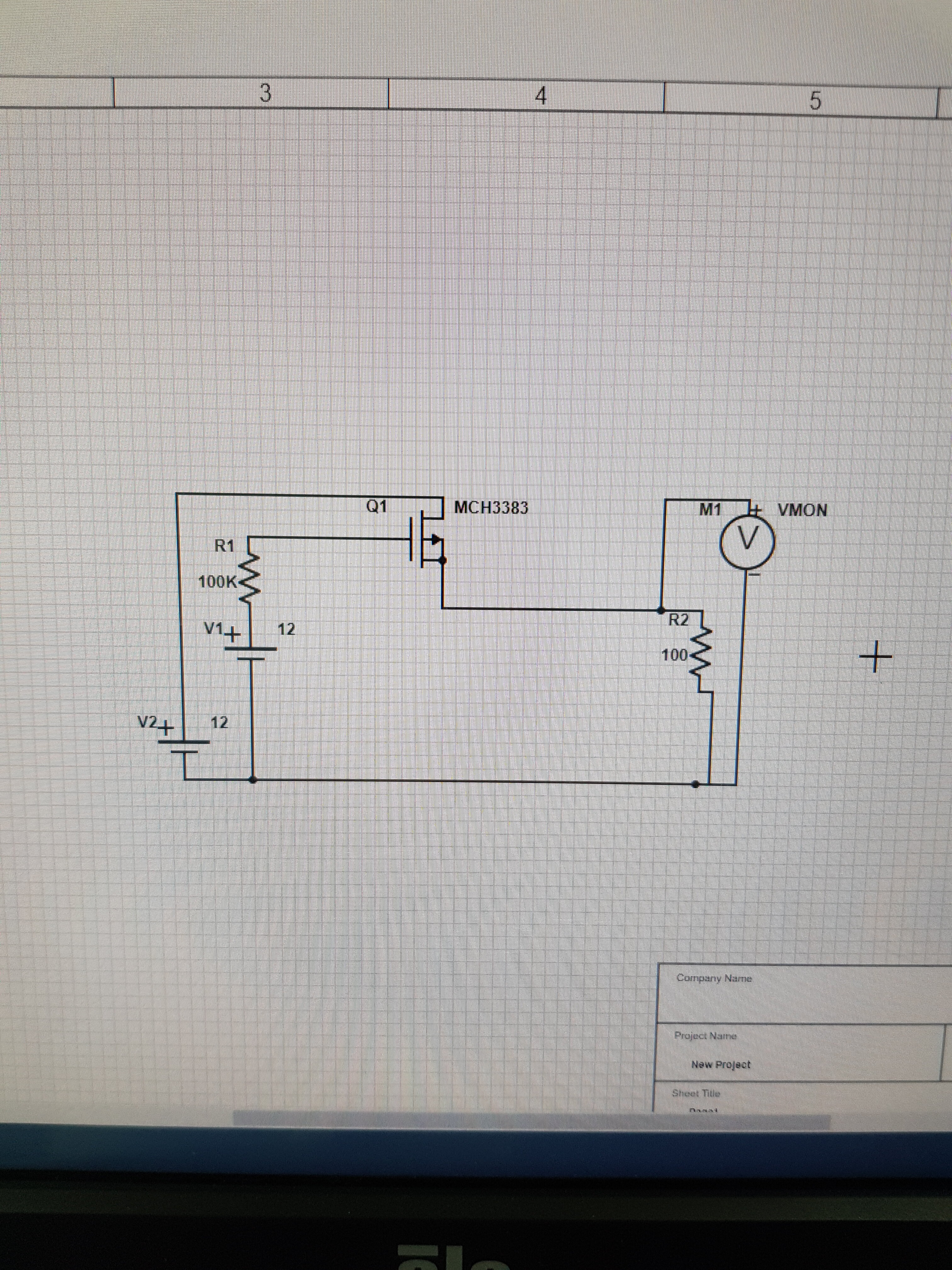

Did exactly what you sent, not working :( , i can see here in this drawing 3 components 1 MOSFET, 1 Resistor 100k ohm on Gate, 1 Resistor 100 ohm on Drain correct ?

Your mosfet is "upside-down". It should be like this...

Again, tried the circuit , no ground and not working
Please i need the exact components and exact circuit

And change your 100k gate resistor to 10 to 1k.
And add the ground icon and connect to the node shown.

While I doubt that this is the cause of the simulator errors you're getting, the MCH3383 mosfet that you have in your circuit is not suitable for your application.
It's maximum drain-source voltage is only 12 Volts. The voltage is a vehicle when running is typically 14 to 15 Volts.
I suggest a part with a Vdss rating of at least 30 volts. Personally, I would use a 60 volt part.
Also, you said that your trigger signal is coming from a relay. When it's not at 12 volts, is it actively connected to ground, or just not connected to 12V? If it's just not connected, then the p-mos circuits described above will need a pull down resistor at the input.

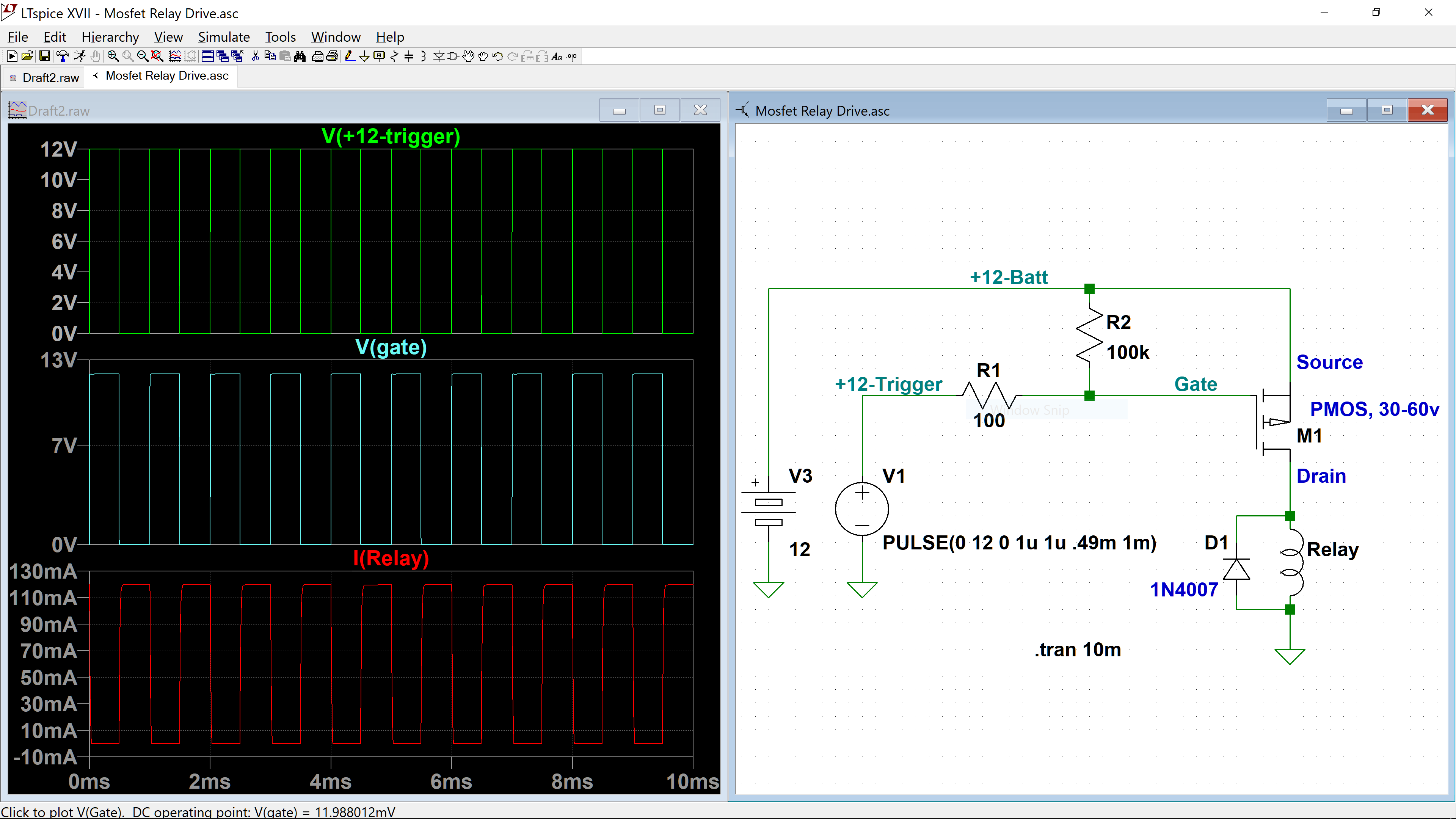

Connect the circuit this way.
When the trigger is 0v, the relay will energize.
When the trigger is 12v, the relay will de-energize

A) P-MOSFET 30 - 60 Volts 5 amperes
Amps = 100% over the required relay current. If the relay requires 100 mA, then a 30-60v, 200mA mosfet is needed (minimum)
B) 1 resistor 100k ohm to be connected to between source and gate terminal
Yes. This ensures the mosfet turns off when the input voltage is at 12v
C) 1 resistor 100 ohm only to be connected to between gate terminal and alternating voltage wire (0-12 volt)
Yes. I've shown a square wave "trigger" signal so it would be easy to see the activity.
D) 1 diode 1N4007 between the drain and the device to be activated by the output from MOSFET.
If you add a relay, the diode surpresses the back EMF generated by the relay coil that could damage the mosfet or induce improper behavior in nearby circuits. The relay contacts would need to be able to handle the load capacity of 5Amps (I think that was the required current(?))
