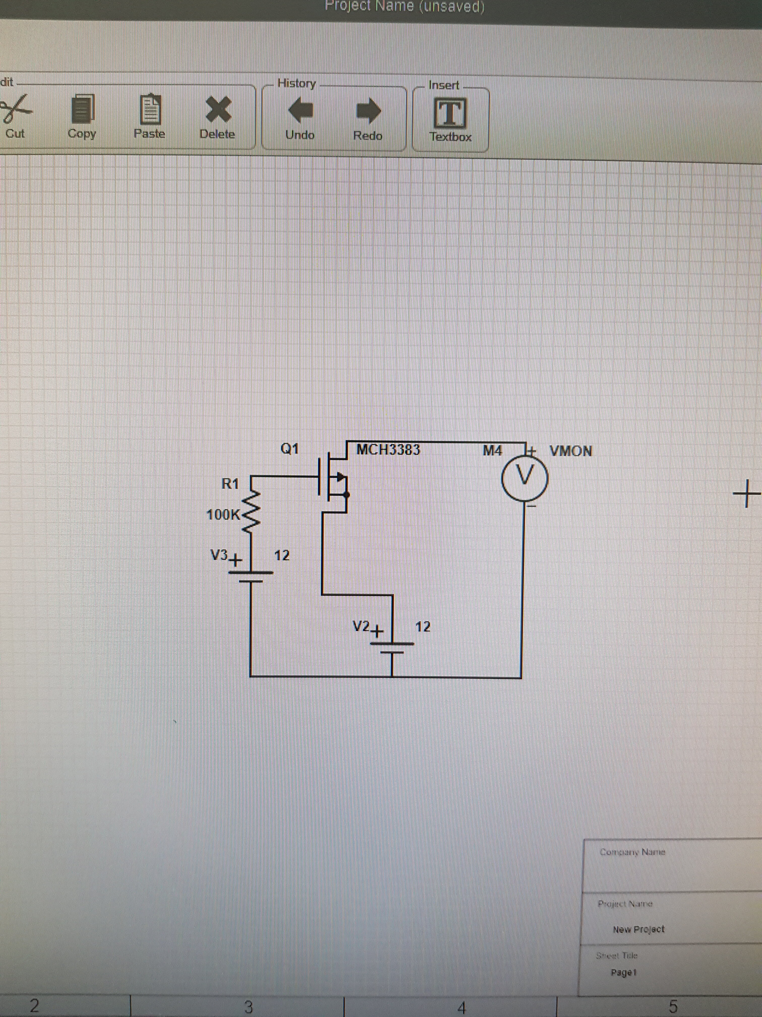

I found this one, can you please check it for me
IRF9Z14PBF 60 Volt, 6.7 A
Thanx
That should work fine, but it's not in an SMD package as you mentioned wanting.

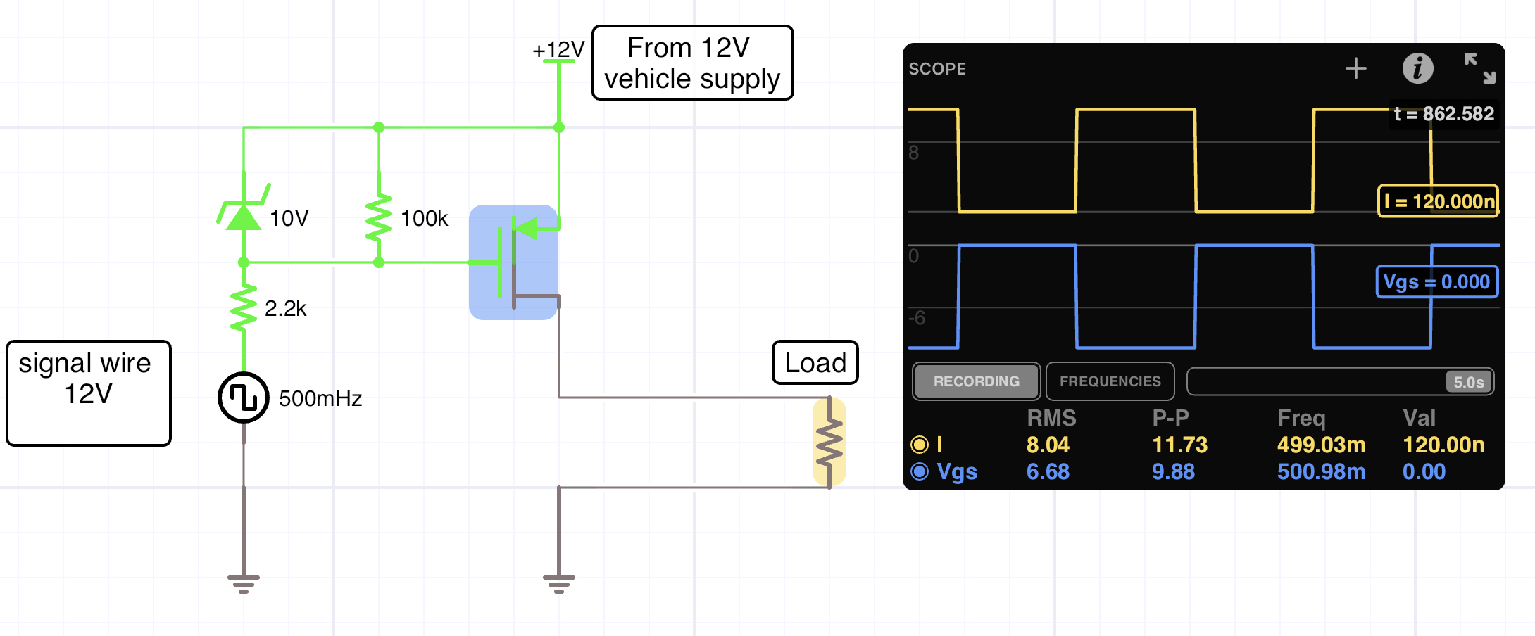

You only need the plus voltage as long as the input goes between 0V (transistor on) and 12V (transistor off), [see below].

I

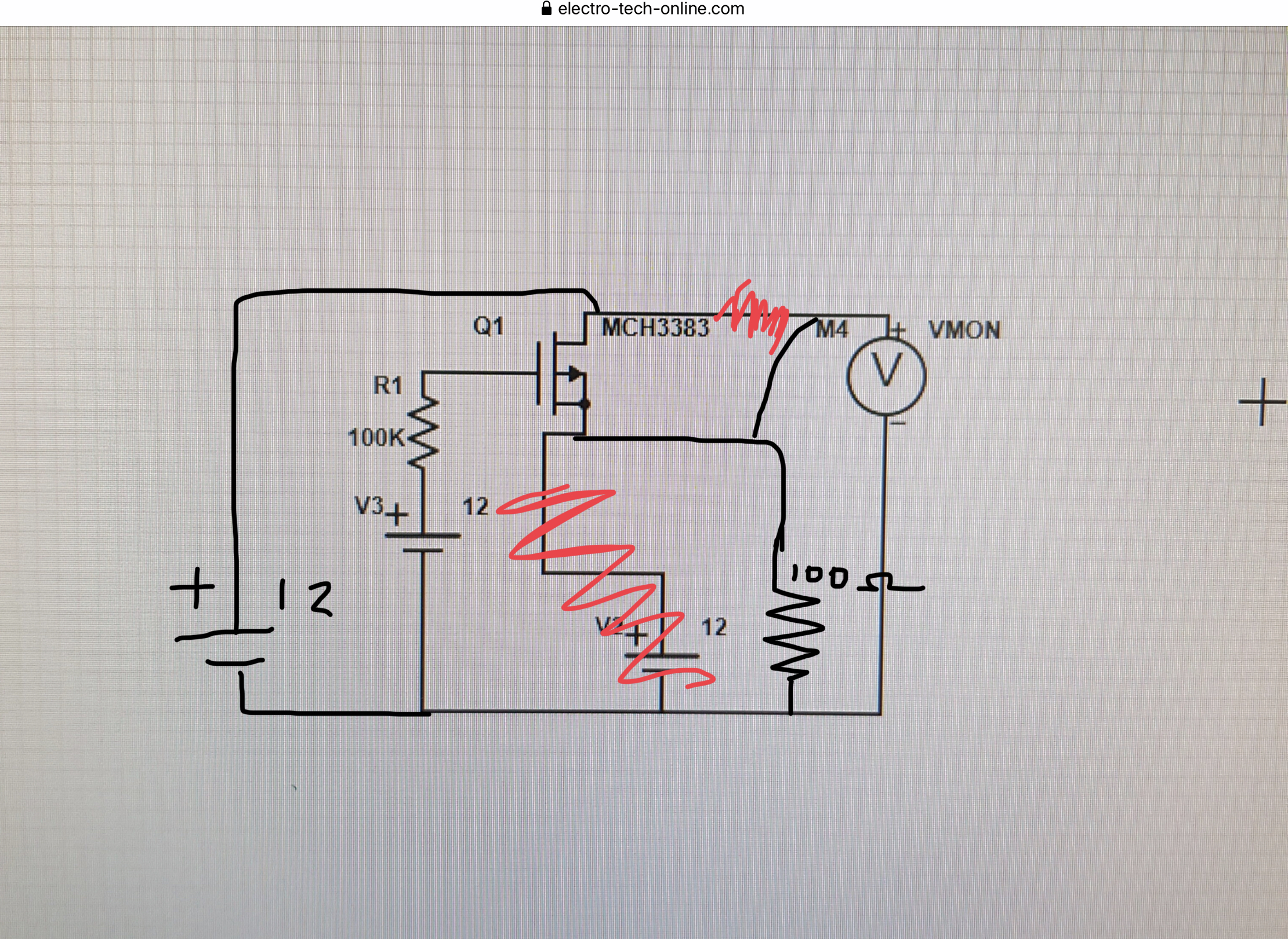

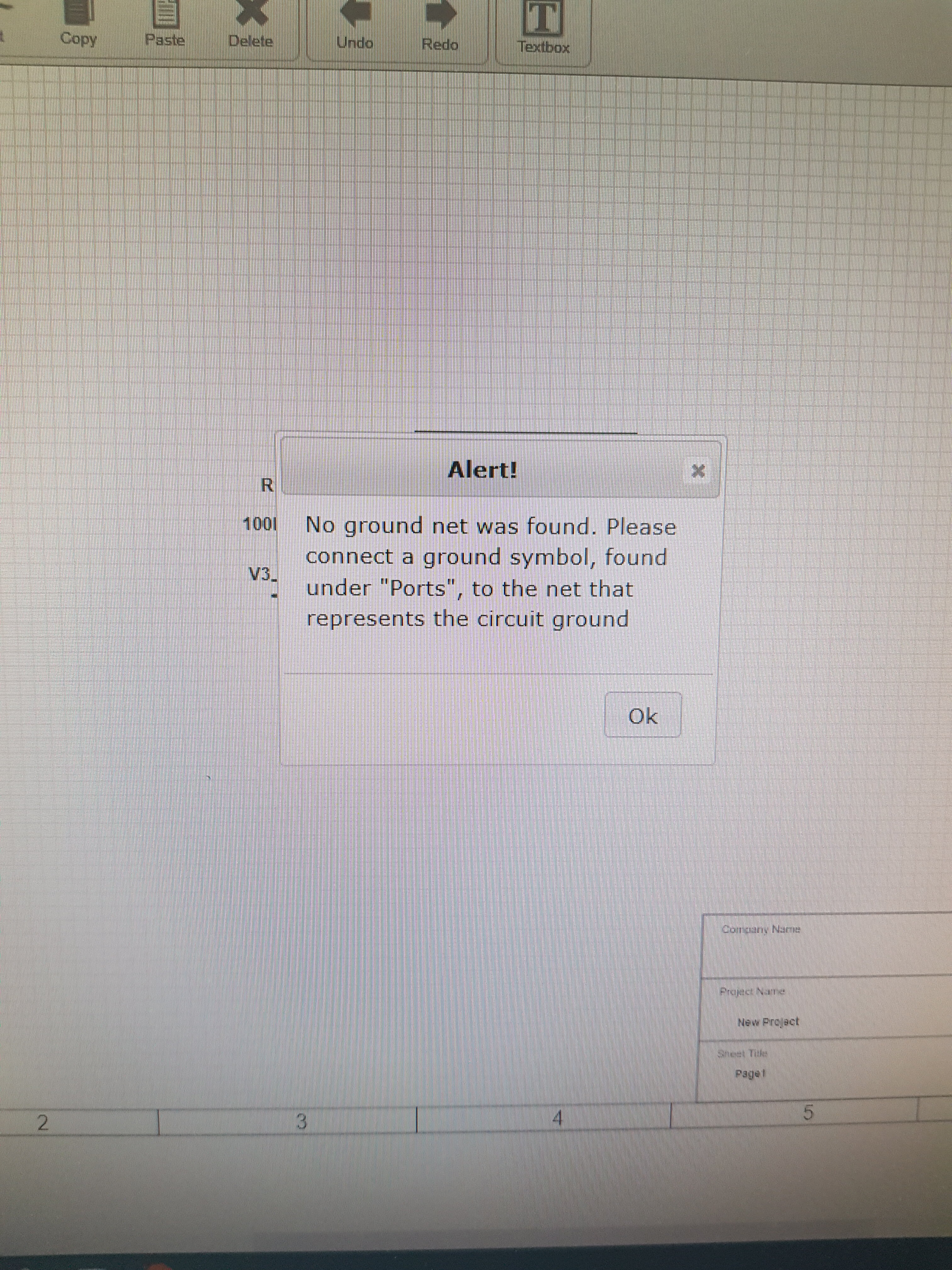

Forgive me , i'm just a beginner, is this circuit different from the one sent above? I tried to run the circuit i posted above after addition of ground and same result 0 volt !!
Your circuit has an error. Disconnect area in red, add my drawing that is in black. You need some type of load to complete the circuit in the simulation so add a 10 ohm to 10k ohm resistor to complete the circuit (circle).
