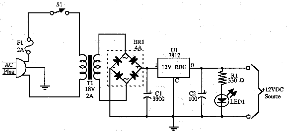

so i made my first attempt at a full wave rectifier circuit, I built it off a circuit diagram and some advice from an older thread

1) the diagram had values next to the capacitors, but no reference value. i.e. it said cap one was 3300. i am guessing that that is 3300uF, so thats what i put in. Radio shack didnt have a 3300uF cap so i put in a 4700uF cap, but i figured that would just give me extended discharge time, and not effect my circuit negatively.
2) the 7812 had a reference picture telling me what my leads are, but it is symmetrical, and so i assumed that the picture meant i was looking at my chip from the front, or the side with the writing... maybe i put it in backwards?
3) i did not attach the center lead of the 7812 to the machines ground, or anything for that matter...

What is your power source?
3) Why would you not connect the center lead of the regulator? It clearly states that this is the GND pin which needs to go to your circuit ground. How do you expect a circuit to work if you don't connect it as the schematic shows?
Please post your schematic.
Check your diodes, the first time I built a bridge rectifier I had it hooked up wrong, instant dead short, very common, and there's no telling what else you blew, hopfully just the regulator. That was a big nono not hooking up that center lead though.
Another point of interest: What is the regulator's input voltage?
I had the ground lead of the chip wired into my circuit but i didn't attach it to the machines ground, so it was effectively not used. The machine is a shear that cuts 10 foot sheets of sheetmetal in a shop i work at, and I am converting the machines incandescent lighting which fails constantly due to vibration. The machine feeds the incandescent lights at 24VAC, and I am purchasing some prepackaged LED assemblies to install on the machine. I appreciate the feedback, the importance of the ground lead didn't strike me since the machines i wire up for the most part dont use their ground leads at all... Circuits are a whole different game i'm learning.
the regulators input voltage to my understanding is 12 volts DC, and it is supposed to act as a smoothing "regulating" chip for the rectifier output. im building the circuit based off the schematic i was referred to on a previous thread, except for the 4700uF cap instead of a 3300uF cap. the caps that i bought are labeled 4700uF 35V. that 35V means that they can handle up to 35V correct? but since i am feeding them at 12V that is their output?

With 18VAC in the voltage across C1 will be 25V.
The regulator has a drop-out voltage of 2.5V so it requires 14.5V to regulate properly. The 4700µF capacitor is large enough to filter the ripple so the voltage never falls below 14.5V.
Is the input voltage 24VAC?
If so the voltage on the C1 will be 34V which is pushing it and the regulator close to their maximum ratings.
i have left out the power transformer, because the machine is already reducing my lines to 24VAC. the capacitor can charge to a greater voltage than the input?

AC voltages are normally given as RMS. A rectifier capacitor will charge to near the peak of the AC waveform which is 1.4 times the 24VAC (RMS) value.
If you are only driving LEDs, do you really need a regulator and capacitor? A series resistor after the bridge rectifier should be sufficient to drop the excess voltage.
