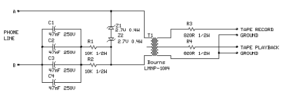

I need to record a certain upcoming telephone conversation and would like to have it record directly to my computer. I have all the nessecairy software to do so. What I need help with is the electrical aspect of the project. The only audio inputs I have on my computer (I don't know the size of the jacks) are the standard Microphone and Line In jacks located on most motherboards. To build this device, can I just hook the two audio wire on a telephone to whatever size jack is needed or do I have to build a circuit for this?

You need to isolate the phone line from the PC input.
I did it by using an audio transformer (1 : 1) in series with a 1 uF 100 Volt polyester capacitor.
You shoulkd be able to recover a suitable transformer (and possibly a capacitor) from an old telephone answering machine.

The PC case (and all common GND inside) connected to neutral wire (earth). Grounding any wire of the phone line not allowed, and give extremly high noise (hum) and/or make to busy the line (depending from which wire grounded, tip or ring...).
So, the isolation definitely need, use a circuit as ljcox suggested.

The use of a microphone is certainly simple, but the voice quality may not be ideal. Also, the mic may pick up background noise.
Len
