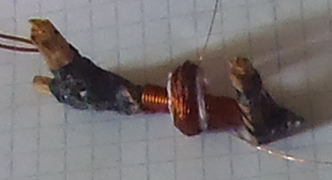

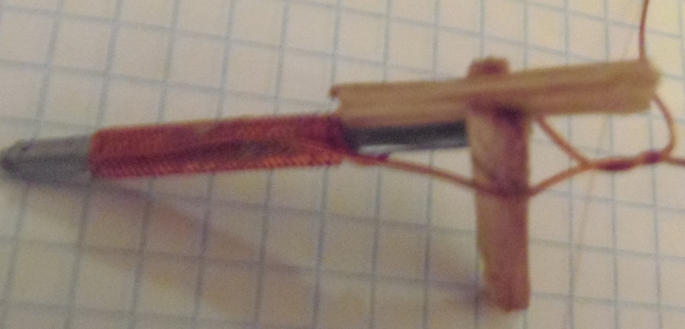

~ 30 turns of 0.5 mm wire are wound on an iron rod (2)
Wound one coil with 0.1mm wire, 100 turns (3)
Dual coil construction on frame (1)
The model does not work when current is applied (by design, the coils should have moved)
I hope the idea is clear. I wound it with a thin wire only because it was difficult to wind it with a thick one (0.5 mm). All this must be powered by a voltage of 3 Volts (stab.), And the engine will be made using plastic, epoxy, electrical steel and will resemble a factory

You might also think about doing a little simple maths - 100W at 3V will be over 35A - you also can't achieve 'any force' by using a lever, the power never changes (except from been lower due to losses).

The concept you are looking for is a "Voice coil linear motor".
There is no advantage I can see to using a wound field rather than permanent magnets? It's just going to take more power and produce heat; it will be very difficult to match the magnetic field strength available from neodymium magnets.
Pretty much all industrial servomotors etc. are now permanent magnet based, unless they need field weakening or are actually based on induction motors.
Note that some of the most fundamental principles are that the fixed magnetic field need polepieces both sides of the coil (inside and outside) and the air gaps between the coil and poles must be as small as possible.
Field strength is based on "ampere-turns"; eg. 100A in a ten turn coil gives the same field as 1A in a 1000 turn coil of the same size.
Hard drive head servos are good examples of linear voice coil systems, though they often use a "flattened out" version with a wide coil and two sets of magnets.
Thinking of that, a couple of hard drive head actuators could be what you need? People have done all sorts of stuff with those.

If you look at the drawings relating to that, it's just showing variations of normal solenoid actuators, not linear motors; it's a very different system.
I think the odd name is from the Chinese translation.
The pull strength of a solenoid falls with the square of the gap, eg. they can be very powerful if the movement is small, but very weak if the armature is too far out.
It's down to "air gap" again.
