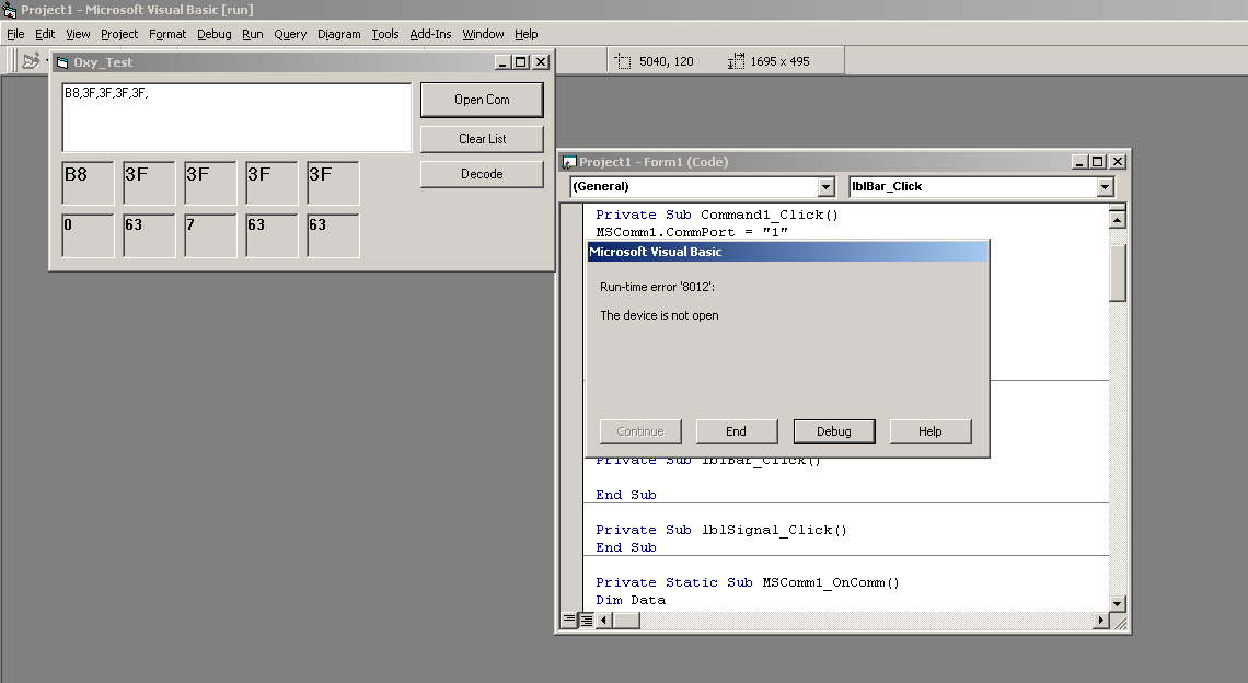

Ok,
i got freezing all the time when i open the comport ( but the input data shows in the TextBox ) and can't press any thing at all in the app !! till i unplug the device from the PC
then a message will appear ( normal msg about the device is not open ... )
at that time i only see the decoded of the bytes be in lables to show the data as u did
till now i am not sure about the data i need which are ( Pulse , Heart Rate ,, etc )
Thank u very much Eric
B8,3F,3F,3F,3F,
theses what i got in the text box
mm not appear in the labels till i unplug the device from the pc then show up
when i put my finger on the device to check the result will be like the following :
C0,3F,3F,3F,3F,
CA,3F,3F,3F,3F,
93,3F,3F,3F,3F,
95,3F,3F,3F,3F,
BE,3F,3F,3F,3F,
BD,3F,3F,3F,3F,
C9,3F,3F,3F,3F,
Notice that only the 1st byte changes

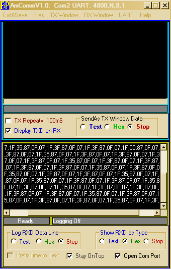

I think by checking with a known data pattern we will be able to confirm that the VB5 receive program is working as expected.
At the moment we are not 100% sure if its the oximeter, usb/rs232 or the vb5 program.:)
Attached two images, the AA image is the transmitting PC and the 000 image is the receiving PC, showing the data as valid.
also there is a repetitive hex file for transmit tests.

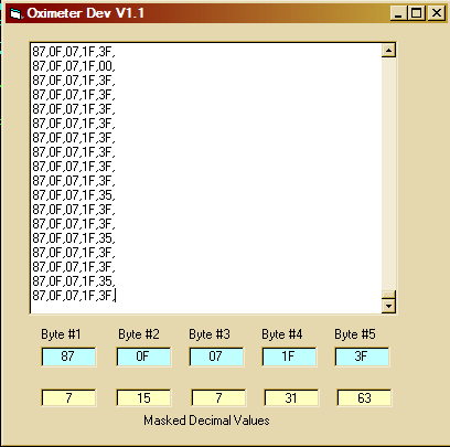

Changed the text box to a rich text box to allow longer file display.
This image is that test file hex being received, all OK
Note: I have made the byte 5 either 35 or 3F, so that you see the text changing.

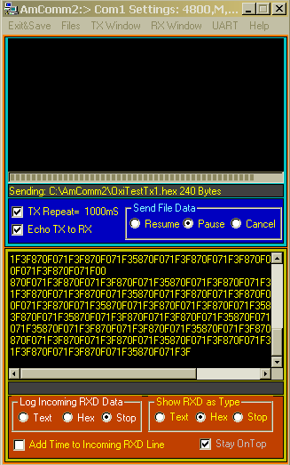

I dont believe there is a problem with my code, I have checked every which way without a problem.
The next step I would suggest is to download from the web a free PC comms program and use that connected to the Oximeter.
Let me know what you see.
free comms software - Pesquisa Google
Eric
BTW: do you have a model/type number for your Oximeter hardware.???
EDIT:
Using a free-ware RS232/UART data-logger program, I get this attached hex file, which confirms that my transmit and receive VB5's are OK.
Use a HEX viewer program to see the hex data.
