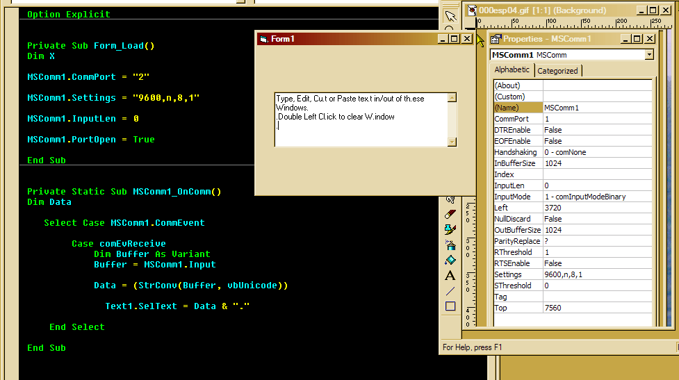

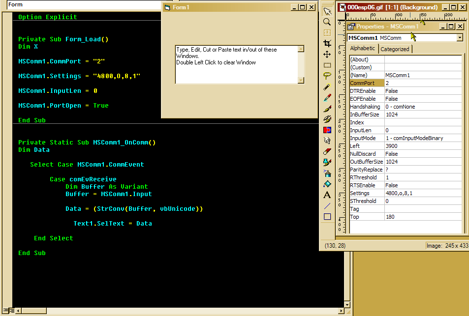

I have cut down down a bigger program for this clip, it does work as the image shows.
It receives in binary format so that you can get control codes if required.
Delete & "." after the data print, that was for the test.

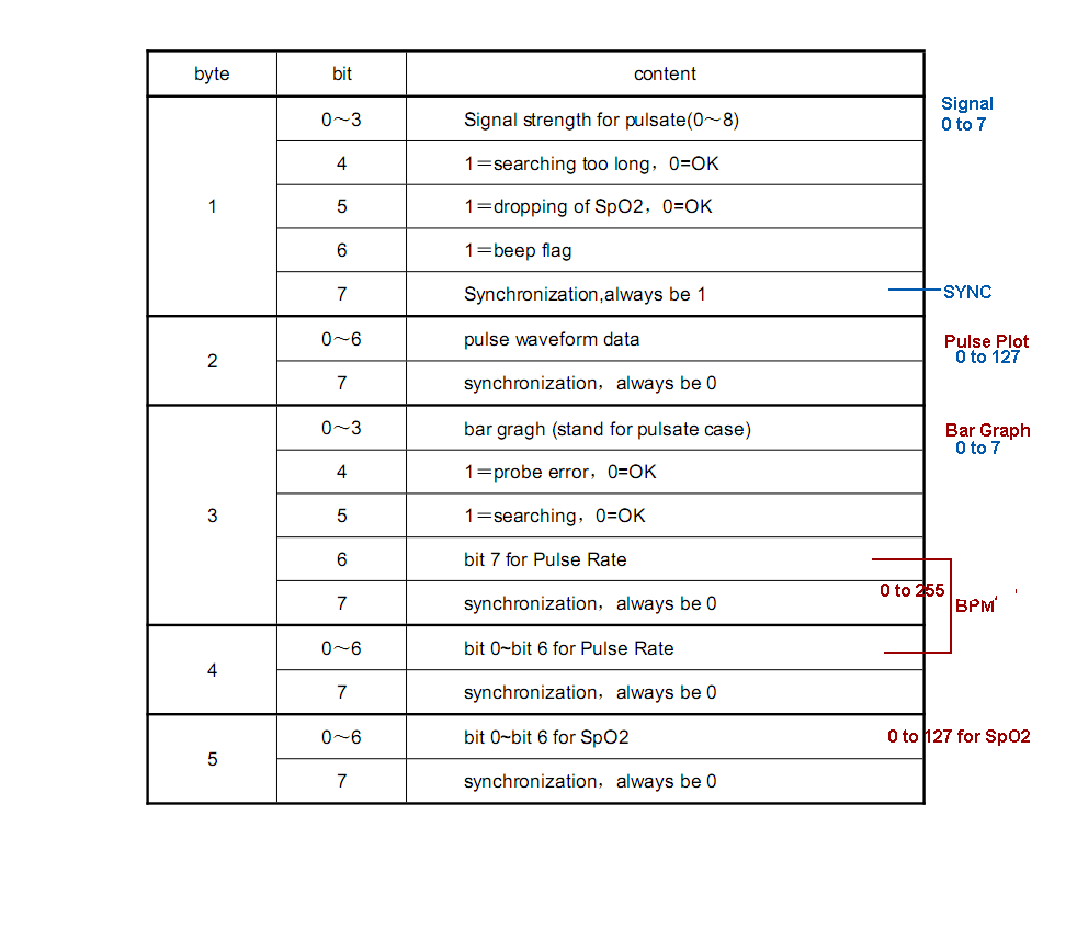

Checking that pdf shows that the data is not in ASCII format, so any characters printed will be nonsense.
Of the 5 bytes of data from the module, the individual bits of each byte have a 'meaning' assigned to them.
So you will have to capture the 5 bytes and then test each bit/s in turn and decode their meaning.
Can you do that OK.?
NOTE: Bit #7 of Byte #1 is the synchronisation bit, so you must test that bit in order to determine which byte is which.

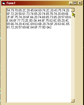

This program will display the output in HEX bytes with a 'comma' in between each byte. It does work.
You will then have to sample each bit as I stated earlier.

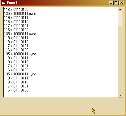

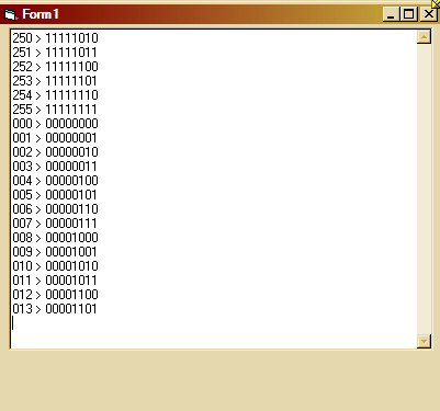

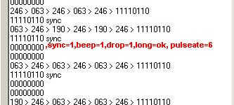

Added a simple subroutine to convert the received binary values to a Bit pattern.
You will have to test for Bit #7 in the string to determine the sync byte.
Image shows a test string print out,, data sent from another PC via the UARTs

EDIT:
Added 2nd image showing how to get the sync byte
Edit the code to.
'convert from 'decimal' byte value to 8 bit pattern
            Bin2BinStr Str(valchr)
              Text1.SelText = BitStr
              If Left$(BitStr, 1) = "1" Then
              Text1.SelText = " sync"
              End If
              Text1.SelText = vbCrLf

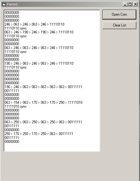

Thank you sooo much for giving me time to help :)
i really appreciate it
now i corrected the code and gave results like this ( see the image )
mmm i don't have a good experience with that :(
see what u can help me with ;)
is this correct data we should get according to the PDF ?
Thanks again
Thanks again
Making some progress.
Exactly what is the unit that sends that data supposed to do.???
From your answer I may be able to help you.
BTW: I know its an Oximeter.! but I need to the meaning of the UART data blocks.
EDIT:
From your data image I would say you are losing some data.
I would capture from the MSCOMM input, say 15 readings into an array and then convert to bits.

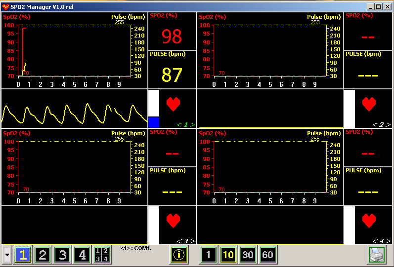

the data i should get is reading like this ( see the pic )
this app is the one i got with the Oximeter ( its actually usb but has a virtual com port which i connect to )
its working fine with the application but with my project not yet :)
all i got is the only app + protocol communication in PDF

Added some notes to the protocol, these values are the ones of most interest
