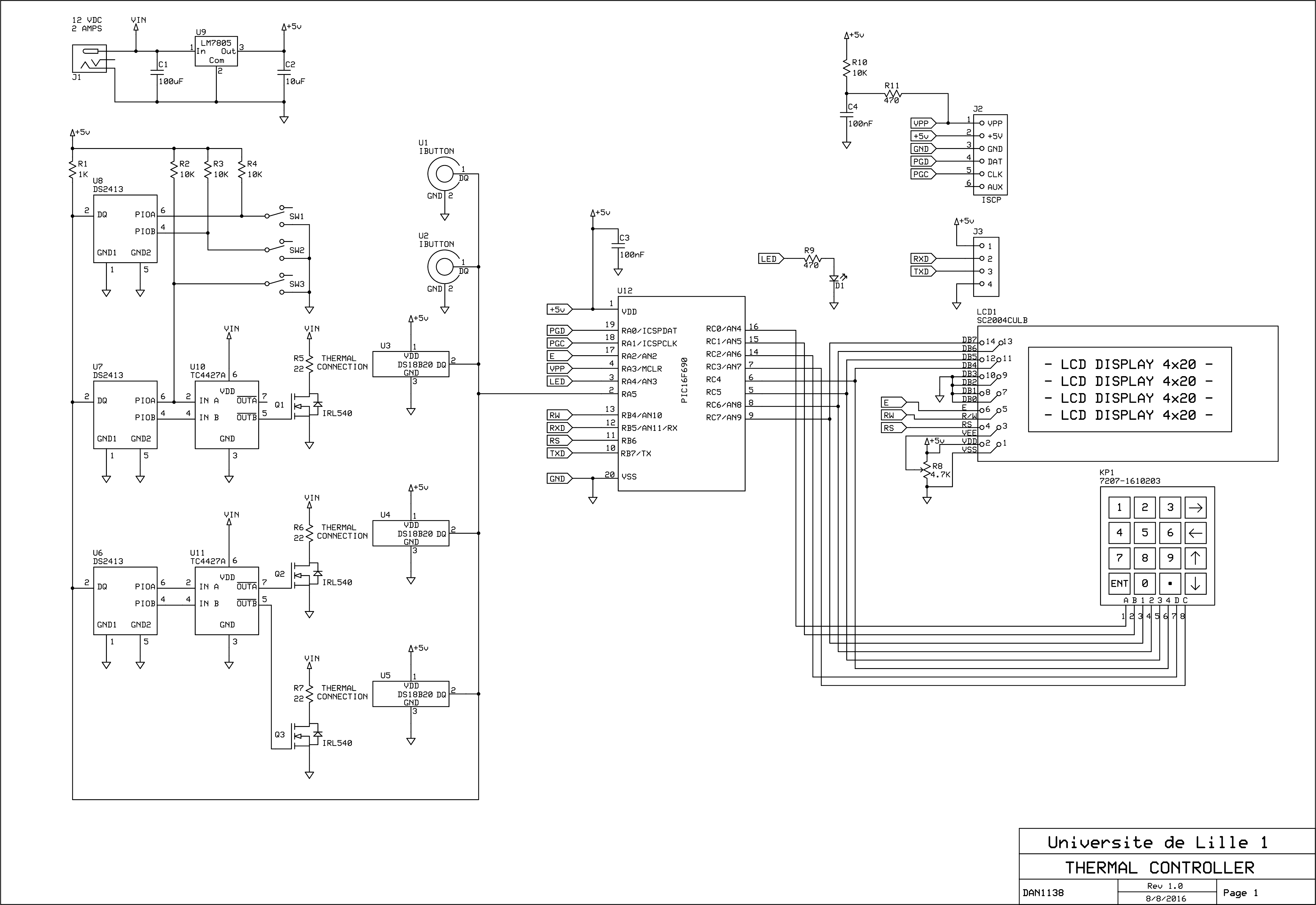

back to the 4 x 4 matrix. Looking at what I have on the schematic and only needing 8 pins for switch matrix, 6 for the LCD 2 pins for Vdd and grd maybe look at using an 18 or 28 pin pic.
Ordered 5 LCDs from China so need to stick with 5v chip, no K's allowed. Memory needed is to be determined after I get my code done and tested.

I hesitate to suggest this but someone with much more patience than me might be able to help you multiplex four of the keypad matrix lines with four of the LCD lines.
Cheerful regards, Mike
