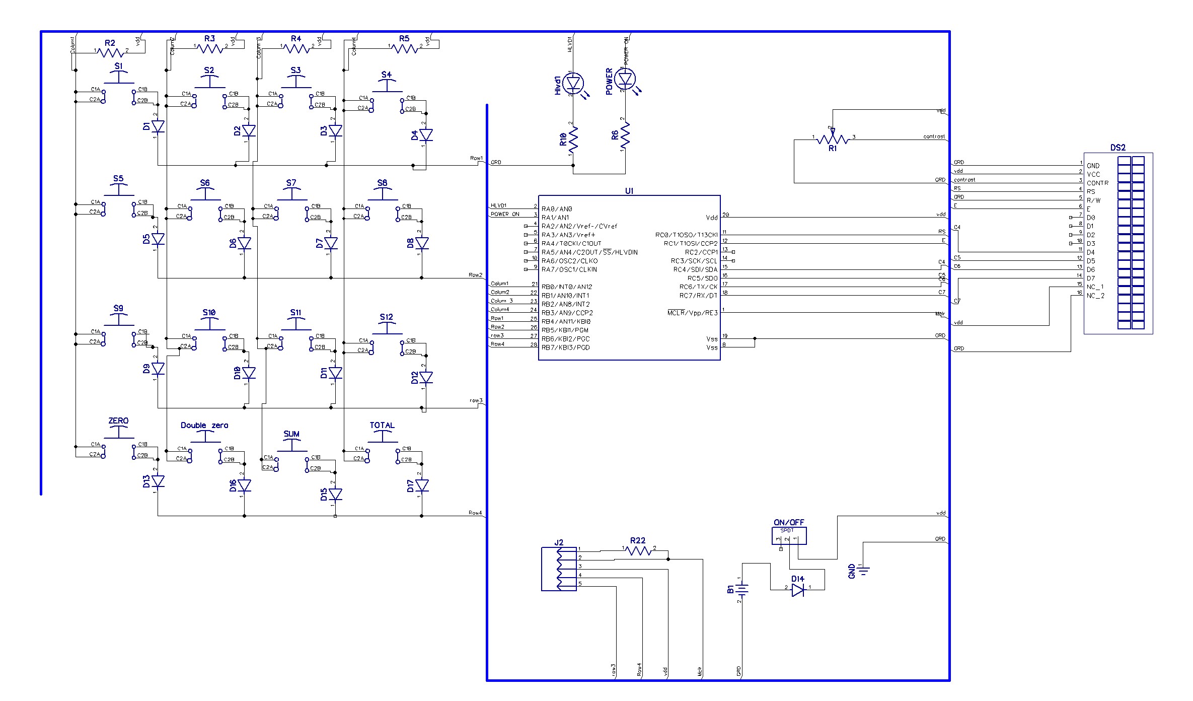

before I get to far off the beaten path, herView attachment 111357 e is my preliminary schematic.
Too late for that. Do you see anything in the keypad module about diodes? Any conment about anything besides pullup resistors? Has the word diode, rectifier or anything like that been mentioned here?
Wow, MrDEB actually got something right. Diodes do indeed stop ghosting (I call it cross talk).
How fast are these old folks going to be pounding on tbese keys adding up their domino scores?
MrDEB is great at grabbing bits and pieces from here and there...without understanding how things work or why. Instead of following through on one method he combines 5 or 10 methods without any understanding.
I only said he got something right - not that he understood it. If you pound on a keyboard lots, eventually you will manage to be right. 1000 monkeys etc.
