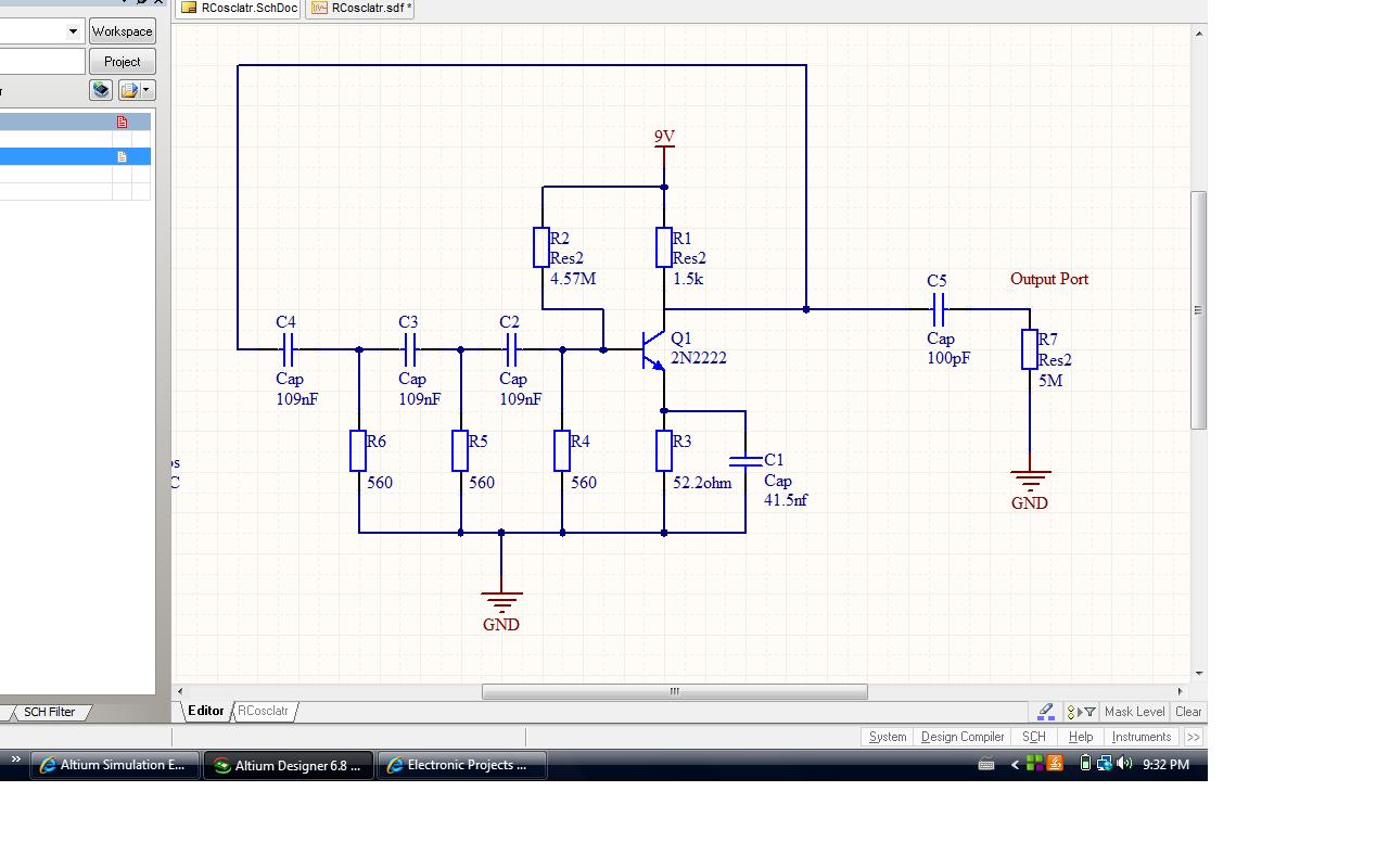

I need help with this RC oscillator i am trying to make .
its dead and i dont know where i am wrong .

What do you mean by "dead?" It won't simulate? Prototpe not working? Was it working and stopped???? Details are important.
Edit: R2 is pretty high. How did you arrive at that value?
Also, your amp had a gain of less than 3, which may not be enough to sustain oscillations. You may need a little more.
Bias resistor is way too high. It likely wont oscillate because gain is too low. Make R1 bigger, and C1 bigger.
Are you missing a junction dot between R1, Q1 and the output/feedback line?
Look at the values of R2 and R4. They turn off the transistor so it doesn't work.

Two things.
1
Each stage of phase-shift costs about a third of the power, maybe a little more.
The gain is insufficient, i recommend strapping another Tr across the existing one,
darlington fashion.
2
Also that four and a half megohms is too high. (As has been mentioned.)
Biassing.
Disconnect that train of caps, adjust till you get between 3 and 6 volts on the collector
of the output, then reconnect the train of caps.
Best of luck with it, John :)
Good point. Although it usually isn't shown on schematics, it might be a good idea, for your circuit, to capacitively couple the feedback network to your base. Alternatively, some oscillators connect the 3rd stage resistor to the base, rather than ground.
R2 should be connected to the collector. The 560R's should be about 22k. R1 should be about 4k7. If you follow the convention of putting the "k" between the figures, we won't have the problem of trying to work out what values you have used.

By "dead" i meant i made a prototype and i dont see anything on the oscilloscope !!!
i will give you feedback after adjusting some the R's and C's.

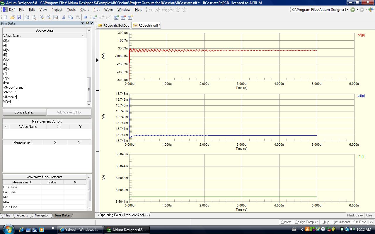

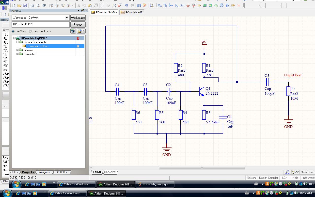

here is the new schematic and its results simulated in altium .
The missimg junction really helped , i wasnt able to simulate it first .
I wont alter the prototype as yet , once i get it running in simulation.
As the simulation shows oscillations die down after some time ???

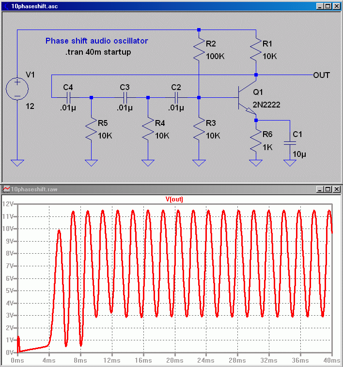

Insufficient gain. Gain of the amplifier stage MUST be > 29.
Look at this circuit provided as an example with the LTSpice download. Note the bias to the transistor. Note the emitter bypass.
Ok , but the supply is 12v , how do i translate the same %age of gain using 9V DC ??
i am a bit rusty on analogue design .
How to calculate the values of emitter bias and base bias Resistors??
