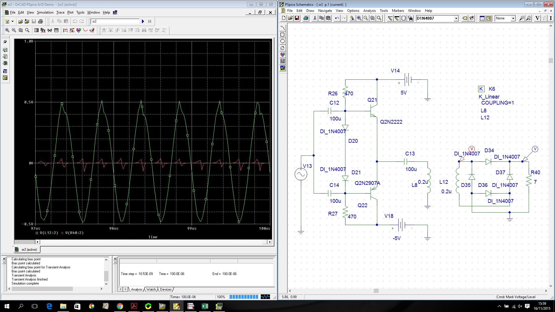

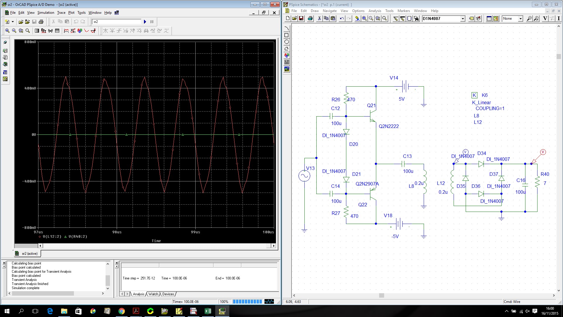

Hello again guys, so I'm having this problem on my simulation with the receiver. The rectifier is putting the voltage to 0V, I'll show you the image with and without filtering.
On the left is the results and on the right is the circuit. I know this is PSPICE and not LTSPICE as previously mentioned, but if this is a circuit problem.
The images are attached to this post.
Does anyone know why this happens?
Thank you once again.

What is the frequency?
1N4007 diodes do not work well at frequencies above a few 100Hz.
It look like the oscillator is running around 2MHz.
The small transistors cannot conduct enough current. Also they have no driver transistor.
Your schematic does not show the level of the input signal of V13 to the transmitter. It is a level that is MUCH too low since the transistors are emitter-followers with no voltage gain.
Your schematic also does not show where the 'scope is measuring.
The coils appear to be simply wire with no iron core.
I believe the test point are indicated by the Small circle with the letter V inside. <---(V)
Then I see that the signal level is too low even for good high frequency rectifier diodes.
I wonder what is the transmitter signal level?
