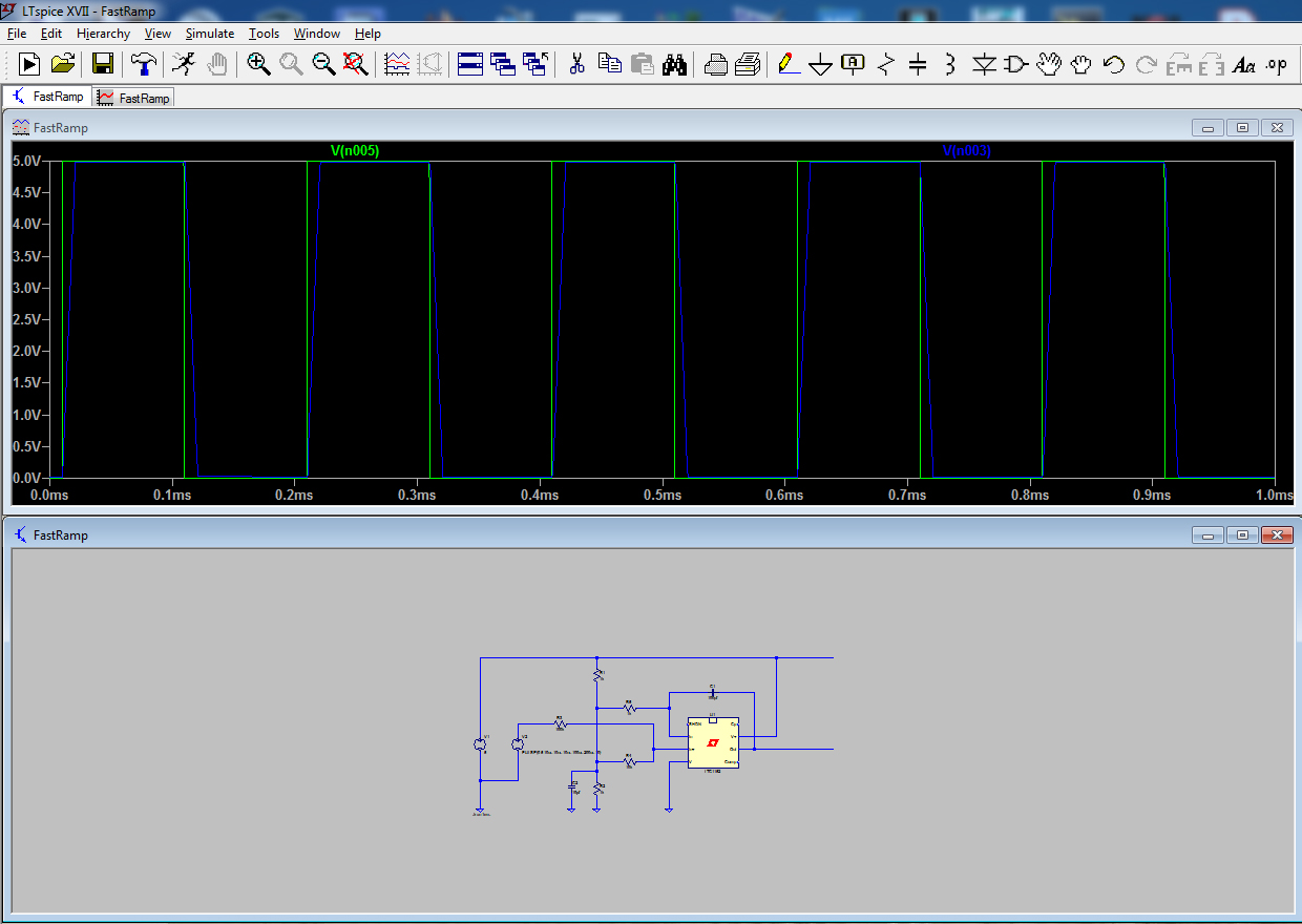

How about this - just a fast rail to rail opamp working as an integrator.
It gives a linear ramp between 0V and the positive supply, you can divide that to whatever level you need.
The voltage divider that sets the input bias should be adjusted for the mid voltage of the logic signal that switches it.
The ramp speed is adjusted by the integrator capacitor and resistor, and/or the voltage swing on the opamp + input by changing the input divider ratio. It's 10:1 as shown, using 5:1 would half the ramp time (subject to the opamp speed).
