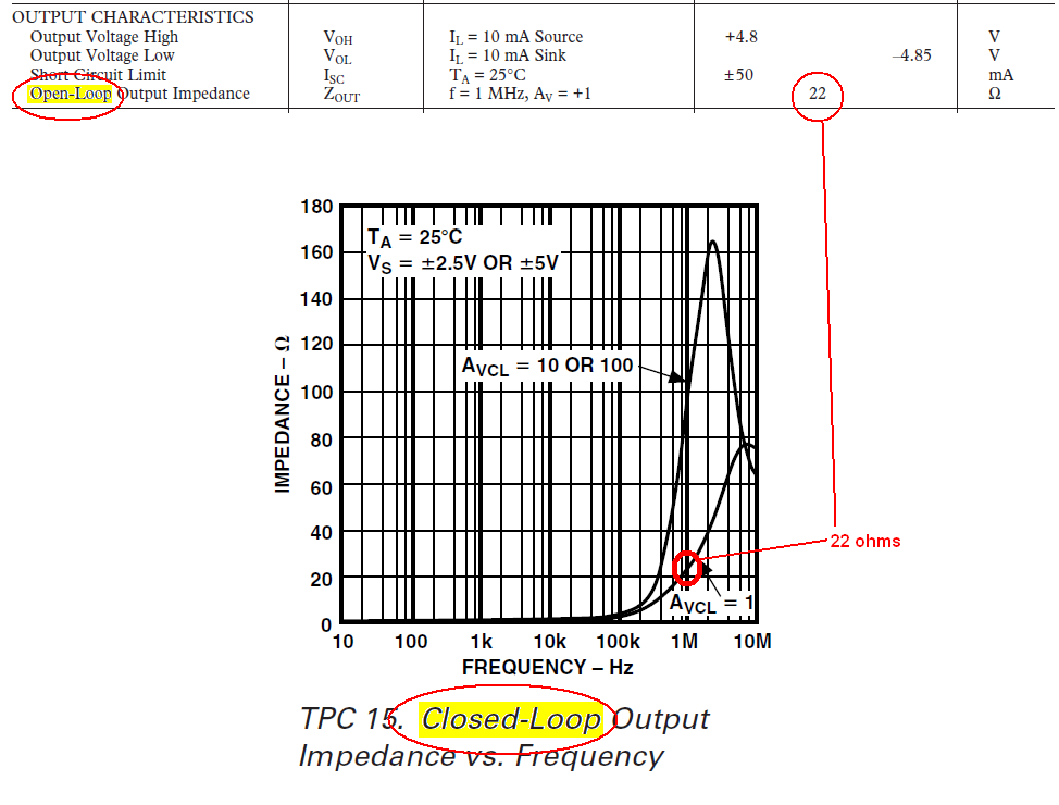

I have problem about Rail-to-Rail op-amp.Rail to Rail op-amp use common emitter in it's output stage. Common emitter has high output resistance(collector).I do not understand why rail to rail op-amp(OP279) has low output resistance ,although it's output stage use common emitter.In datasheet (OP279) expressed output resistance is 22 ohms.It is very low output resistance.Please tell me,it is why? :confused:

The reason is negative feedback. Notice that they spec it at 1 Mhz and an Av (gain) of one. It'll be much lower at DC with Av = 1. See chart TPC 15 in datasheet.
The output impedance is 22 ohms only when it has a lot of negative feedback to make its gain only 1. The negative feedback is a high amount only at low frequencies and makes the output impedance much lower.
Figure 15 on the datasheet shows that at 1MHz the output impedance is 22 ohms when the gain is 1 but the output impedance is 100 ohms when the gain is 10 and 100 (because then the negative feedback is reduced).
The output impedance is close to zero ohms (when the gain is 1) at frequencies below 100kHz.

I think the confusion may result from an error in the datasheet. See attached.
The impedance is obviously closed loop.
I agree. The bit that says, "Av = +1" is not open loop either.
