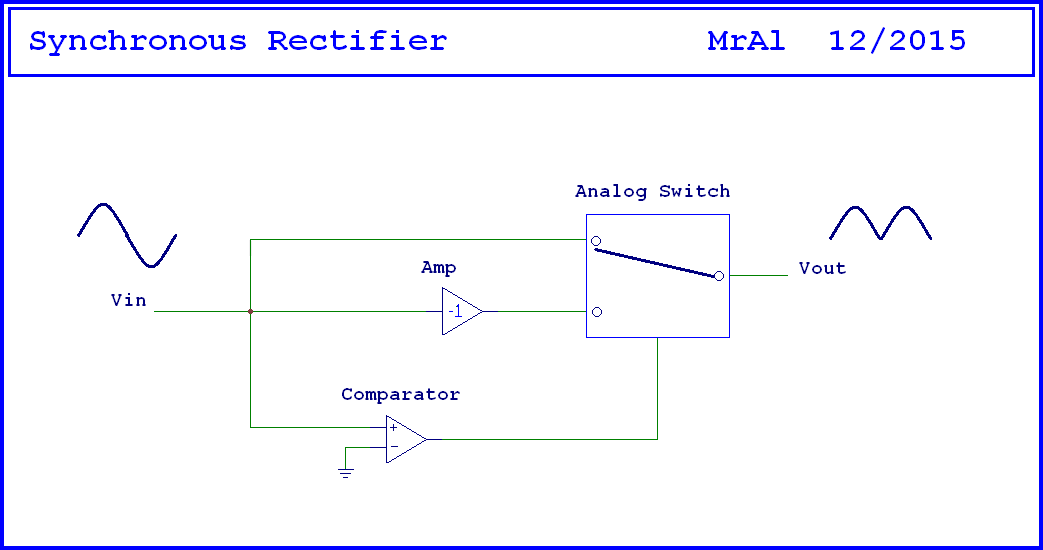

To rectify it synchronously, one idea would go like this...
First, an op amp to invert the signal. That gives you a two phase signal, phase A and phase B, where the two signals are 180 degrees out of phase.
Next, use a very fast comparator to detect when the input signal is positive. The output of the comparator controls the single-pole-double-throw analog switch, switching phase A to the very output when the input is positive, and when the input goes negative it switches phase B to the output. Since phase B is inverted and gets switched to the output during the input phase of 180 to 360 degrees, the output is therefore always positive.
This technique also keeps the op amp(s) always working in their linear range so the output will be clean except for a tiny transition period around the zero crossings of the output.

For the input signal from 0 to 180 the non inverted signal (which may be just the input signal itself) gets switched to the output, and during the input signal phase 180 to 360 the inverted signal is switched to the output. The output will therefore be a full wave rectified sine.

I am using pic24 mplab starter kit for ADC. Your idea about sync rectifier was good, but I could not understand it. Are there any circuits available that I can try and understand?

Ok then that wont be fast enough so you'll also need to filter the output with at least a resistor and capacitor. That will give you the average from which you can calculate the peak value provided you always have a sine wave input.
Here is a block diagram (not showing the filter)...

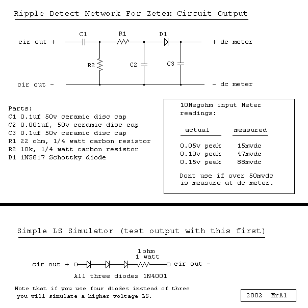

We used a peak detector like that to test for ripple on the output of a Zetex 300 or 310 LED driver chip way back when the Zetex chips just came out around year 2002. I cant believe that was some 14 years ago already.
The attachment shows that circuit, although it was tailored to fit the application with an added high frequency filter to filter out the short duration peaks but keep the main bulk of the 300kHz ripple peaks. Of course removing the filter and using a signal diode would be better.
The main point is though that there is some calibration required, using a scope. The one in the diagram was calibrated using a scope. If the signal shape is known then the output can be correlated to the input, and for sine waves this should not be too hard to do by measuring several points and then extrapolating between points.

I think the output cap voltage will 'pump' up to the input to some degree because there is a rectifier so it is not 'just' about the voltage divider ratio of cap values, however some calibration would be required because there will still be loss in the diode(s). How much loss would have to be compared to the scope measurements and may or may not affect the overall measurement if the input signal is large. The ratio of caps does seem pretty large however, that seems a little too extreme.
