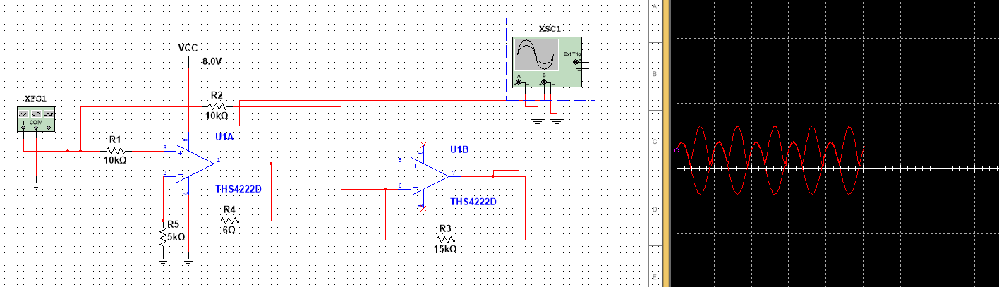

I am a student trying to design a rail to rail DC Rectifier with input of 8 MHz. I know that I require an OPAMP with a high GBW and high slew rate but I a not able to find a correct one can someone please look in this matter

I am trying to sample a sine wave with 5-8 MHz. I tried with LM6142 but it didn't work at higher frequencies. My circuit was simple, a voltage follower followed by an inverting amplifier. i am looking for slew rate of greater than 520V/us to get 10Vpp at 8MHz. Thanks for the positive replies. Hope to get som more guidance form you all

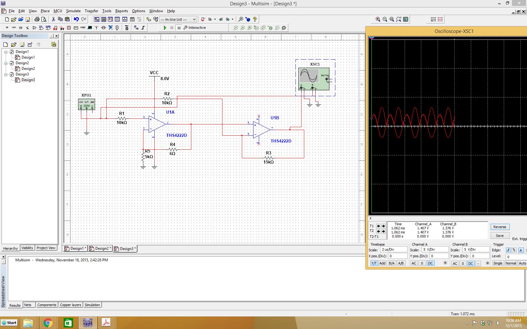

Thanks again Ron. I tried the ckt with THS4221-22, but its not giving the result I need. I have attached the ckt diagram. can you please look it for me and tell me whether its correct

Make R3 and R2 the same value. (10k)
You have other problems but first make the inverting circuit have a gain of -1. not -1.5
I think 10K is too high for high speed. The capacitance (input, output, board, etc) and the 10k makes a RC low pass filter. At 8mhz I would try 1k.
What you are doing requires a R-R input and R-R output and I was only looking for R-R output. So some of the op-amps I picked probably will not work.

See he almost got it. The problem is: the gain(s) are not equal. +1 and -1.5

It is hard to tell what is the output and what is the input in that 'scope' drawing because the waves are superimposed on each other. It would also be a good idea to show what the input is, and what the output voltages are and times.
Also, even if it does appear to work that doesnt mean that will work using real op amps anyway. That's because many op amps do not like to be driven from open loop back into closed loop again without a significant delay. This is one of those op amp aspects that you NEVER see talked about on web sites. What this means is that it may not work at all or it just might introduce some distortion. In any case, real life testing would be mandatory before settling on a particular design.
But assuming it does work or it can be modified slightly to get it to work, how does he intend to filter the output? With the op amp driving the output directly an inductor and capacitor would probably be needed to filter it into DC, rather than just the usual capacitor.

yes I tried the op amps. Didn't worked. I found this : **broken link removed**. but not sure of its working. Can you explain
Hi again,
They are working at 500kHz in that paper, and may be mentioning the delay i was talking about.
But did you first take Ron's advice and change the gain to fix the basic design flaw first?
