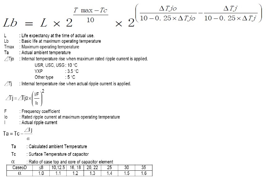

Hello,
Long post, but please only skim read and I beg you to shovel any answer you think may have any relevance whatsoever (even if it doesn’t) , to this horrendous subject of pinning down the actual lifetime of radial leaded electrolytic capacitors………
Our investors want us to write them a report on the lifetime of “Wet” Aluminium Electrolytic Capacitors in our product. (60W offline flyback, 110-265VAC input)
The electroytic capacitor we are using is the Acon KL series 400V, 100uF one. (as attached)
This is the capacitor that our Chinese designers put in our product. (Post rectifier capacitor)
The Chinese designers sent us the attached lifetime calculation for this capacitor.
The strange thing is, in this formula, if one decreases the ripple current value flowing in the capacitor, then the lifetime decreases!!!....
(This is from one of the bigegst SMPS designers in China...they make SMPS for most of the western world.)
….This can’t be right, does anyone know what’s gone wrong here? And is there any other formulae for radial leaded electrolytic capacitors lifetime?
As you can see, the Chinese capacitor lifetime equation lists a parameter called “delta(Tj0)”…
This parameter is the “internal temperature rise when rated ripple current is applied”.
Strangely, they don’t tell us what this value [“delta(Tj0)”] is for the Acon KL series capacitor…..instead, their lifetime equation simply gives “delta(Tj0)” values for the Rubycon USR, USC & USG series capacitors. –But that’s not what we are using, so why do they state it?
Also, another parameter used in the attached lifetime equation is called “alpha”. It is the “ratio of the case top and core of the capacitor element”. From the attached lifetime exerpt, you can see that the lower the diameter of the capacitor body, the greater the temperature of the capacitor case gets. Is this typical for other electrolytic capacitors too?...it doesn’t seem to make sense…..because surely the deciding factor is how long the capacitor body is?....that is, longer body capacitors would run hotter as its further from the internals to the base…the base being where most heat transfers out of the capacitor?
Anyway, why does our Chinese designers lifetime equation give a lower lifetime when the capacitor has less ripple current in it? Have I missed something?
Also, why does no radial electrolytic capacitor manufacturer give thermal resistance values from internal core to the case for their capacitors?..it is impossible to actually do a lifetime calculation without this information.

The main equation has got L, the lifetime, and Lb, the basic lifetime, the wrong way round. The other equations look to me as though they work the correct way, but one is written the opposite way round from what looks logical to me, even though it is mathematically correct.
Also the explanations of some of the temperature terms are misleading.
And there is a ΔIj that seems to make sense if it is ΔTj
The equation for the temperature rise due to ripple current is ΔTj = ΔTj0 x (I/F/I0)^2
which seems quite straight forward. ΔTj0, the rated temperature rise, is quoted for the different capacitor types, as is I0, the rated ripple current and F, the factor for the frequency of the ripple. That also makes sense that the temperature rise is proportional to the square of the ripple current.
ΔTj is then used in Ta = Tc - ΔTj/α
For this to work, you have to assume that they mean ΔTj not the ΔIj that it looks like on the image. As neither Ij nor ΔIj are used anywhere else, I think that ΔTj, which was calculated in the line above is what is meant.
Then Ta is defined as "Calculated Ambient Temperature", but further up the page it is "Actual Ambient Temperature", and it is only used in this one place. I think it means "Ambient Temperature" and whether you measure it or calculate it for your application, it is an input to the capacitor life calculation, not an output.
Tc is defined as "Surface temperature of capacitor", and it is used in the equation at the top of the page. That is the output of Ta = Tc - ΔTj/α, and I have no idea why they wrote it that way round. Writing it the obvious way round (to my way of thinking) it becomes:-
Tc = Ta + ΔTj/α
which also makes sense, in that the surface temperature you need to calculate for the other equations comes from the ambient temperature plus a factor proportional to the square of the ripple current, and inversely proportional to "α", which gets slightly larger with larger capacitors.
I don't quite see why doubling the ripple current would only increase the temperature rise by a factor of 4/1.6 = 2.5 on a 35 mm diameter capacitor, but by a factor of 4 on a 10 mm capacitor, but it's their call. All of these temperature rises are based on their starting values of ΔTj0, so I would assume that they know what they are talking about.
When you have Tc and ΔTj, you can put them into the equation at the top, along with Tmax and ΔTj0.
They have got Lb and L the wrong way round. If you have a look at **broken link removed** that shows a similar equation for temperature, but with a different way of dealing with the self-heating. That show the correct way round, as it is obvious that the life will increase with decreasing temperature. If it went the other way, those capacitors would have a life of less than a day at 20 °C and no ripple, so they would be dead before you got them.
Neither the formula you showed nor the one in the link have a term for supply voltage. I have seen voltage terms where the life is inversely proportional to voltage, so near infinite at 0 V, and another where the life is linearly related to voltage, and about 2.5 times at half voltage and 4 times at zero voltage. I would have expected some life increase at reduced voltage.

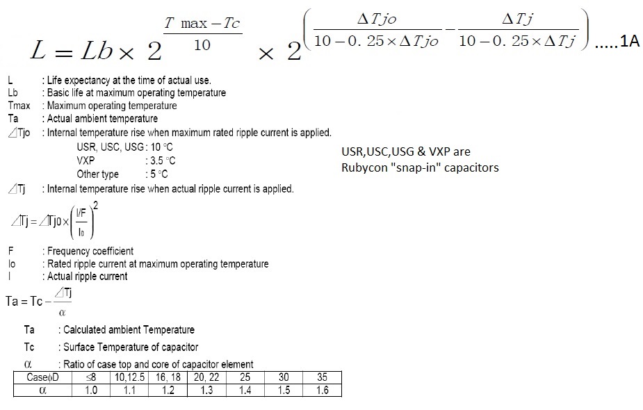

Thanks very much Diver300, you're right, they got "L" and "Lb" the wrong way round.
Diver300 you are fab!
You have corrected everything here.
The only thing about the equation is that they have used "2^[(Tmax - Tc)/10]", instead of the term that most other manufacturers use , which is "2^[(Tmax - Ta)/10]"
where...
Ta = ambinet temperature
Tc = Case surface temperature
Tmax = Max allowable ambient temperature (when max rated ripple is flowing).
Do you know which version of this expression is correct?
Also , they have not said how they calculate "delta_Tj0", this is the internal temp rise when rated ripple current is flowing.
Do you know how they calculate "delta_Tj0"?
Also, if i put in 0.001A for ripple current in your kindly corrected equation, (at 85degC ambient) then i get a lifetime of just 3.4 years....this seems a bit low for a capacitor with virtually no ripple current in it. Can this be right?
The ripple current term is the least important. I have no idea whether that is right or not, as it has far less effect than the temperature component. The mistake was obvious because both corrections were in the wrong direction.
Tc and Ta will not be far apart. I don't know why this formula adds a bit to Tc and has another term using ΔTj as well. Also the calculation uses 3 different base valued for temperature rise (10, 5 and 3.5 °C) instead of a thermal resistance. I don't know why, but I doubt it makes any real difference compared to other ripple current corrections.
3.4 years at 85 °C sounds about right. Temperature has the biggest effect on the life, and no ripple current just means no extra heating, but with an ambient of 85 °C, that is hot enough already.

Hello,
woops , corrected second term of lifetime equation attached
Also, the Electrolytic capacitor lifetime equation in post #1 above is from a document that concerns the Akon KL series Radial Electrolytic capacitor. So therefore, why , in the exerpt shown in post #1, do they give “delta_Tj0” example figures from the Rubycon "snap-in" series capacitors? (USR, USG, USC & VXP)
"Snap-in" capacitors endure far less internal temperature rise than Radial Electrolytics, so therefore why have they not given temperature rise figures for Radial Electrolytics?.......After all, in the SMPS that they designed for us, they put in a Radial Electrolytic, ...the Akon KL series.
As you know, “delta_Tj0” is the internal temperature rise of the capacitor which happens when rated ripple current is flowing in the capacitor.

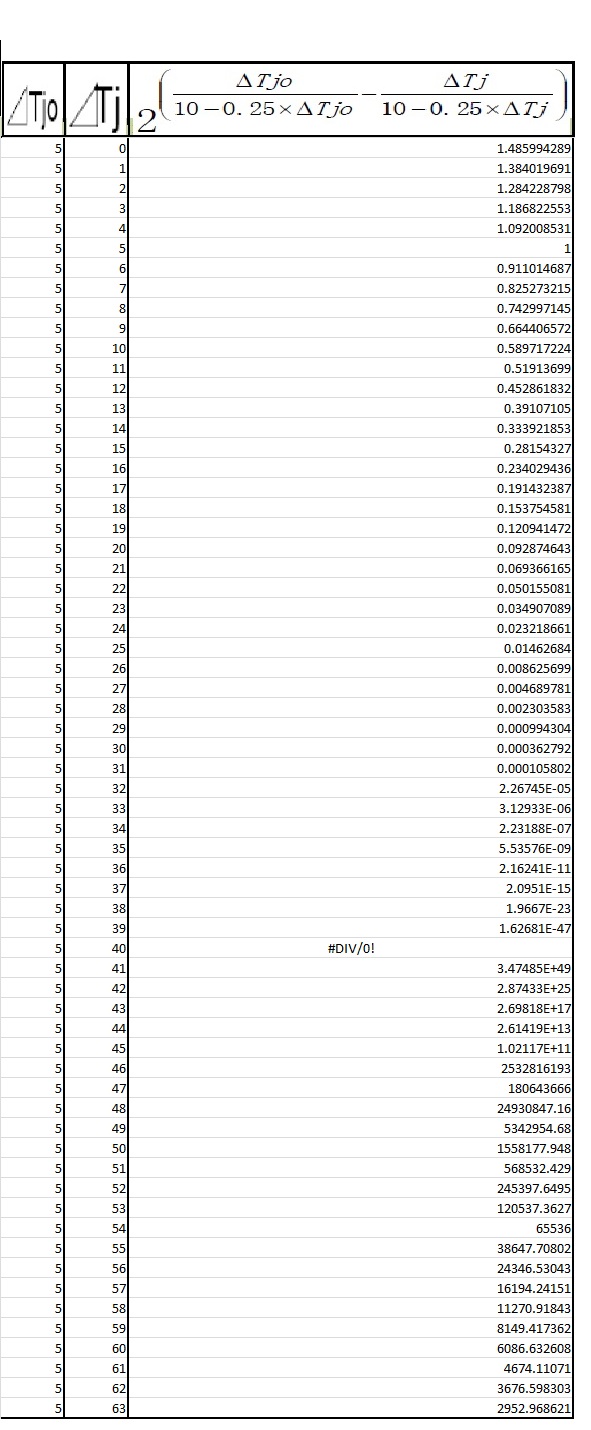

Hello,
This is related to the above so please may i put it here if its ok, though it is a separate new post
Attached is the equation for electrolytic capacitor lifetime.
It was provided to us by our Chinese SMPS designer.
According to this equation, as delta_Tj0 increases, so too does lifetime.
That doesn’t make sense…..if the internals were getting hotter, then lifetime should get less.
Can you say that this equation is incorrect?

Hello,
The point about ΔTj0 is that it is the baseline that the capacitor is rated at. It can't be changed by changing how the capacitor is run. What changes is ΔTj if the capacitor is subjected to different conditions. The explanation on the equation says:-
"ΔTj0 : Internal temperature rise when maximum rated ripple current is applied."
So the Acon 100 μF, 400 V capacitor lifetime is rated at 5000 hours at 105 °C and 610 mA ripple at 120 Hz
The ripple current term is 2^(ΔTj0/(10-0.25*ΔTj0)-ΔTj/(10-0.25*ΔTj)).
ΔTj is calculated as ΔTj0 * (I / F / I0)^2
I think that ΔTj0 is 10 °C
If the ripple current were half as much, 305 mA, and the frequency is still 120 Hz, then ΔTj would be 2.5 °C
ΔTj0/(10-0.25*ΔTj0) is 10/7.5 = 1.33333
and ΔTj/(10-0.25*ΔTj)) is 2.5/9.375 = 0.266666
so ΔTj0/(10-0.25*ΔTj0)-ΔTj/(10-0.25*ΔTj) is 1.3333 - 0.266666 = 1.066666
and 2^(ΔTj0/(10-0.25*ΔTj0)-ΔTj/(10-0.25*ΔTj)) is 2^1.066666 = 2.095
So halving the ripple current increases the life by just over 2 times.

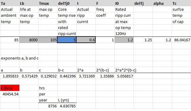

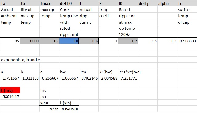

Thanks, the thing is, supposing you have two electrolytic caps which are basically the same, except one has 10 degrees internal temp rise with full rated ripple, and the other has 5 degrees temp rise with full rated ripple current…...
……well then you would expect the one with just 5 degrees temp rise to be longer lasting….but that does not happen…..the attached excel sheets proove this…..if you put in the lower temp rise in the blue square you see the lifetime decrease, which doesnt make sense.
I think the equation is wrong. Surely?
The attached exel uses the equation given in post #13...you can see from the blue and red squares in the attached here.
No, I wouldn't.
The one with the 10 ° rise is rated to the 8000 hours with that 10 ° rise, so it is effectively rated to run at 95 °C internally for 8000 hour. When you halve the ripple current, the temperature rise is 1/4 as much, so the internal temperature is around 87.5 °C, or 7.5 ° cooler than its rating.
The one with the 5 ° rise is rated to the 8000 hours with that 5 ° rise, so 90 °C internally for 8000 hour. When you halve the ripple current, the temperature rise is 1/4 as much, so the internal temperature is around 86.25 °C, or 3.75 ° cooler than its rating.
So the one that has the larger temperature margin below its rating will last longest. The one with a 5 ° rise has been made less tolerant of temperature, because a lower temperature is expected.
