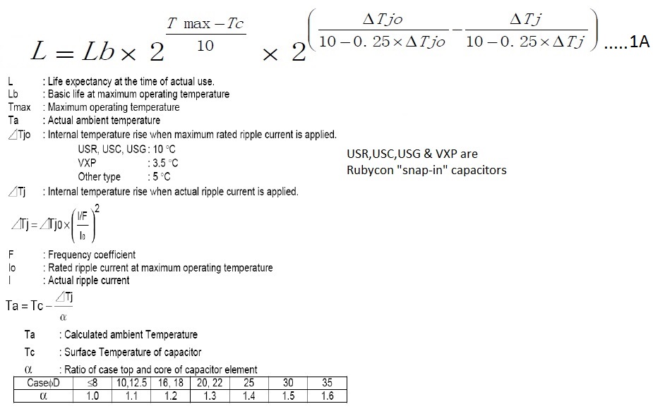

Thanks, the thing is , why is it that no Radial electolytic capacitor datasheet actually gives the internal temperature rise of the capacitor when it has rated ripple current flowing in it?......without this information, it is absolutely impossible to do a proper lifetime calculation....unless you are lucky enough to get one of those capacitors with a thermocouple built into it..or the capacitor datasheet gives you the Heat radiation factor of the capacitor, so that you can work out the internal temperature rise from the case temperature rise.....but again, that data is never in the datasheet.
Just imagine if a power fet datasheet didnt tell you the theta(jc).....it would be ridiculous.
Is this all about industrial secrecy or something i wonder?

Thanks, the formula for electrolytic capacitor lifetime calculation is attached, and there is never enough data in the datasheet to satisfy this equation. Certainly not for radial electrolytics.
(BTW thankyou very much for correcting this equation earlier)

The way i always do it (lifetime calculation) is to assume a value of alpha as in the exerpt already shown.
Alpha is the ratio of internal temperature rise to top surface temp rise.
You can measure top surface temp rise, and then with the assumed value of alpha, you calculate internal temp rise...then from that you can calculate the internal temp rise with rated ripple current.
But this assumes a value for alpha....which is usually said to be a value of about 1.2 for 18mm diameter radial electrolytics.
