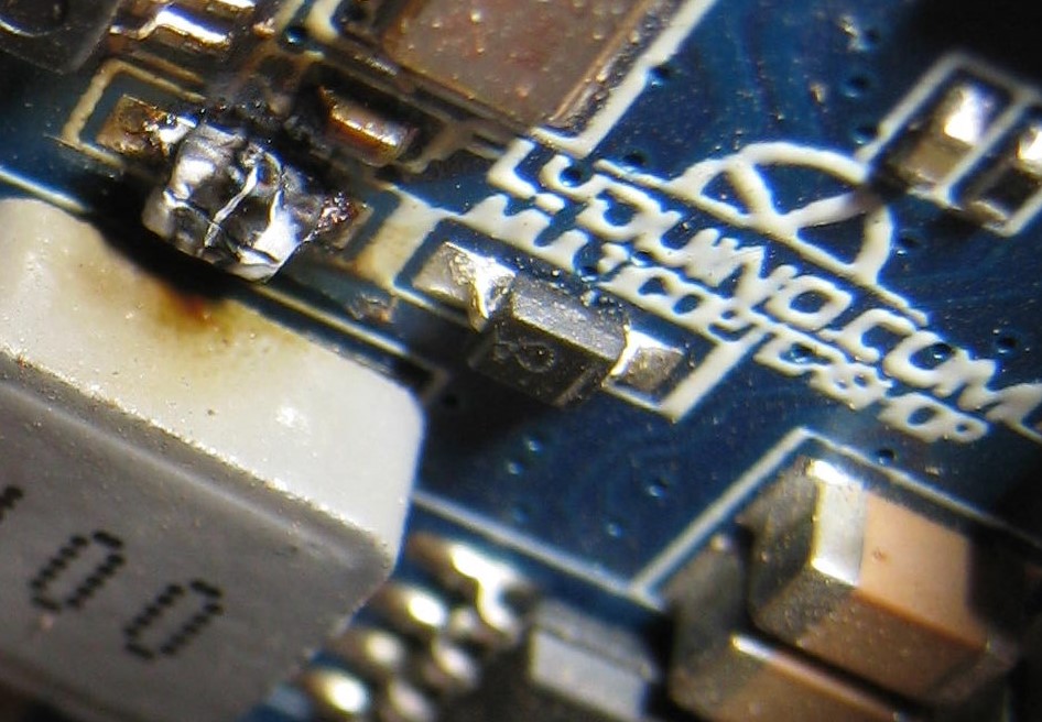

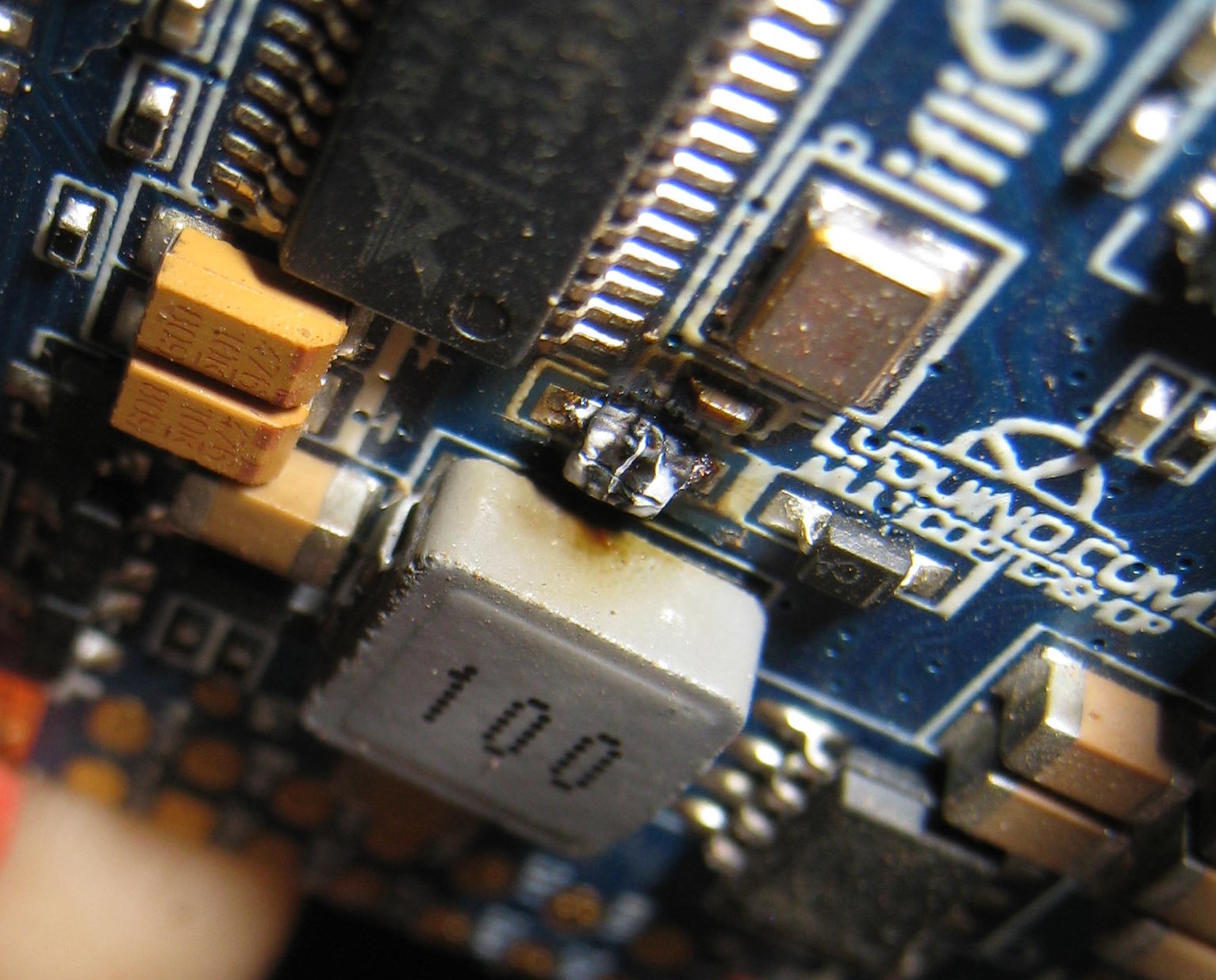

Hi Everyone, I have a SMD component I'm trying to ID so I can repair my F3 flight controller. Markings are "CA" with a (polarized line?), I thought it was a Case "A" polarized tantalum black chip capacitor 16 Volt but the length of those caps are 3.2mm long and this one I fried is around or under 2mm.
I contacted the company and they told me it's a resistor......I've never seen a resistor that's looks like this.
In the pic, the fried component is the exact same as the one next to it.
Thanks,

It looks like a diode, the white bar at one end indicating the cathode.
Looking at this database:
https://www.sphere.bc.ca/download/smd-codebook.pdf
The most likely candidate is a ZMV829B varicap diode.
Whether a varicap diode makes sense in that part of the circuit, I do not know, but they are sometimes found in series connected pairs, as shown in your picture.
Another thing to consider is, what caused it to overheat like that?
Varicap diodes are usually found in low power areas of circuitry, most unlikely to overheat like that.
So, whether it really is a varicap, I am not sure.

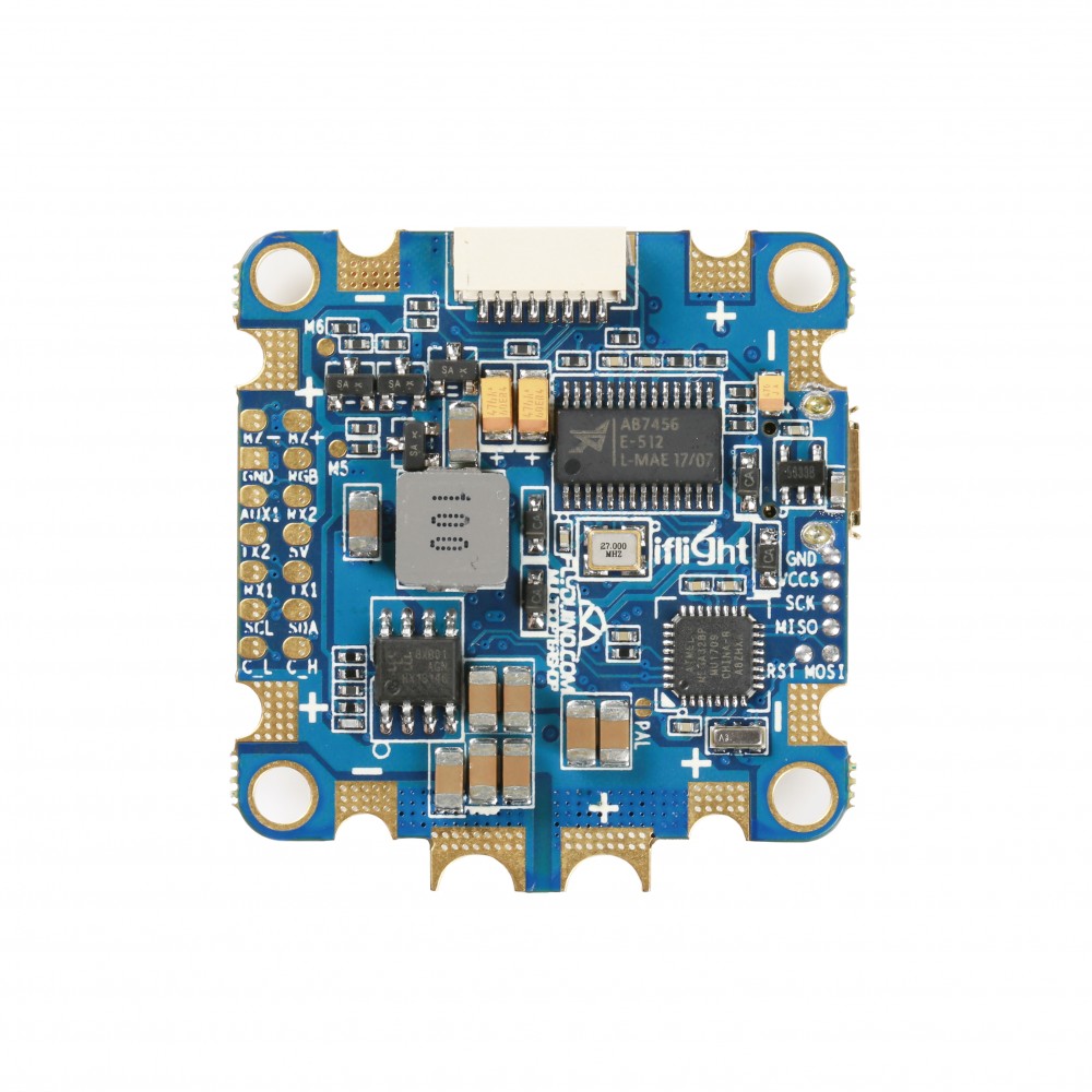

Cool Jim thanks a bunch!!!! Its was a short circuit caused by me, in a rush to fly cuz sun was going down and forgot to inspect for solder splatter...... After I fried that component I was able to power up the board through a USB port we have on them but it wouldn't power up from the Lipo flight battery.

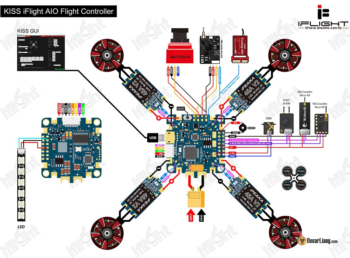

Here some pics of the board and how we wire them up if anybody is interested.
(From one of these pics you can see another pair of those components also on the board)

Looking at the boards I'd guess they are just rectifier diodes for power routing, depending on what power source is in use.
I've found a schottky diode listed in one SMB codebook that has the CA marking.
Ideally you need to test an undamaged "CA" device with a multimeter to confirm it is a diode & see what the forward voltage drop is.
Looking at the damage to the diode, I think that it is more likely to be a Schottky diode in a power circuit than a varicap diode in a high frequency circuit.
Looks like it's a Zetex or Diode Incorporated ZMV829B

Although that was my initial wild guess, I am more inclined to agree with rjenkinsgb that this is a schottky diode. I suggest that you do not pursue the ZMV829B as that is a varicap diode. A completely different animal.
What was the part number of that diode?
The one I found was SD883-02, a 20V 3A schottky.
It appears that part is made by multiple different manufacturers; I've not found one with the exact same ID mark and orientation, but it could be a generic copy in those boards.

Assuming it is a schottky diode then the nearest I could find that fits your dimensions (outline SOD323F - does this seem right?) is the PMEG1030EJ available from Farnel. This is only a 10V device - what voltages are used by the board?
The best one listed that can handle 24V (30V) is the PMEG3015EJ but that can only handle 1.5A. Is there anyway to measure the amps flowing?
BYW, from your picture it looks like a bigger diode could be fitted - maybe look for a 40V 3A diode in a slightly bigger package.
I believe it's less than one amp to power up the board.....
And yes it does look like I could fit a bigger case size, I totally didn't think of that, my brain was stuck on finding exact match.

I got the diode you found;
PMEG3015EJ,115
1727-3872-1-ND
DIODE SCHOTTKY 30V 1.5A SOD323F
Got three from "Digi-key" for $.45 each. Got them at my door in a few days for around $5 total. Cheaper shipping than Mouser...
Thanks Mike and Electro-tech-online and it's members, couldn't have done this on my own!!!!:happy::happy::happy:
