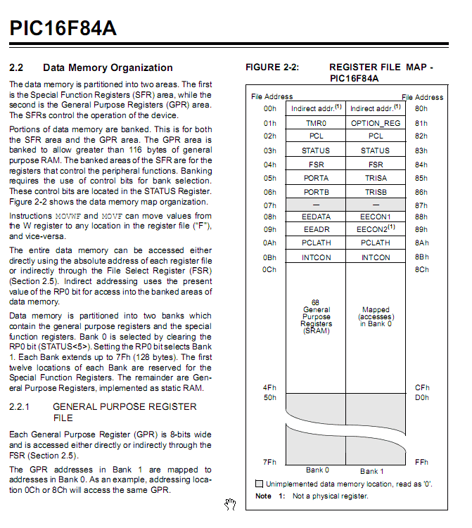

hello guys! Can anyone tell me about the RAM_START codes? What is the operation RAM_START+1 to 4?? RAM_START operation starts at 0x0c? is that correct? :confused: Sorry guys..i'm new at assembly.. Thanks guys!!
; RAM registers
ram_start	EQU 0x0c
dcnt0		EQU ram_start+1 ; delay counter 0
dcnt1		EQU ram_start+2 ; delay counter 1
dcnt2		EQU ram_start+3 ; delay counter 2

I guess a 16F84 PIC.?
Look at this clip from the datasheet, you will see that 0x0c is the start of the user RAM/Register memory block.
what this is doing is defining the ram locations for dcnt0, dcnt1, dcnt2, etc...
RAM_START is 0x0c, therefore, RAM_START+1 is 0x0d... so anytime you use dcnt0, it will use RAM location 0x0d, and 0x0e for dcnt1, etc...
they are floating their declarations instead of using absolutes because if they port this to another micro, that has a RAM that starts at 0x60, then they only have to change one definition, RAM_START, and all the others will be automatically redefined. If he'd used absolutes (dcnt0 = 0x0d) then he'd have to change all his variable declarations as well.

But a far better way is to use Cblock.
