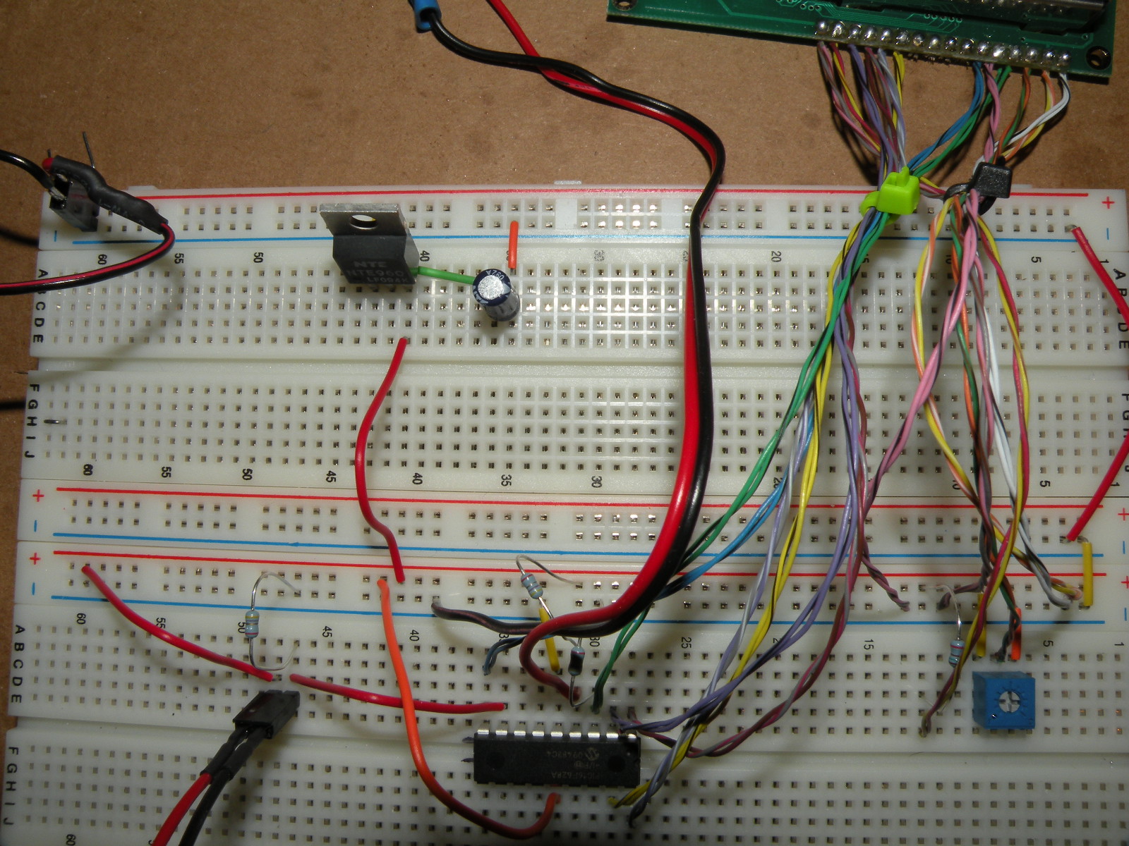

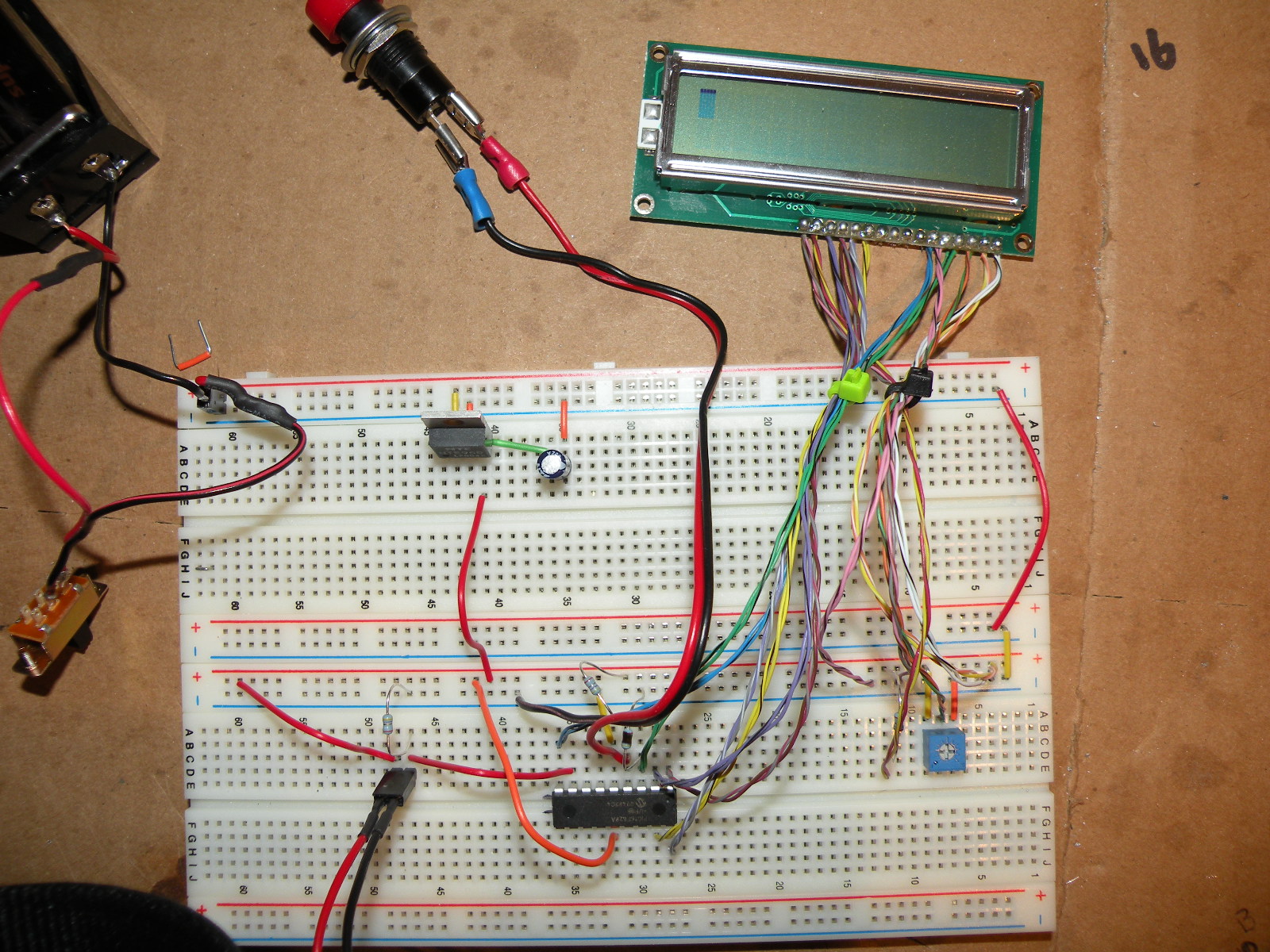

Well I tried your layout tonight ericgibbs. Stripped out the motor circuit and used only what is on your modified schematic. Here's what I got:
Original TACH.hex file: Solid top row, initializes, then single bottom right square blinking. (actual blinking/flashing)
Modified TACH.hex file (tacho2.hex): Solid top row, initializes, then solid top row blinking. (more of a slow pulse than a blink)
dustin1.hex: Solid top row, initializes, then solid top row blinking. (more of a slow pulse than a blink)
Here's the voltages I read:

I've also attached some pictures of the layout on the breadboard. You can see the single top left sqare blinking during one of the hex file tests. I also got some more PICs in today and tried a brand new one along with the one I had. Same result.
I don't know what's going on with this. I read a lot about this stuff and it is all supposed to be really simple. :confused:

I tried the pic element on breadboard again. I felt it, a question of one or other wires not connecting properly in the breadboard.
I suppose that you have used thiner wires as he recovered from some cable.
I too had inconsistency of wires. After I sorted them, it worked nicely. I took two photos one with authors name and second showing the results
Thus it works on original software, only thing you need to do is have a 10 ohms from display contrast pin3 to ground.
why not go ahead with a board, that has the LCD connections in order and wires placed properly, in the artwork.
best of luck in proper setting up

I did notice some of the voltages were fluctuating. So it does appear to be electrical noise causing this? Do my connections seem to be right on the breadboard?
I ordered some .1uF caps yesterday. I should get them today or tomorrow. I will also try some thicker wires for the LCD.
Thanks.
Thanks.
Electrical noise can cause problems on project boards.
You dont need thick wires to the LCD data pins, the signal currents are minute.
The twisted pairs are not required.
Thick wires I meant to suite breadboard wiring, not to cause loose connections due to loose grip inside the bread board.
I find that solid PVC insulated wire fits perfectly well in project boards, twisted multi stranded wire is unnecessary and prone to shorting.
This project does not require thicker wire for connecting the data/control lines of the LCD.
Thanks, we generally use colored single strand 22swg wires for breadboard connections
Thats exactly what I use, stripped down solid strand 'old' telephone cable is ideal.
I would never use multi stranded wire as Dustin has used, especially using two wires twisted together.

So what are you guys suggesting I try to get this working? Is my layout ok, if not what is wrong with it? Should I not be using a breadboard?
I'm stopping by the store to get some 22 gauge stranded wire to replace the wire on the lcd and some 24 gauge bus wire for when I make my proto board. Also picking up some .1uF caps to put in between +5v and ground on the chip.

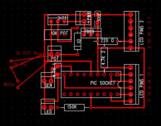

I would use the pcb for the project, the layout looks correct.
I am assuming from your pcb image that the copper track is on the other face of the board and that we are looking thru the board to the track.???
Correct, this is the component side. Well I had this setup laid out on a pcb and all I got what a steady solid top row on the LCD.
hi Dustin,
I have just relooked at the pcb layout and the PIC/LCD tracks look ok.
I would add that 100nF across the PIC +V/0V pins, close to the PIC.
Use the Dustins.hex LCD file to program the PIC.
