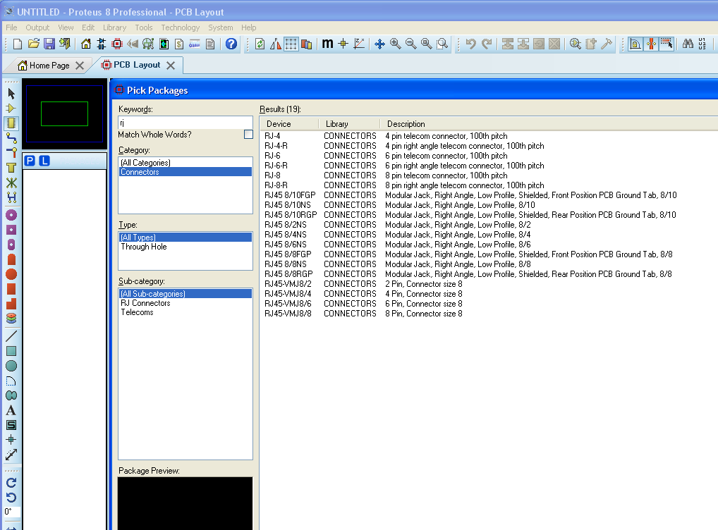

Not renamed.... The RJ11 is the telephone socket... The RJ45 is the Ethernet socket... They are listed as RJ45 and just RJ
RJ 4 and RJ 6 are the ones I use.... The normal one is the 6 pin... Are you using the path "package/connectors/RJ 6"

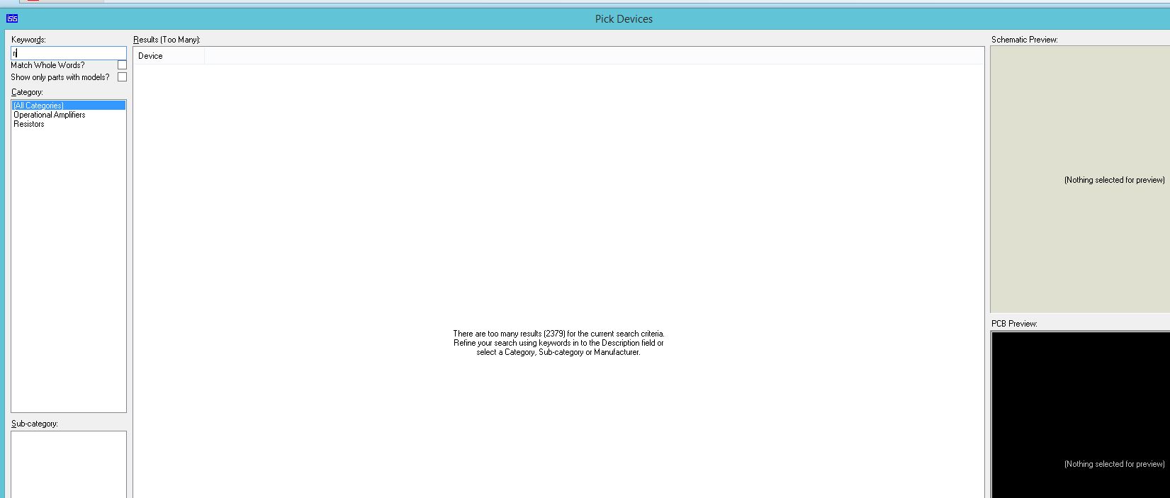

I have the sockets thought I need to go count the pins but I am pretty sure there is 8 offset. This is what I get for rj in proteus, I only have one lib
As you can see if I click on connectors it goes to opamps etc as I dont have ANY connectors with RJ at the start.

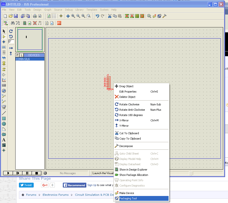

That's Isis .... PCB layout is Ares... In Isis you can assign a package to any 6 pin connector...

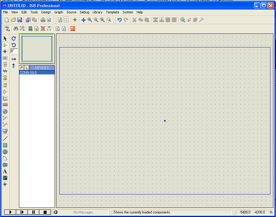

Select 6 pin sil

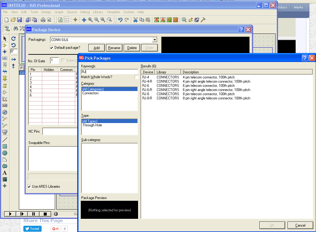

then select the properties if the connector. Then "Packaging tool"
This opens ares.. Then look for RJ

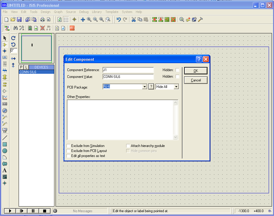

Lastly once back in Isis, select the component properties then package and select the RJ connector..
