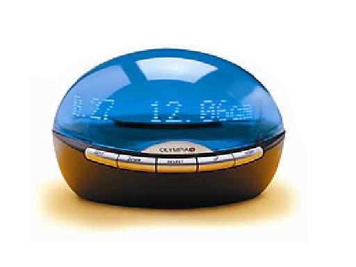

I saw this the other day at RADIO Shack..
it is called info globe
it scrolls up & down , and sideways.. very cool. 8)
EDIT: oh it spins real fast.., but it must have some sort of brushes inside b/C the only thing that is spinning is the LED's..
Cool, I had seen spictures but I figured a display on the base reflected off the curved dome somehow. Didn't realise it was a spinning display.
