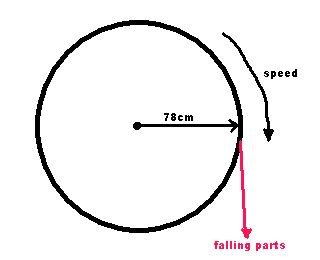

I did 2 in last year, one from a small fan and the second from a car radiator fan motor, the led's was 78cm from the shaft.
Be careful make sure mount every parts very carefully, check the balancing.
My last propeller clock was a disaster, I user a coil and magnet to transfer power to the board, like the generators.
The magnet seats on under the board mounted to the motor and the coil pas over as it rotate.
For some reason one of the capacitor aluminium can fall of the capacitor ! and smash in to my Laptop LCD, left a hole behind !!!
Good think not landed in my eyes!!
If you make something with large diameter count on the speed on the tip of your board, in high RPM, like 2000 RPM the speed on the outer part of your board where your led's mount may have 10's or 100km/h sped !!!
Good luck with your project.
STEVE
