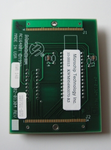

I'm looking for the module AC164001 or AV164002 that fits the Microchip Pro Mate II. Since I haven't been able to source one I was wondering if somebody on this forum owns one of those modules and can perhaps take a picture of the PCB so that I can make my own adapter.

I managed to trace down a photo on the internet off 1 side of the pcb of the module (for pic16c5x/AC164001) but the picture isn't very clear.

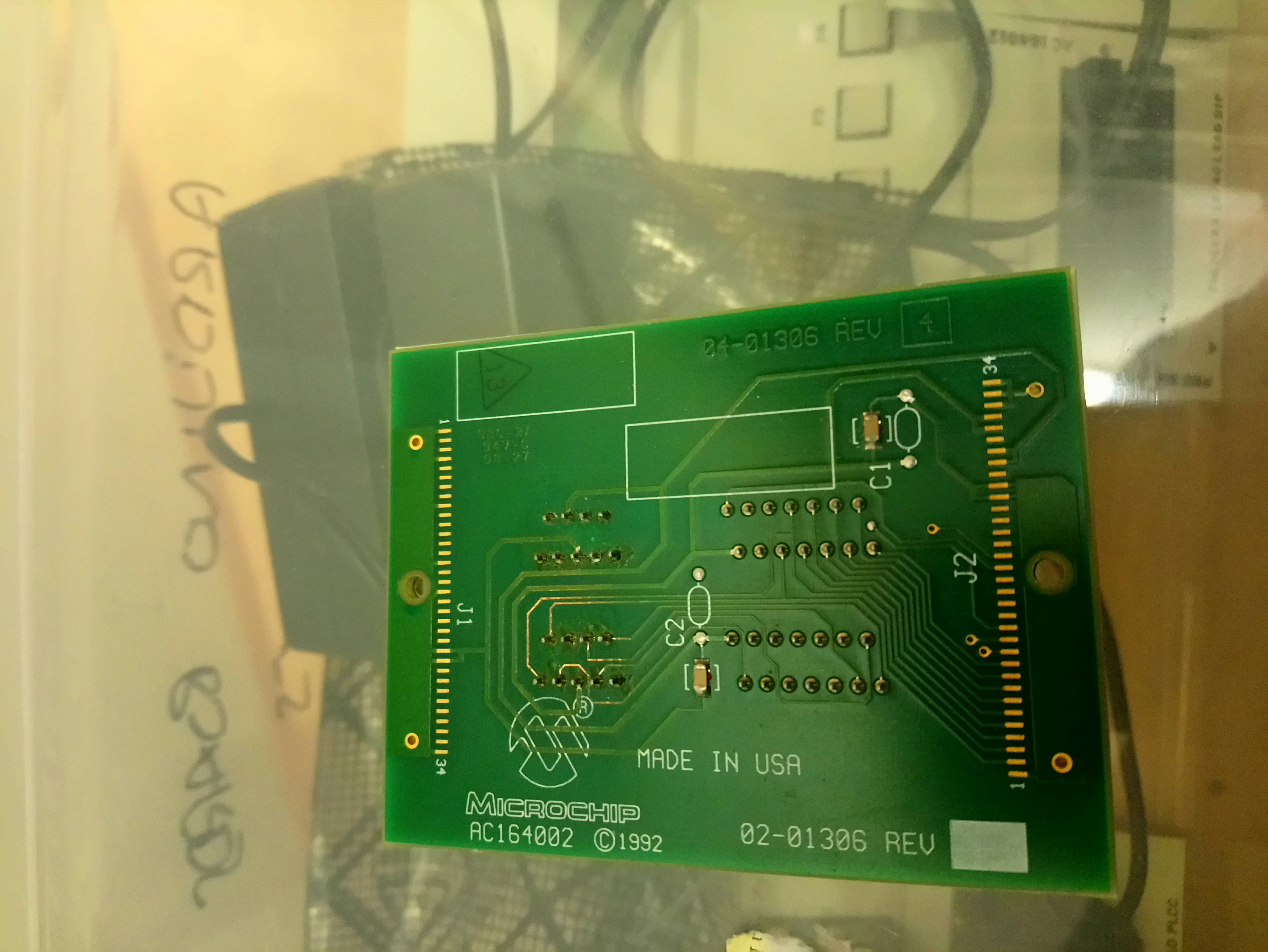

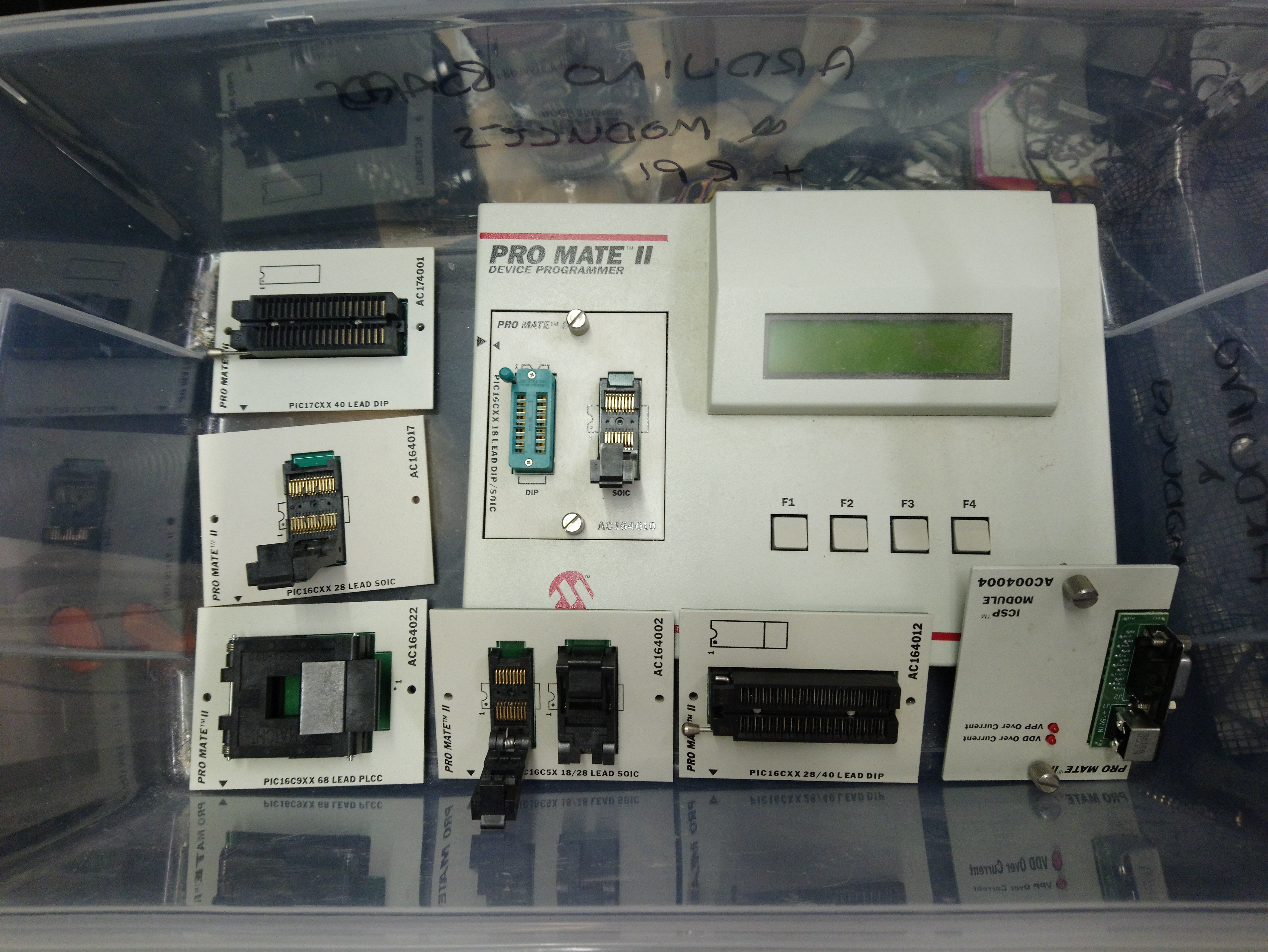

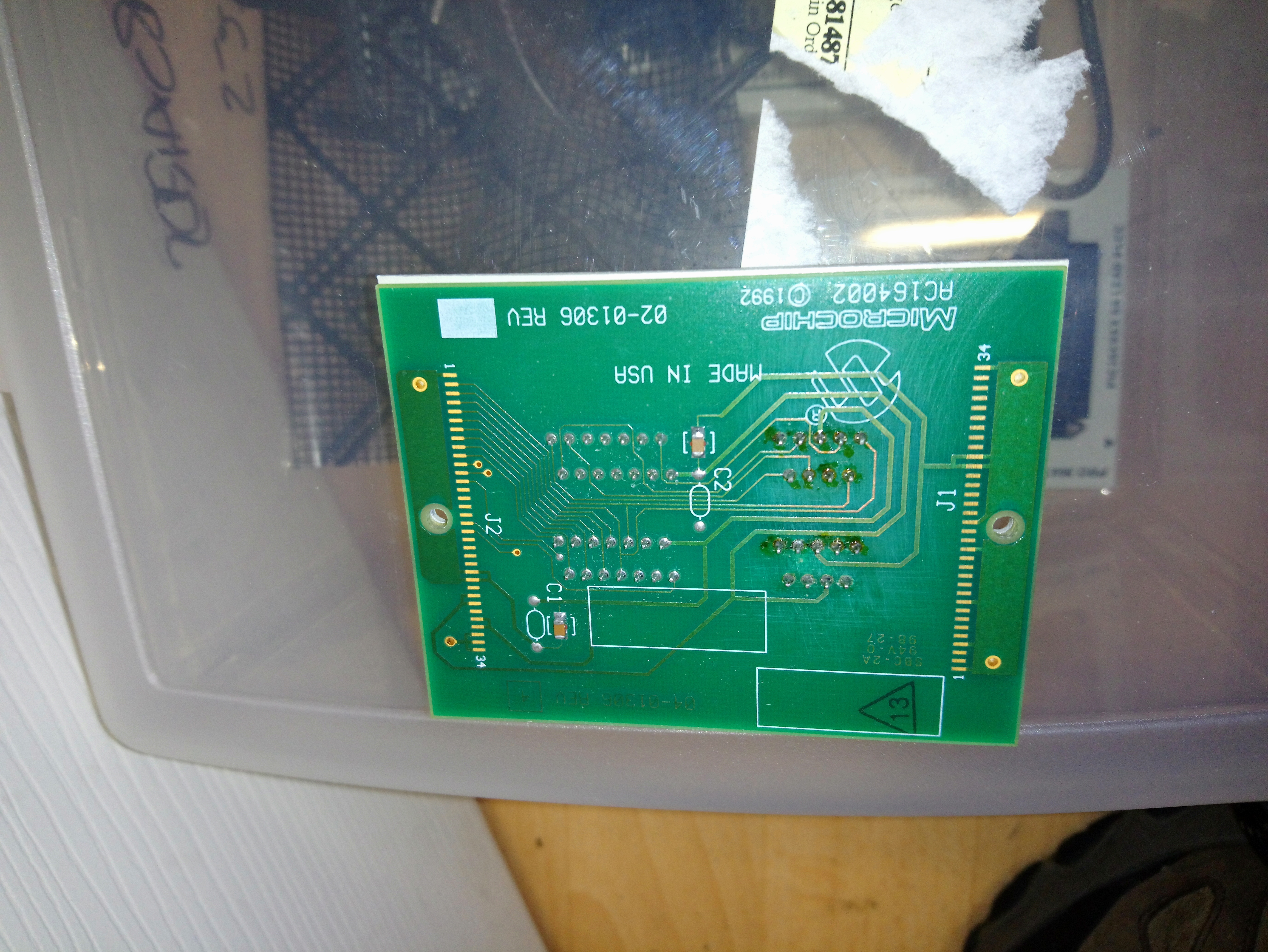

I have the following modules :
