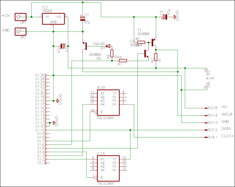

Schematic
Fig. 1 - Schematic of the PIC Programmer

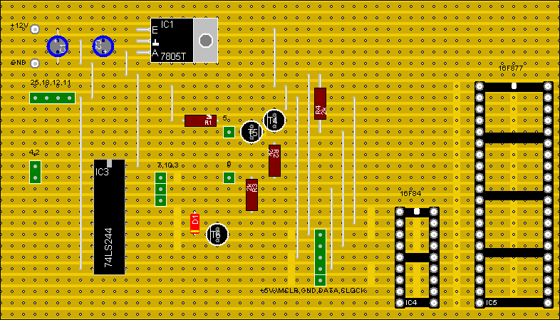

Template for paper tape board
Fig. 2 - Component side of the PIC programmer
Fig. 3 - Soldering side of the PIC programmer

The circuit which is presented here is based on the circuit presented in the Microchip Application Note 589 (AN589). This programmer is compatible with every software supporting AN589 programmers.
The programmer is connected to your PC with an usual parallel printer cable. I use the software PBrenner under Windows 98. Please note that in some notebooks, only cheap hardware is used, so you could get into trouble running the programmer with such hardware.
A H signal on D4 turns Q2 on, resulting in /MCLR going low (the PIC is reset). The reset condition is ended by setting D3 to H and D4 to L (Q2 is off, T1 and Q1 are on). A simultanous reset and programming mode are prevented by connecting the emitter of Q1 to D4. For correct working, it's sufficient to connect the programmer to 12 V. Data and clock signal are connected to D0 and D1. The data which is read is available on ACK. BUSY and PE are connected to ground.
The IC1 buffer is activated during programming by D2 and D5. During reading, D2 is set to L.
The resistors are needed to create the necessary logic levels.
You can use the 5 pin connector to program a PIC in its target circuit. This is called ICSP (In Circuit Serial Programming).

schematic
eblc1388 said:
AN-589 is supported by Ic-prog, the PIC programming software which has quite a large user base.
open these attachments.
