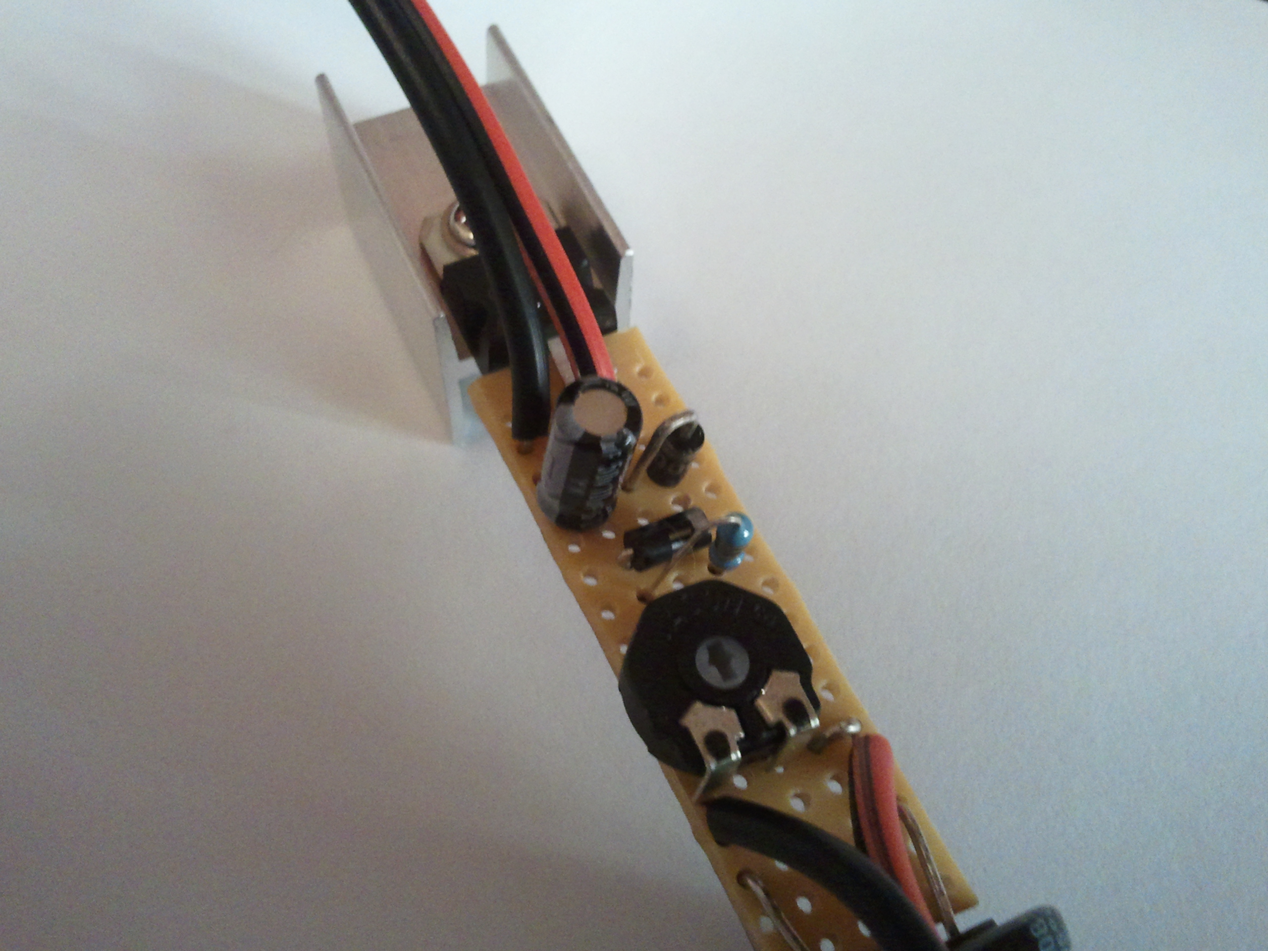

I built the LM317T example regulator here, page 7, bottom right.

My input is switched clean 24v DC.
My problem is R1 gets damn hot when the pot is turned to closing on 0. Also, with a multimeter attached to the vout, I'm getting 23.5v +-, even when adjusting the pots very slowly.
Here is a pic of my project, there is no track breaking.
I must be doing something wrong?
anyone got any ideas what could be wrong? my only alternative is to hook up the regulator + pot + resistor in the simplest config and try like that
You have a diode in backwards between Vin and Vout.
It should go between Vout and Adjust.

Oh ... the bottom left leg of the pot in the pic I took of me holding it is cut off above the board, just incase anyone thinks its connected :)
You should have a safety resistor in series with the pot, when you bring it down near 0, the current gets very high, that's why it's heating up.

The multisim is fine; it is your wiring on the stripboard that is all screwed up. I make one end of R1 tied to Vin; not Vout.

Pins as far as I read from left to right are Vadj, Vin, Vout .... R1 is tied between Vadj and Vout.
I'm posting another pic from the side where you can see where the pins are going more clearly.
Here is a pic from another angle to see where the legs are connected

R1 has 1.25V across it. Then if it is 240 ohms (used with a more expensive LM117) then the current in R1 and R2 is 1.25V/240 ohms= 5.2mA.
If R1 is 120 ohms for an LM317 then the current is 10.4mA. The current is actually slightly higher because the current from the ADJ pin is 50uA to 100uA and is also in R2.
I agree that one of your diodes is connected backwards.

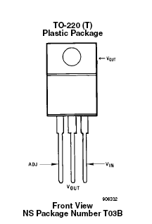

Not on my LM317T:

Yes its your pins on the reg that is screwed up.
Input is on the outside and output is the centre leg.
Pete.
